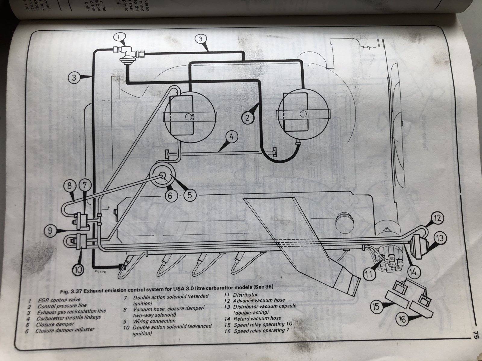

I’ve been noticing a lot of other fellows don’t have the emission controls in there engine bay anymore and I’d like to delete if can be bacuse i feel its effecting my performance.
From the diagram I provided below i feel i can just delete the #10 advance solenoid and #7 retard solenoid and have vacuum directly hooked to the carburetor to distributor. Then i can also delete #15 #16 #6 and #5
after i feel i can just delete the whole EGR system and plug where necessary.
has anybody else done this and is it a good idea?

Yes you can delete everything and cap the exhaust egr port in the rear exhaust manifold and cap everything else off at the carbs and manifolds. Do not use vacuum retard, only vacuum advance.

right so I’d cap off vacuum retard for the distributor and only keep advance?

Yes, make sure the advance is connected to the vaccum source at the carb which is above the level of the throttle plate ("ported vacuum"), not below it ("manifold vacuum").

Do you have wires connected to solenoids 7 and 10? If not they aren’t active anyway. And 5 runs off of retard and only slows throttle closing so it doesn’t affect performance.

Yeah the electrical is still all hooked up. I haven’t done a test to see if the solenoids still actuate. I’d rather just get rid of it all if it’s not really needed. This was all for the American emission control market right.
There are several posts and an experiment by Dick Steinkamp showing the benefits of running vacuum off the manifold (cooler, no more stumbling, needed to turn down the throttle).
https://e9coupe.com/forum/threads/m30-vacuum-advance-retard.36076/ . Caveat: running Weber 32/36s though maybe true for Zeniths too. Shrug.

Yes I've experimented with running my advance on manifold vacuum. If you want full advance at idle you can, and it will make it idle higher (and theoretically cooler) than without. Once you press the accelerator the vacuum will drop off as will the corresponding advance. At cruise where the fuel economy from advance comes into play, both ported and advanced will be the same. So if your engine doesn't hesitate off-idle from the sudden drop in advance then it's fine to do so. The vacuum advance will be higher at idle than the cruise advance. Too much advance at idle will cause problems.
