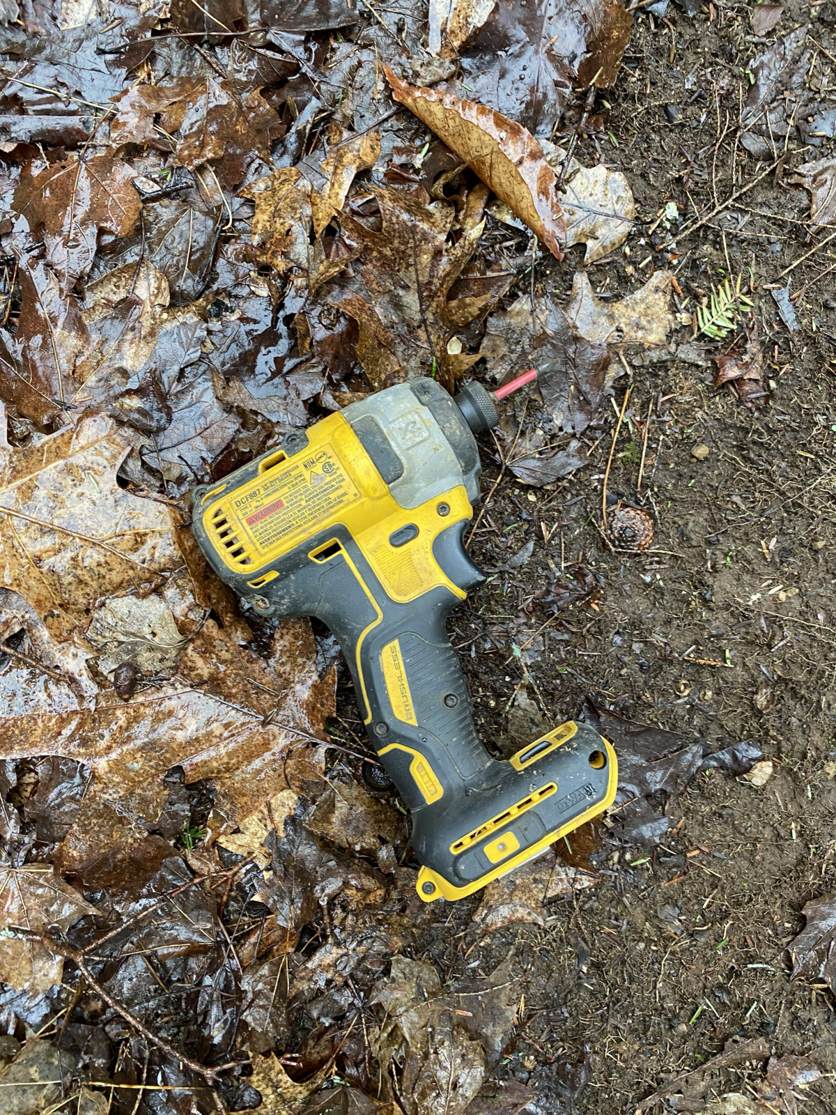

Last fall while closing up the island I spend my falls on, I left my Dewalt 20 Volt impact driver on the ground, It was left at the bottom of a hill, and would have been covered in snow from the end of November till mid April. Where it was found also would have been in line to be in a stream with the runoff from the hill. Add the heavy rains we get in the Spring and that tool has seen some abuse.
Found it yesterday after wondering if someone had stolen it from my urban place. Pushed the battery indicator and it was completely dead. (Lithium battery). Put a good battery in and it works. Bit of dust came out of the vents, a bit of sparking, and it doesn't quite sound fresh.
Get the feeling it's longevity has been compromised, but still quite impressed with Dewalt engineering. If I take it apart, assuming it is serviceable, would I lube a lot of components or just clean them with ?? I figure E9 folks who diagnose faults in coffee maker design might have some ideas about keeping this survivor working long term.

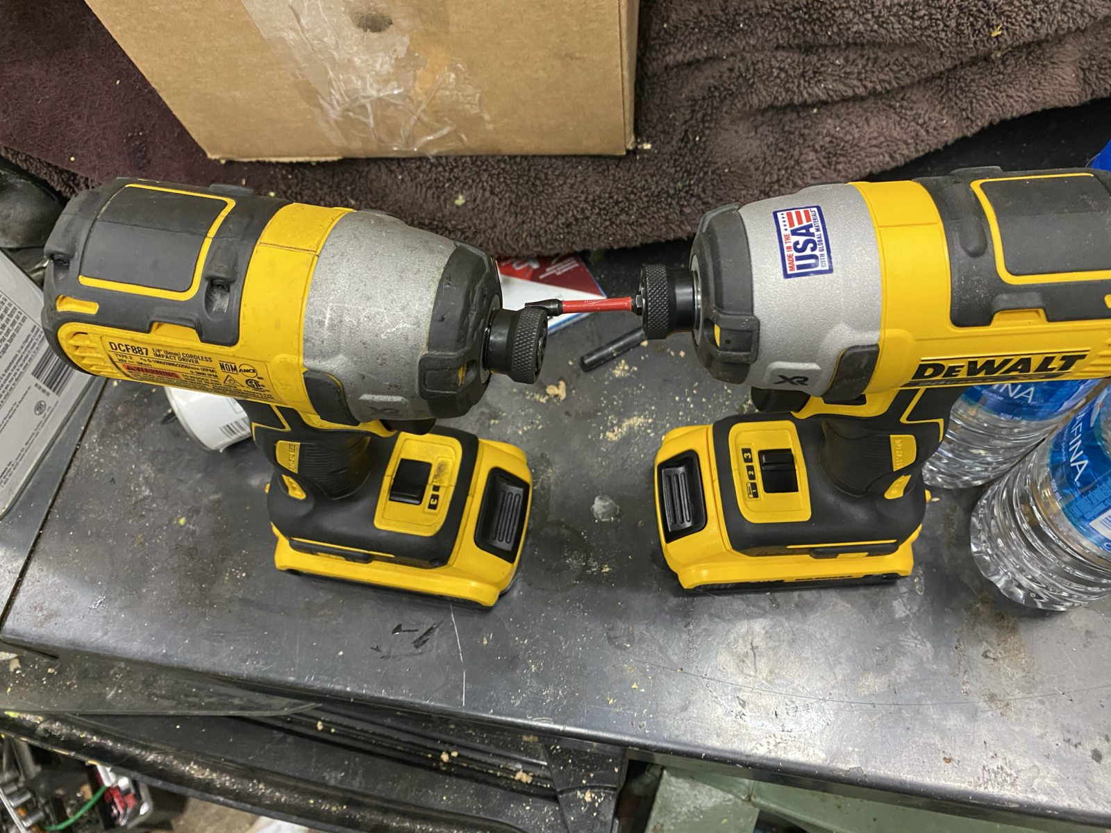

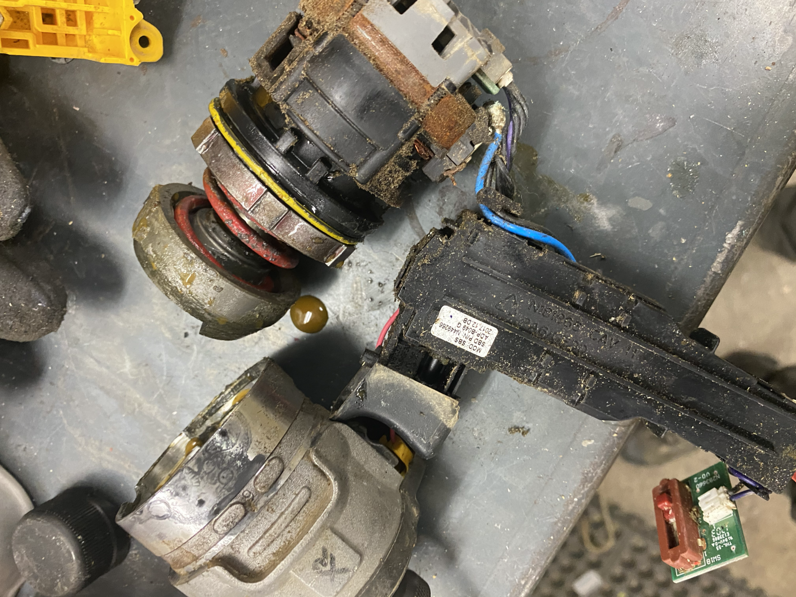

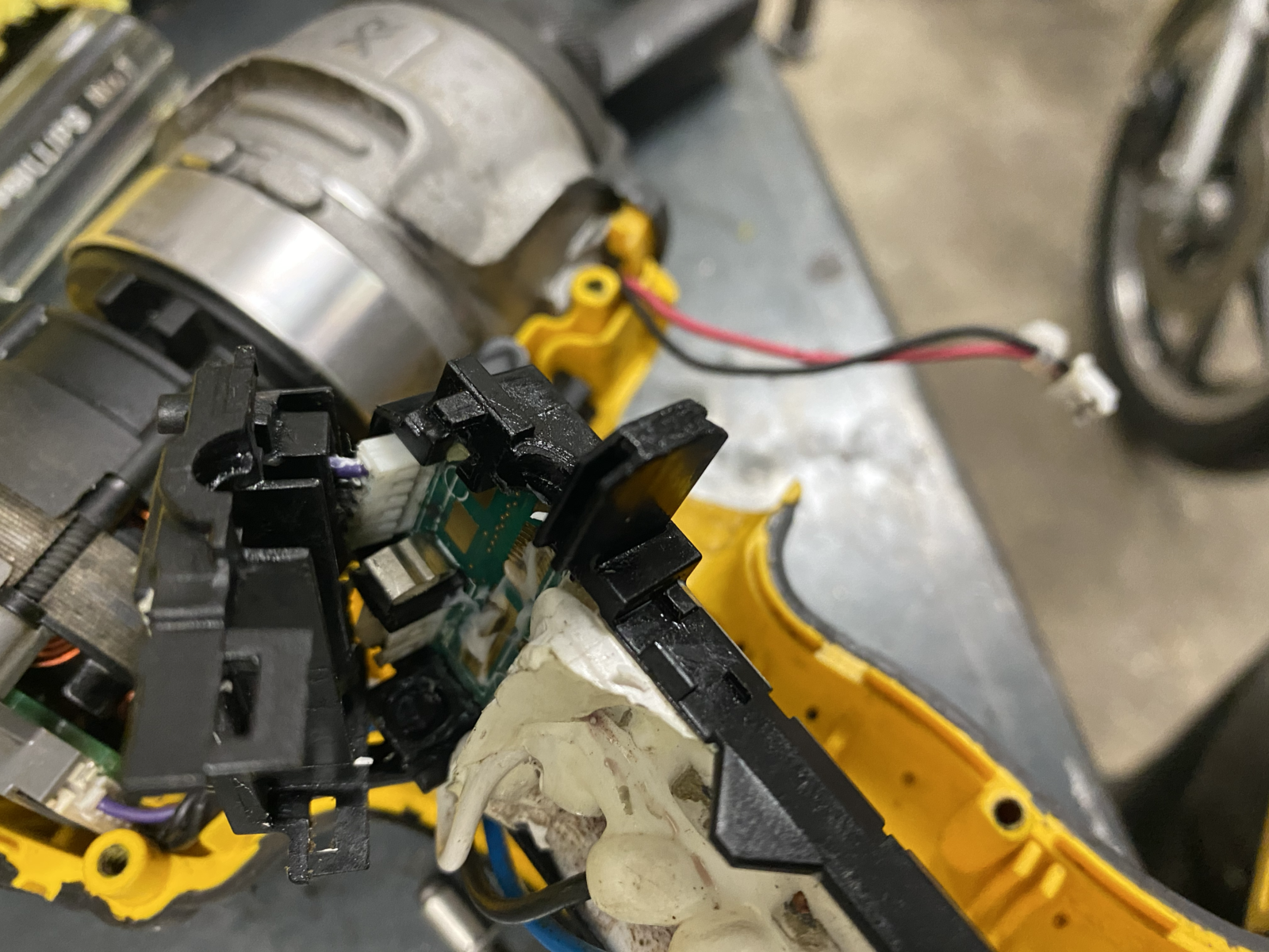

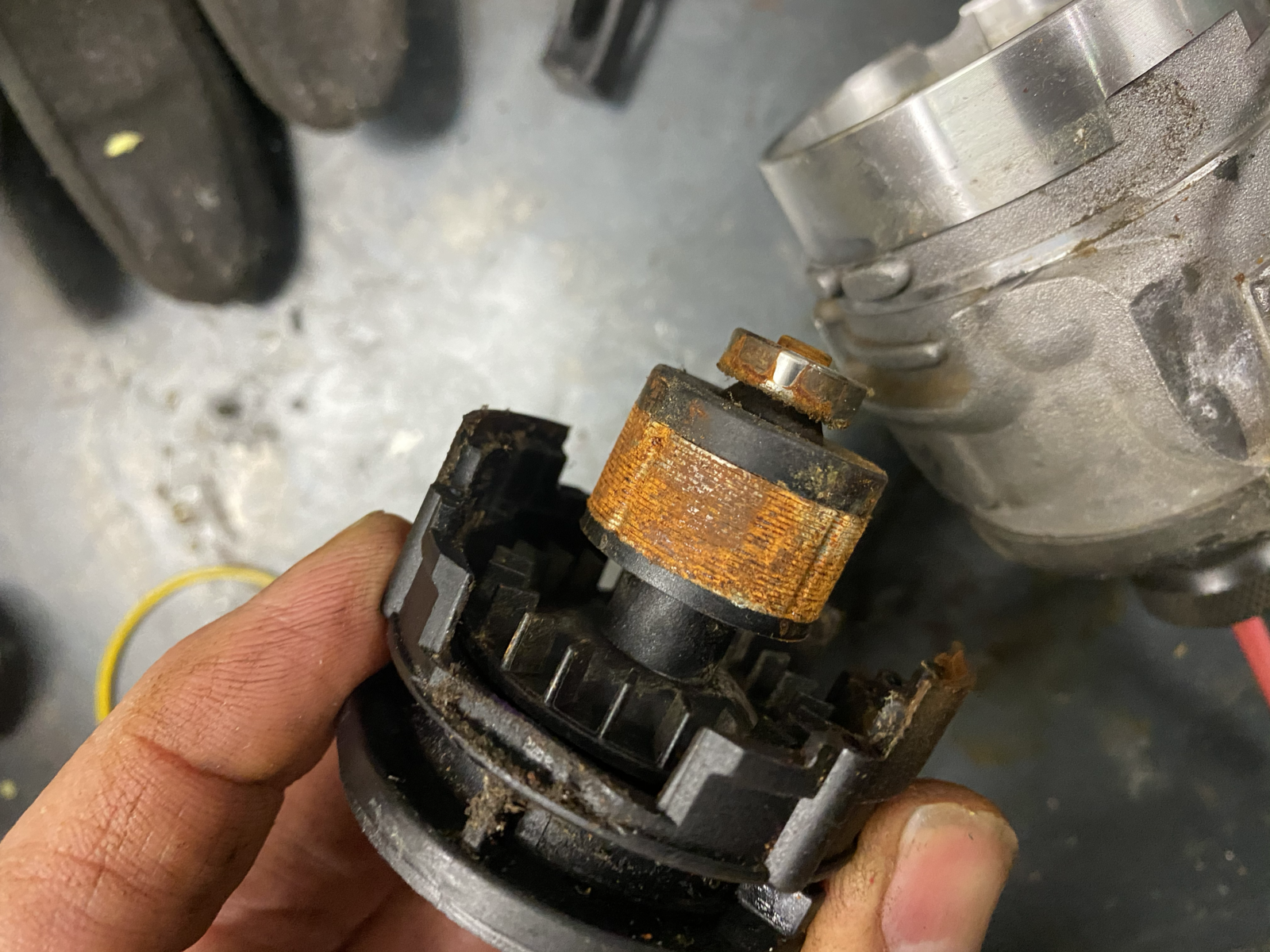

To save the $100 replacement cost, I put several hours into this impact driver. I enjoyed it's resuscitation and scratched my head more than once getting it to run reliably.
Nicely built inside. All the steel parts were rusted of course . Soaked the coils in Evaporust and the speed control switch as well.. Wire brushed the core (Armature?) . This one is a brushless motor. Has quite impressive torque. Cleaned out the soggy grease from the drive components and the main bearing was completely sealed and still spun perfectly. I used silicon grease to put it back together and sprayed connections with ACF50 ....and it worked...but then it didn't.
Took it apart again trying to figure out why it would run sometimes and then stop or if I twisted the battery....or when it wanted to.
This afternoon before almost pulling the trigger on Amazon for a new one, I opened it up again and pried the trigger mechanism apart and cleaned the contact area of greasy, watery sludge then put silicon grease in there. Now it runs very nicely. It sounds smoother than the brand new City one I keep at home. Going to put a date mark on this one and see which one lasts the longest. It has been used extensively for the last 4 years bolting and unbolting all kinds of wood projects and a very large deck...Thousands of screws. It would probably be pretty good for taking cars apart too if you didn't need an impact gun. Made in the USA (With parts from unknown origin). Thumbs up Dewalt!
