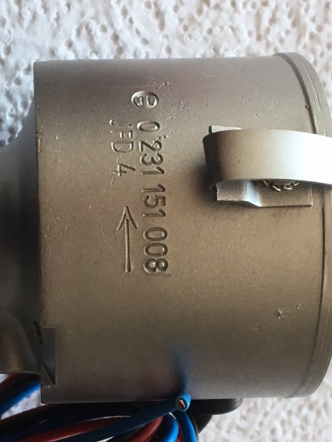

Any use to you? Looks to be working. Sucked on the line and it retracted the arm.

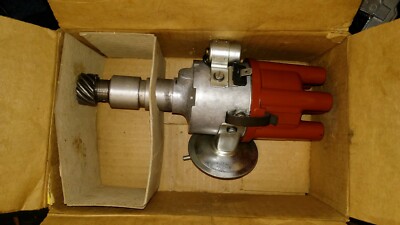

I think I have a NOS cam dizzy drive in my parts stash, I might look to fit that along with any new/refurbed dizzy

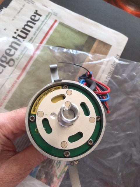

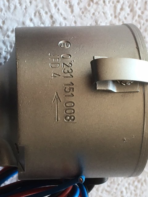

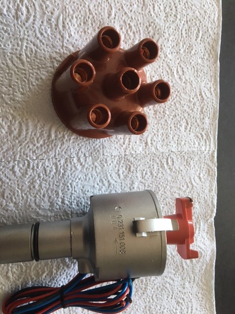

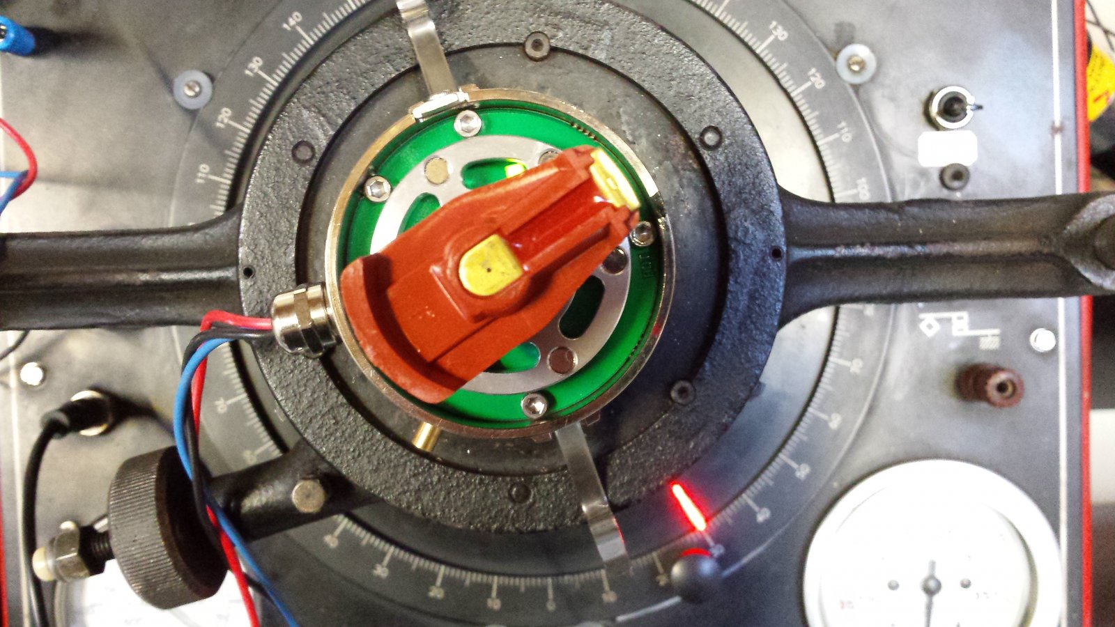

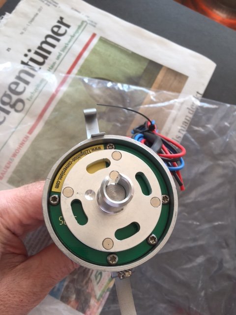

A nice option to consider is to send your distributor body to 123ignition, and they will install their Bluetooth version in your distributor body. They clean it up and replace the bushings, so you get back a nicely rebuilt distributor with modern, programmable internals.
Here's how my Tii distributor turned out (they sent a 6-point cap by mistake, but sent a 4-point cap as a replacement):
123 plate.jpg123 positie ccw[3791].jpg123ignition T Duffy 6 cylinder cap.JPG123ignition T Duffy JFD 4.JPG
