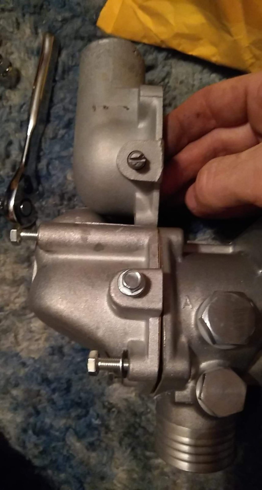

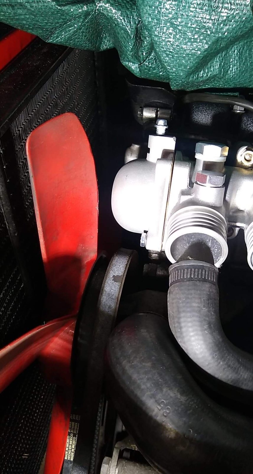

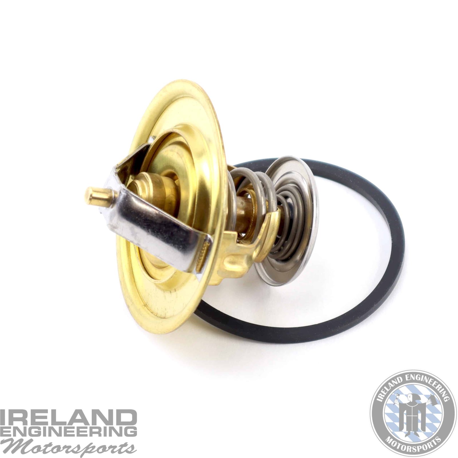

I recently replaced the thermostat housing with a unit from Ireland Engineering after mine was damaged upon removal. The unit is a newer style with a larger t-stat cover that necessitated me swapping to my original (see pictures). In the process I also replaced the t-stat with an OEM example. Not surprisingly, I am having overheating issues. It will rise to just before the red while at a standstill and will decrease to just above the first hash at highway speeds, seemingly once the t-stat opens. I have bled the system sufficiently (I believe), but understand it could be an issue related to newer t-stats with the older cover? Any help would be appreciated.

I'm unsure how to match t-stat to housing. It installed without issue and the images here on the site from a past post are dead. I have the t-stat pointed like the image below towards the front of the car.

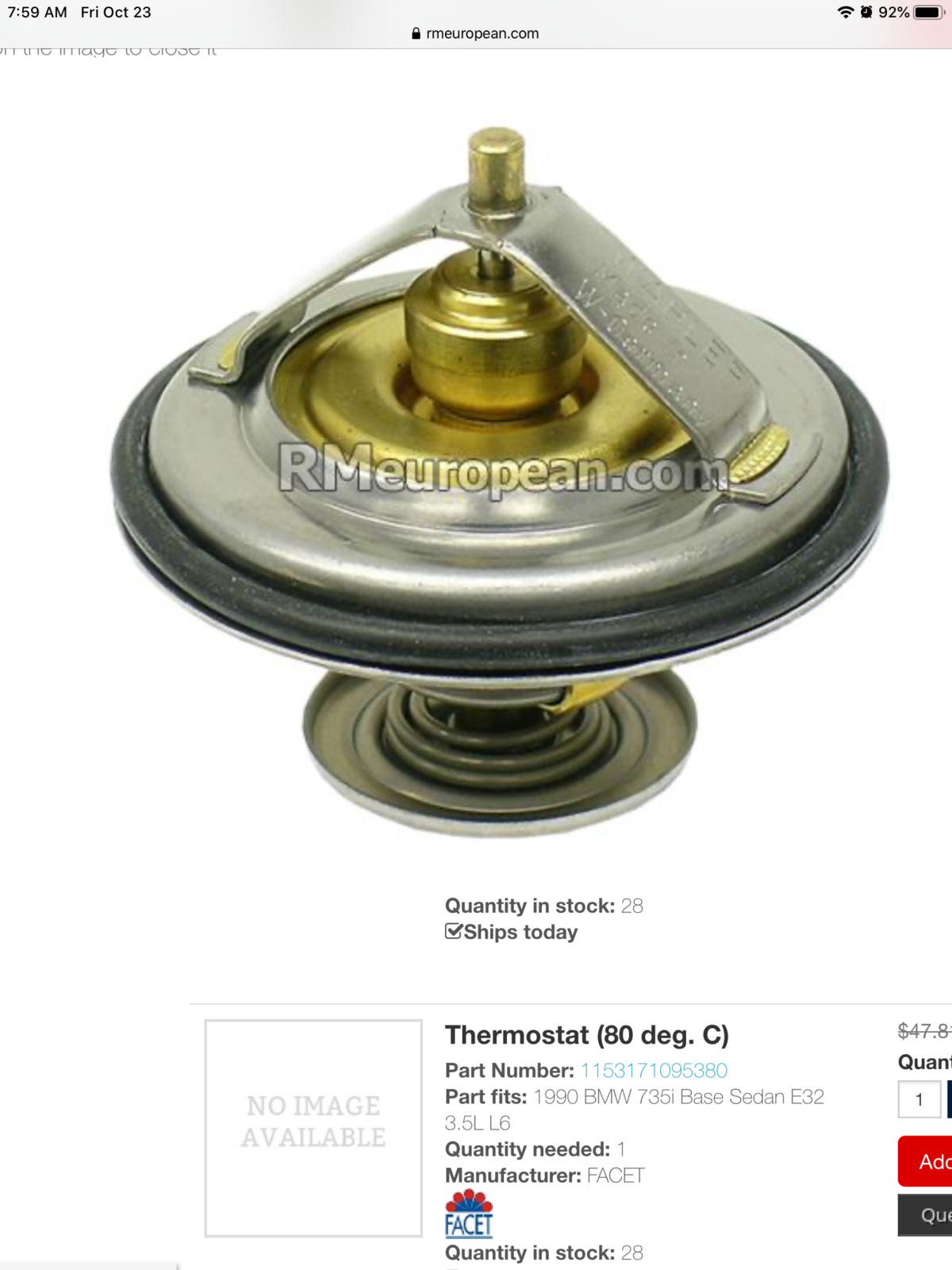

Quit before you ruin your engine.
you have an early thermostat in a later thermostat housing.
you need the later 1990 thermostat
note the “A” on your new housing- it’s there as your warning not to do what you are doing.

The cover is meaningless
October 1985 the housing and thermostat were changed.
use the Later thermostat with the later housing.
the early thermostat is too long.

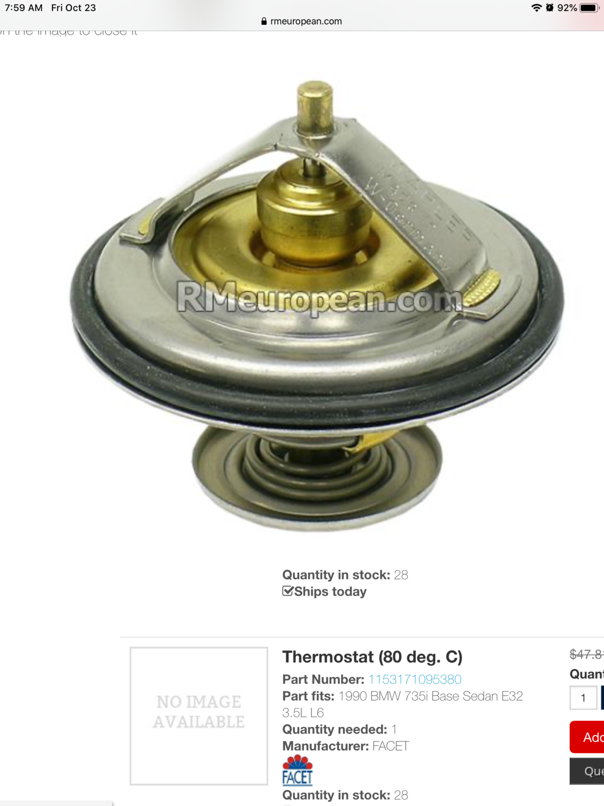

I believe I just posted a picture with Correct part Number- are you on a Mobil device that doesn’t show it?
sfdon
8,236
4,583
sfbay area
I’m driving in to shop now- can’t text.
check out my last post and order that thermostat
it is correct

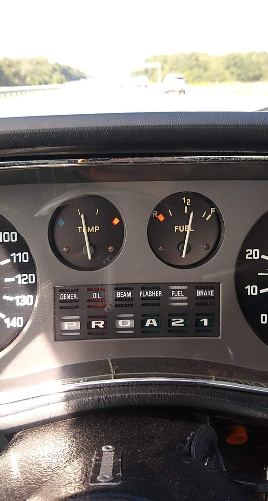

Here's what is interesting. When I bleed the system once more and refill the coolant the temperature will remain around a third. Seemingly where it should be. If I park the car overnight and drive it the following day after work it will begin overheating. If I again bleed the system and refill the coolant the car will run where it should be, around a third. I even tried getting on it as much as possible in an attempt to raise the engine temperature. It always remained slightly below a third or slightly above.

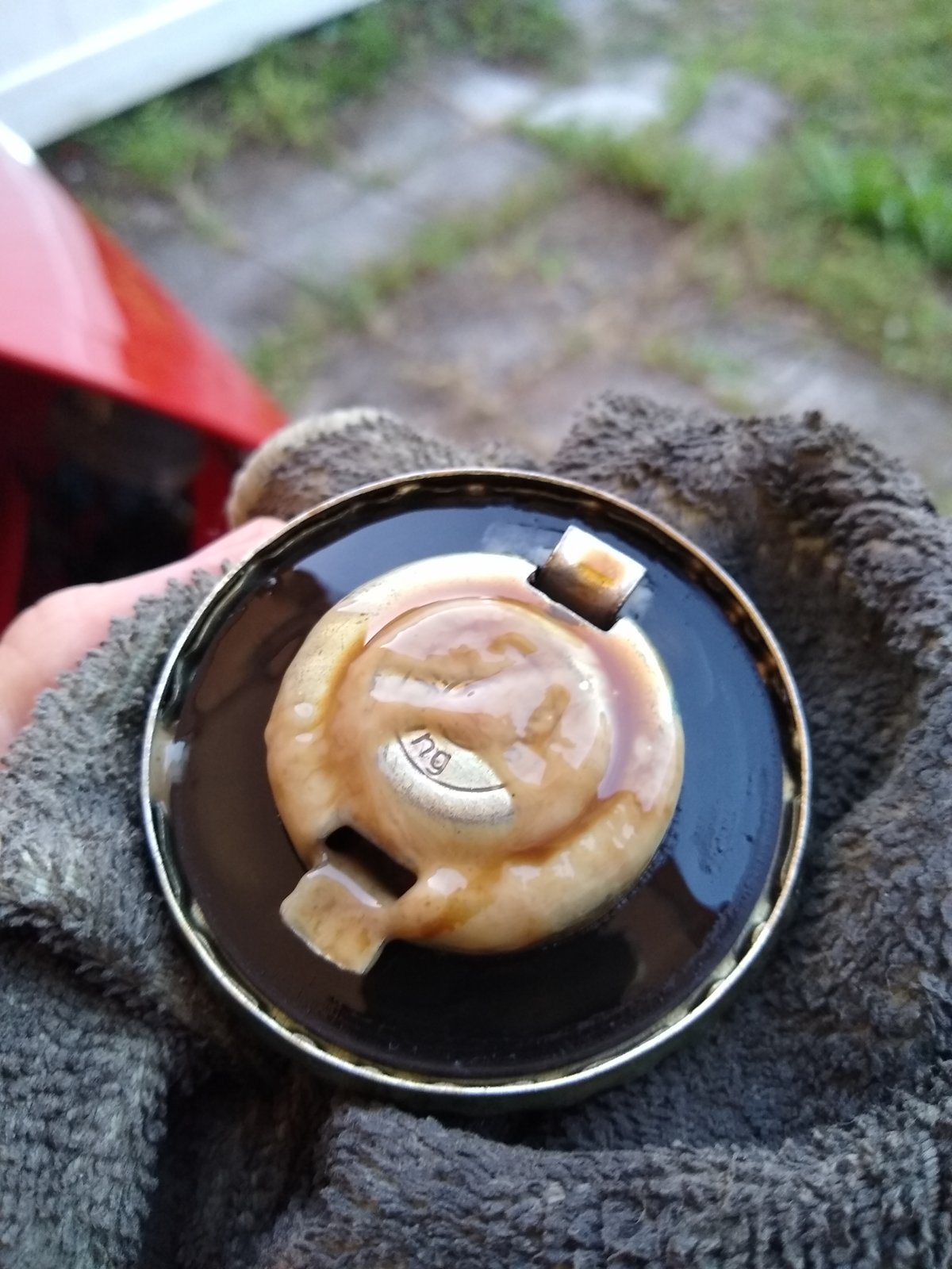

My greatest fear is of course a head gasket or cracked head. The car doesn't seem to be performing any poorer than previously and I do not notice coolant in the oil. I am getting what seems a bit of moisture in the valve cover that shows up on the underside of the oil cap. Is that common or an indication of a larger problem?

That's exactly what my 2002 radiator cap looked like when I blew my head gasket. It will still run ok for just a little bit, wouldn't recommend driving anymore until you take it to a shop and have it looked at. I'm no mechanic, but that milk chocolate look is usually a bad head gasket, so I am told. Water mixing with the oil and getting hot.

I agree, that cap does not look good.
A friend, owner of an E9, said it is normal. *shrugs shoulders*

What you pictured is an oil cap. If it was a radiator cap I'd be VERY worried. If you are sure you are not getting water in the oil, that could be condensation especially if it has been started many times and not allowed to warm up. Change the oil. If it comes out looking like thick chocolate milk, you're in trouble. If it looks fairly normal you're OK.

Thanks for the reply, Dick. Yes, I think there was some confusion in regards to whether or not that was the oil cap or the radiator cap. It is definitely the oil cap.
The interesting thing is that I have repeated the purge and top off procedures several times only to find that the subsequent day it begins overheating again and acts as though there is more air in the system. Once I purge it again and add more coolant it seems to perform normally. It did this both yesterday and today. I just returned from going outside and starting the car for a bit to let it idle. It idled for 15 minutes or so and remained around one-third. Hoping it stays this way when I get home from work tomorrow.
