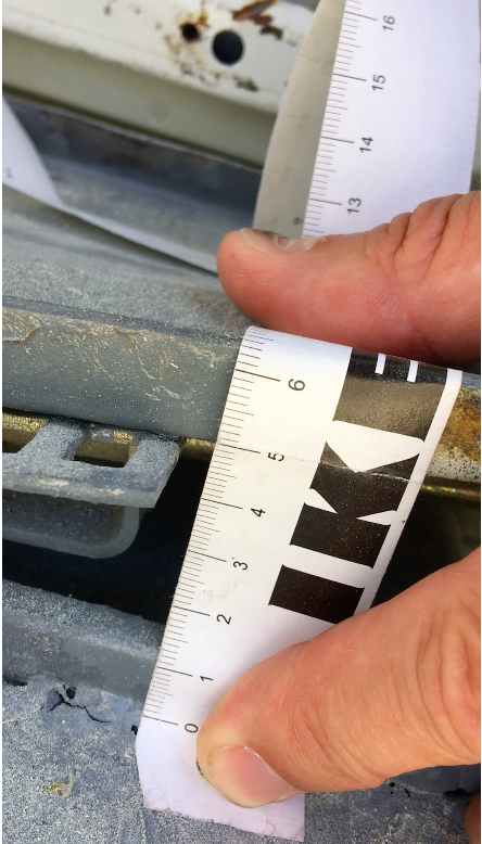

The seat framing area on the e9 is very strange. First, as Erik mentioned, the rails are pitched backwards. Second, the floor is raised right under the seats. I am guessing this was done to add structural rigidity. Anyway, the available height is 5.5 cm at the rear and 6.3 at the front.
(EDIT Ooops. Sorry, I misread your question. I thought you were talking about the height of the seat framing.)
