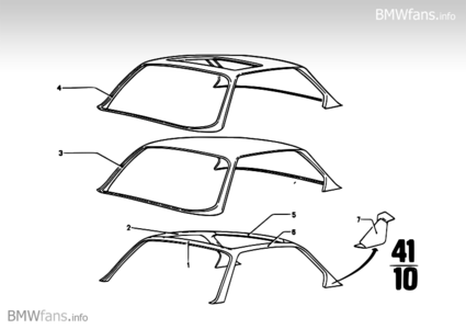

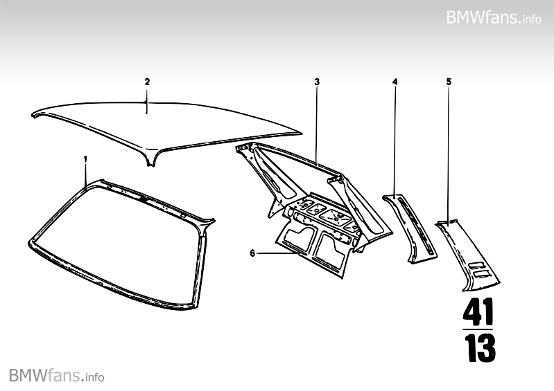

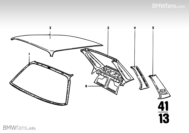

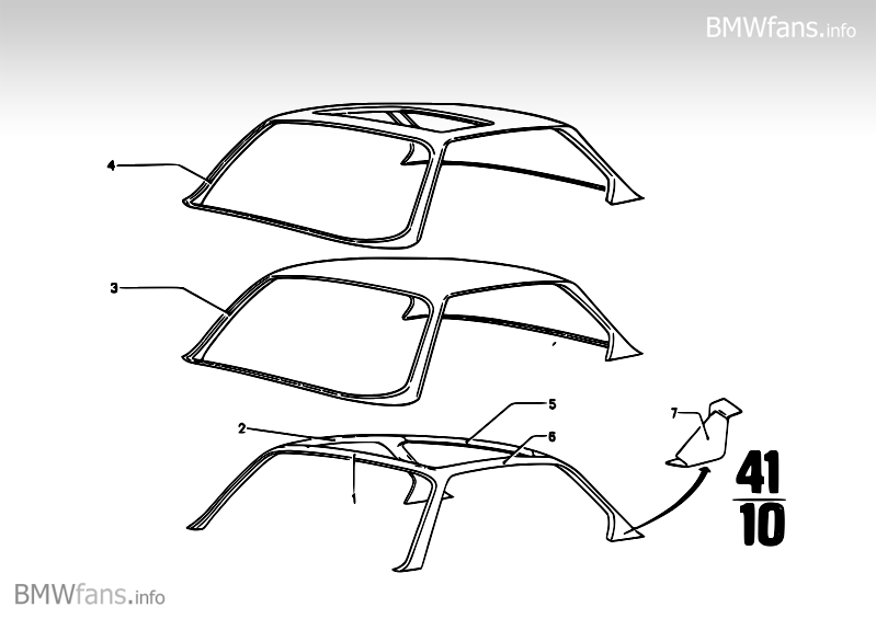

Is it the lead used by Karmann to straighten the bodywork? :p
Seriously, I can account for some but 200 lbs? The E3 and E9 were built in entirely different factories. Could it be heavier gauge steel involved in its production?
The rear window systems are indeed heavy.
The wood trim over the doors and sides is very heavy, being mostly steel.
The A pillars are very beefy on an E9, they extend further out of the body too. 2x5? lbs
E9 has an extra reinforcement into each of the rockers. 2x6 lbs.
Extra rocker covers, 2x5lbs
Strong B-pillar construction, 2x3 lbs?
Roof, 10 lbs?
E9 gutters that are notorious for rusting out, the E3 does not have them, and that area was also reinforced (before it too rusted away again). 2x5? lbs
The front wings are a big one, 15 lbs on the E9 vs. 3.3 on the E3. Another 23 lbs.
Trim and bumpers may add some too. Still not there, not even counting items on the E3 that the E9 doesn't have yet. Quite a bit of the weight is in the front, noticeable in the dynamics of the E9.
