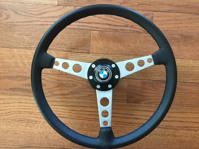

Is it me, or is the leather re-wrap a little... unoriginal? @Keshav, @Markos I am no expert, but it does't look as I'd expect.
Neither are original. The only Petri (that looks like this) that came in leather was the CSL 38. It doesn’t look anything like either of these wheels. Both are overpriced.

The first of the 2 Petri’s, the one for 1800$ is a standard foam wheel with the V shaped overlaps (referred to as VW wheels) with a mediocre aftermarket leather wrap, an adapted hub and odd Petri horn button whereas the one for 3500$ (reduced from 5000$) is a standard foam wheel with square shaped overlaps (referred to as BMW wheels) and 02 hub, supposedly NOS.
The foam texture and the fake stitching is often mistaken for leather.
An original Csl leather wheel looks like...

Thanks. Frustrating. I try to learn from you wheel addicts’ posts, but then assumed I’d misunderstood when I saw these. I’m not in the market now, but I’m now totally skittish of wheels in the secondary marketplaces & will have to annoy you before buying. Apologies in advance. I’ve had some better-than-I-deserved experiences on risky CL part buys lately, but I’m not pushing my luck on steering wheels.

Happy to help. BTW - When I said “not original” I meant “not original leather”. The wheels themselves look legit, albeit heavily overpriced.

The $1,800 Petri has a converted VW hub and hub cover. The VW fitment has been removed and BMW fitment has been mounted. The horn button seems to have a later emblem, which doesn't work very well, it sticks out. The spokes look painted indeed, the stamps are almost invisible because of the paint.
