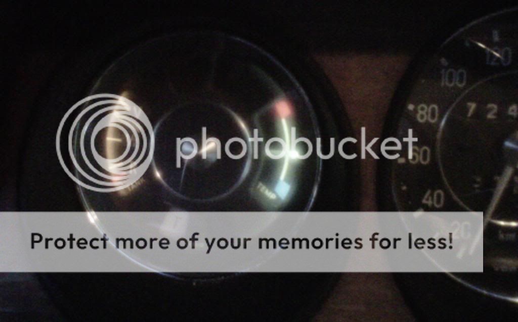

here is a comparison of three lights,
fuel level is a conventional bulb 4 watt
temp gauge is a LED 1 watt
speedo is fitted with old 2watt ones
IMHO, LED light is very blueish, too much modern, 4 watt conventional seems correct to me

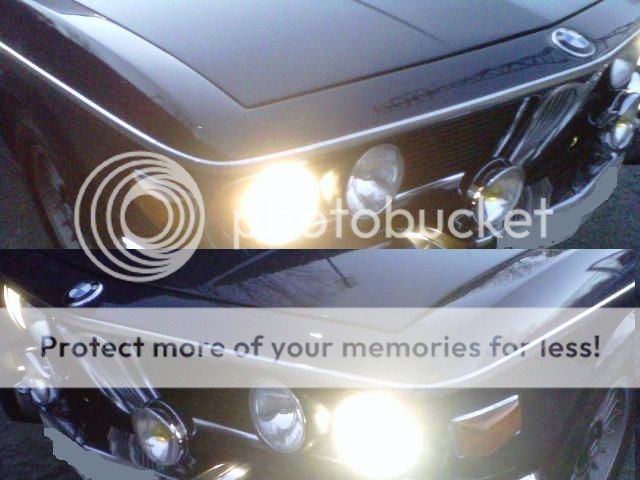

the correct use of the LED T4W OSRAM light is in here, front headlights
on top of the photo you can see the RH side headlight fitted with original conventional 4 watt position light, despite the H1 Low beam is present the general aspect is of a yellowish colour
below, the LH side shows the LED T4W OSRAM, much brighter and white

i think blue light in LED's comes from very high temperature (kelvin) bulbs. generally north of 5000 degrees. 2700 degrees is like incandescent. 3000 to 3500 is white but still a little warm. 4000 to 5000 is very white. i just looked up the osram T4W bulb, its 6000 degrees, so its going to be blue. but, osram does make a 4000 degree bulb also. one other note about LED light, it tends to be very directional, which incandescent light is omni-directional.
any idea of the temperature of the bulbs that you used? note of caution, not all LED lights are dimmable.
deQ, are the 2w bulbs in your speedo old? or newly replaced?
