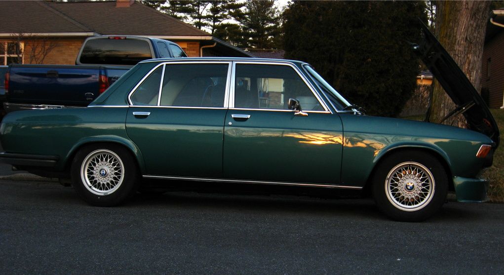

Max, Sounds like a good find. Engine should be simple to sort out. You have any pics?
e3Max
13
1
Allentown, PA
Luis A.
1,529
357
Wisconsin
Nice color; great stance! Doesn't look like a factory color, what is it?

The description when I bought the car said Mercedes Oyster Green Metallic. The car was painted in the mid 90s and from what I can tell, it appears to be the green used on Acuras, Hondas and Izuzus from that period. They did a good job of repainting it right, but now almost 20 years later it needs some touching up.
The car sits on Bilsteins and Suspension Techniques. I lowered the back end a bit a few months ago. Quick job of moving the spring perch down. It was 2 inches higher when I got it, now has a more level stance.
