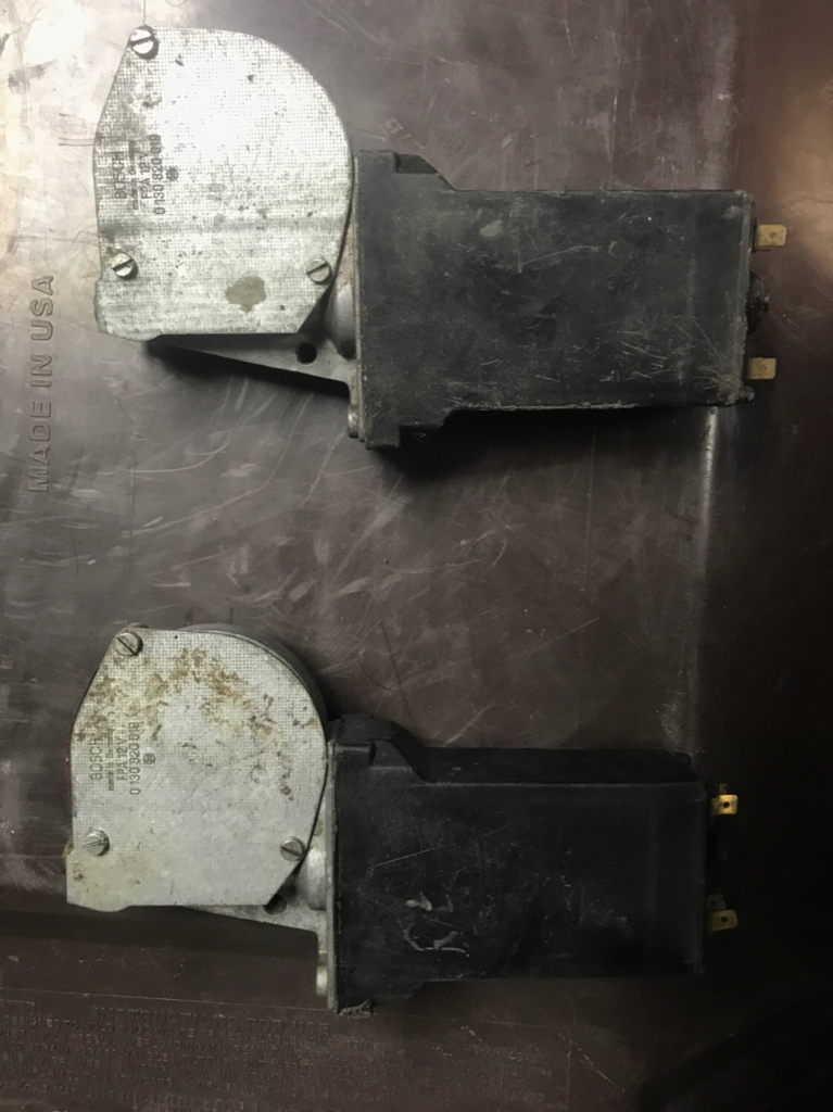

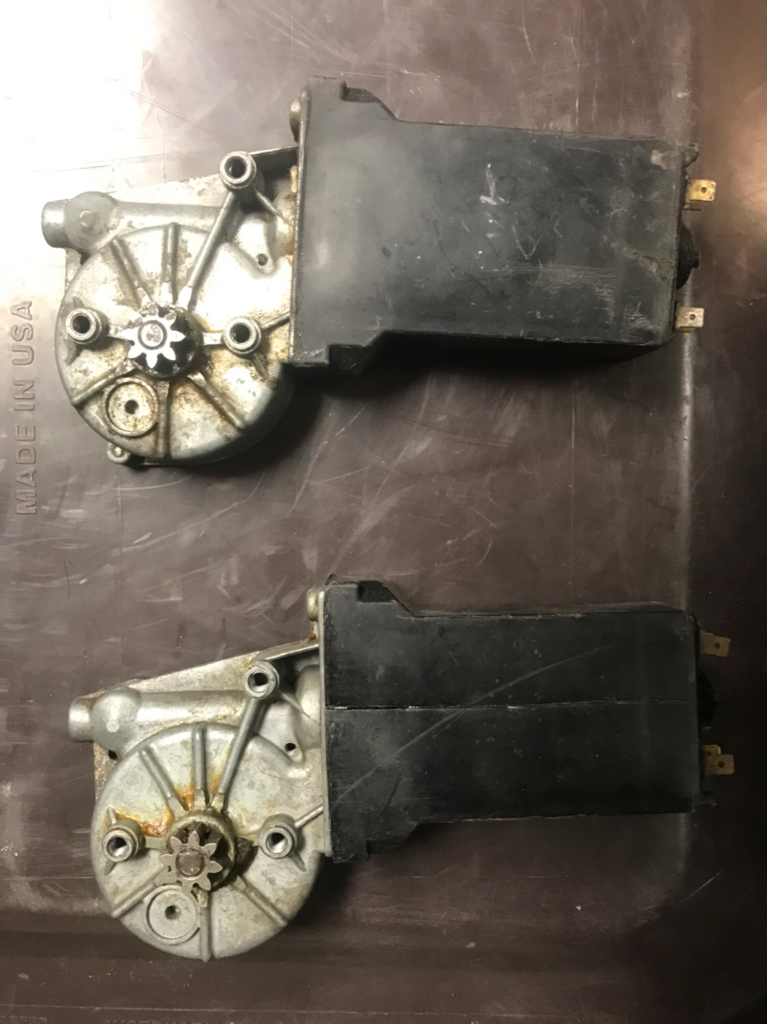

My passenger side front window stopped operating out of nowhere. My mechanic thinks it might be the motor. I have two motors that I purchased a while back that have now been replaced for I believe the rear windows. I am wondering whether it is possible to use these motors to replace the front passenger window. If not, does anyone have a source for a new motor just in case this is the issue?

That is great to hear. If anyone has a right side motor in great condition rather than me putting one of these older motors in let me know.

A lot of people have installed the motors from a later model BMW (or an early model Porsche 928 - the ones with 8 teeth on the gear). These transfer to the '74 models with no electrical mods necessary. They also increase the speed of opening and closing. When I replaced mine, it went from about 20 seconds from down to up to about 6 seconds.
If you do a search here for window motor upgrade, you should come up with at least several threads.
