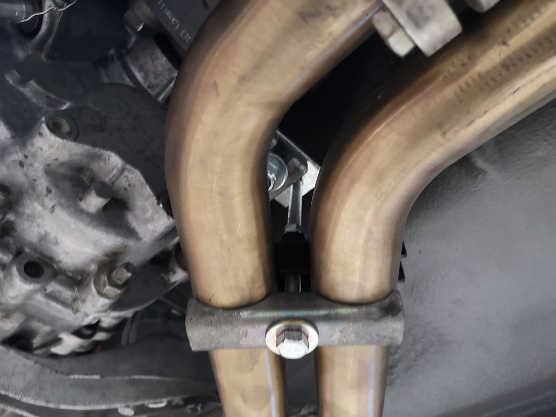

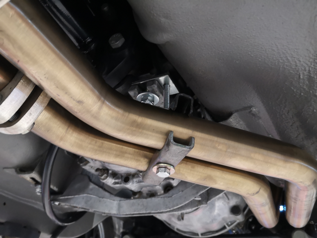

Here's how I did it, the small plate that bolts to the gearbox has a threaded hole for the threaded rod.

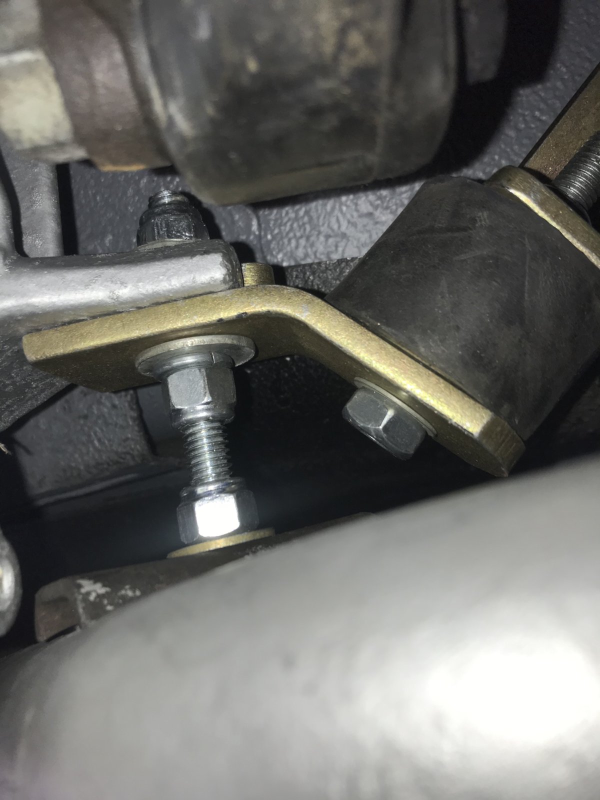

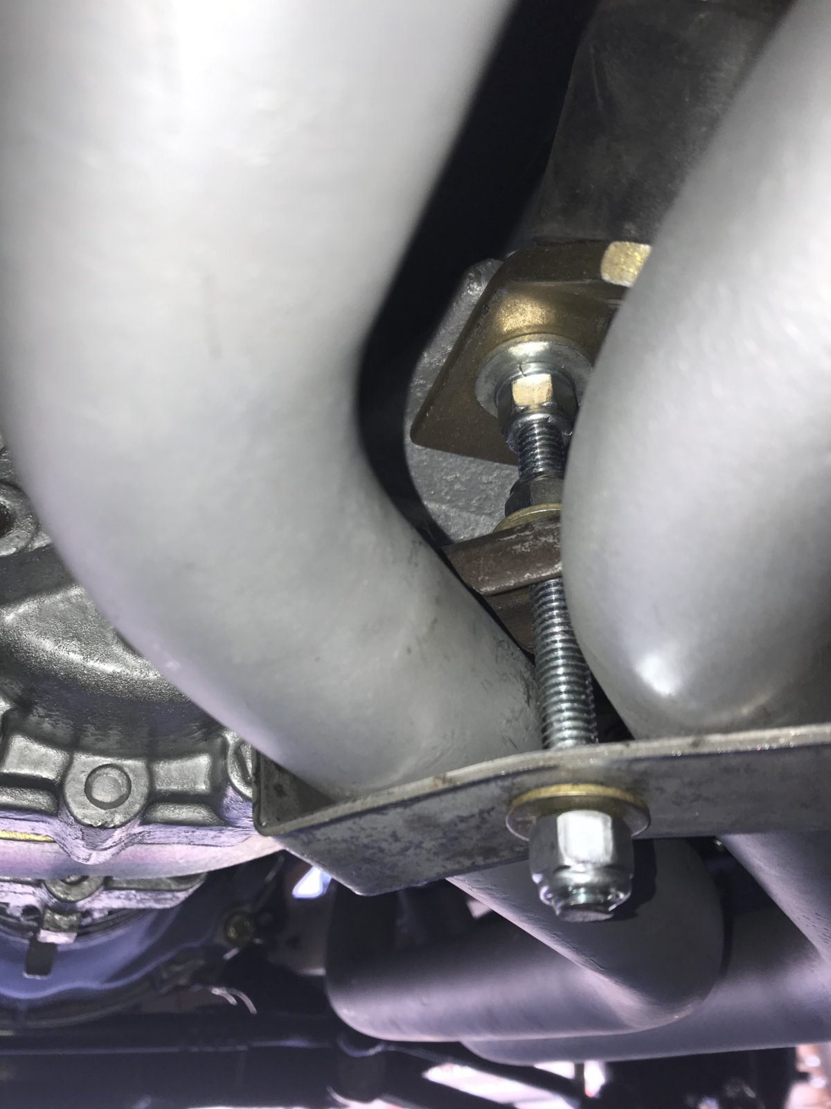

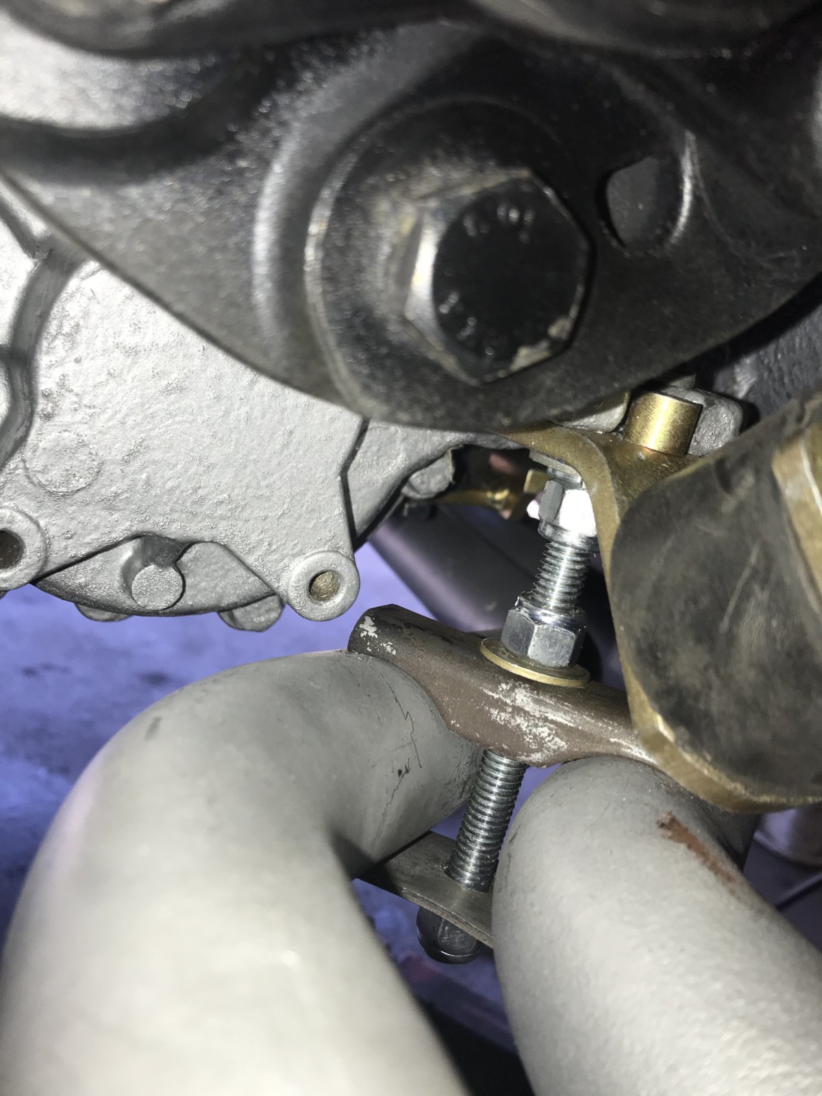

Hi Robert,
Thanks you for the inspiration. I followed your lead and used threaded rod through the tranny tabs straight down through the pipes. I used the factory bracket on top since the 'homemade job' rubbed on the tranny. Nice a snug :)
Regards,
Bill
