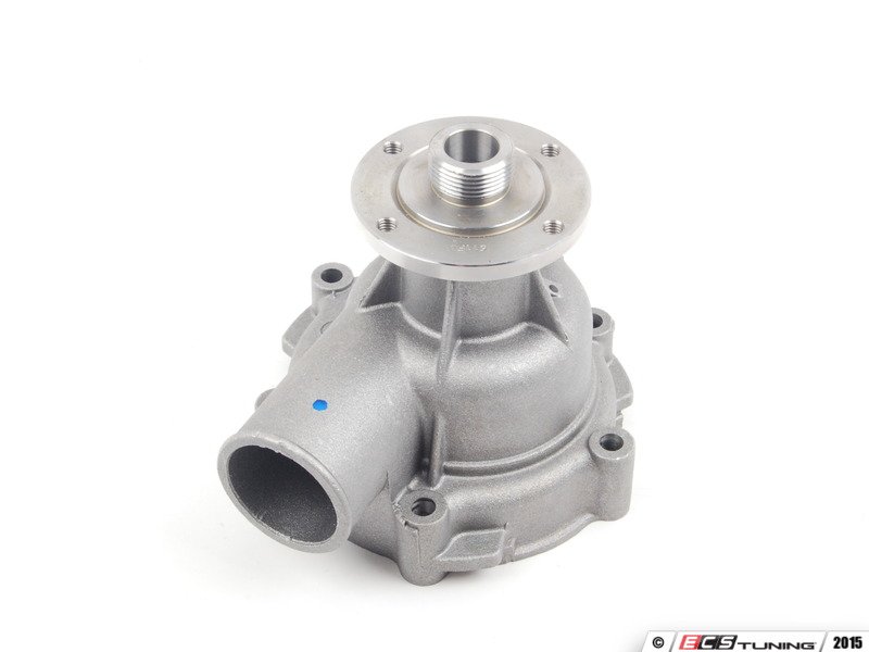

Your new clutch is a Spin On variety, only fits the lastest water pump. The earlier/middle style viscous clutch will fit early pump but as Steve says you need the nose piece to bolt to pump flange and then install your new clutch. Or rebuild the original mechanical clutch using deQ's article on refurb.
Thank you for the tips; however I've seen on RealOEM the fan clutch coupling but for what I saw I can't buy it there: is there any supplier which I can ask to?
In order to fit that new clutch you have you need the screw on water pump part # 11519070760
So that means that I'll need:
>A new water pump (11519070760)
>A new pulley which fits it
Sorry I don't know about the new pulley or if the old one can be used, perhaps others can help.
