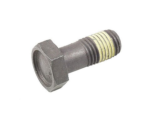

Is it necessary to replace flywheel bolts ?
From BMW they are very expensive considering there are 8.

i have always heard the recommendation to replace them. i am planning to replace them when the euro b34 goes in. they aren't that expensive
11221717840 part number - $3.31 each from getbmwparts.com ... thats 26.50 for the set.

Either way-Loctite 270... that’s the red stuff
Notice the factory manual discribes them as “expansion” bolts.
Says replace, install with loctite 270.

The description of "expansion bolts" suggests these are what have been commonly referred to as single-use torque-to-yield bolts. In that regard, I distinctly recall a machinist comparing used and new flywheel bolts with a micrometer and concluding that since they appeared dimensionally identical, he reused the old ones on his own M30 engine. While I am not advocating a contrarian view regarding reuse of flywheel bolts, especially in light of the manual's admonition, I can think of a few examples of reuse (mostly on M10 engines) without any adverse consequences.

I always use loctite and I have never bought a new bolt.
Never had a problem.
Always figured that factory goop was to keep oil from migrating...

I also spoke to a mechanic business here (who specialises in e9's) and he said they usually re-use flywheel bolts on manuals.
That being said if I can get some at reasonable price in Australia I will replace them.
Note: my manual also says torque of 100-115 Nm
I am also replacing clutch pressure plate and friction plate, but have no plan to touch the flywheel surface.
