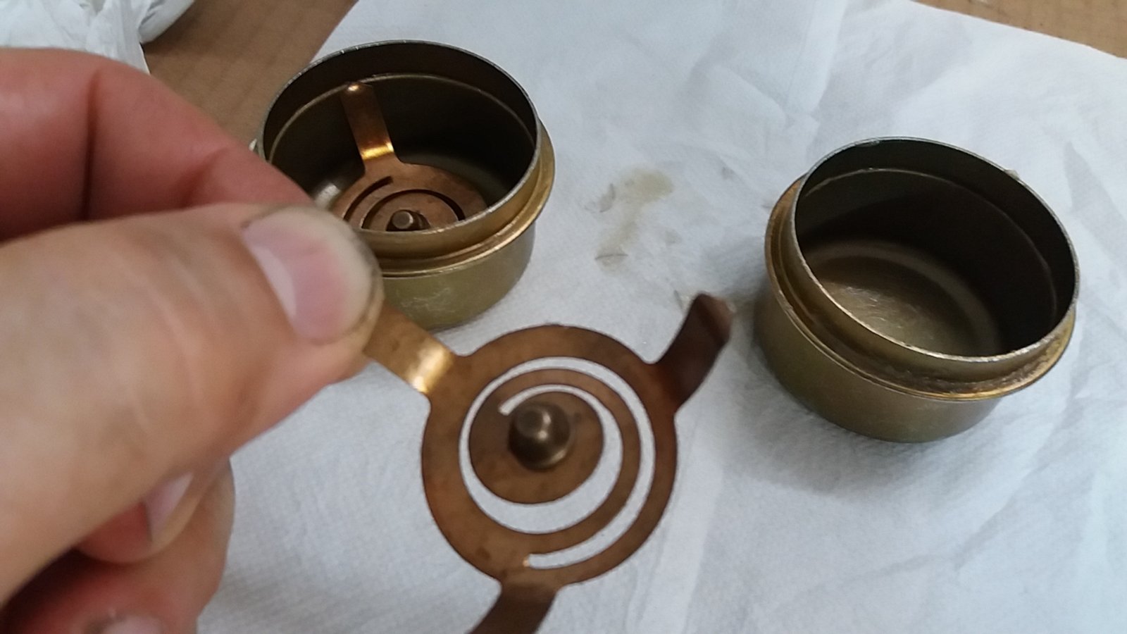

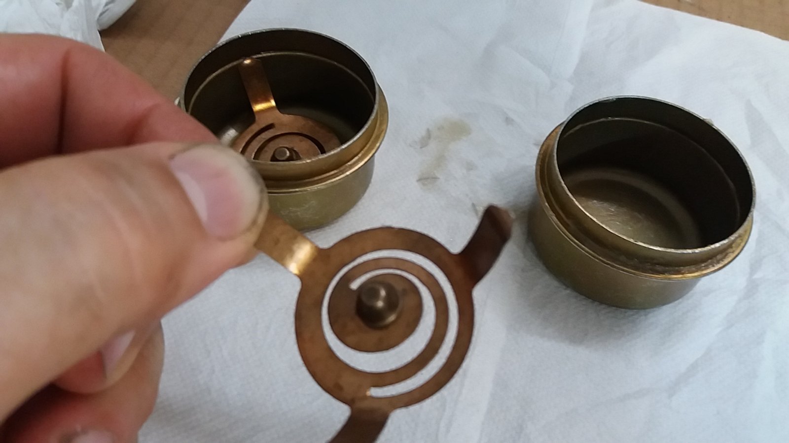

i could guess that it was for electrical "flow" but never have seen it on any car ….
do the spindles have a carbon tip as in distributors ? :D

Thanks for the write up. Interesting to see the internals of the front hub. I haven't tackled those yet.
I too wonder about the copper coloured circular springs, are they in my car, and if not, could they cause my garage radio to have massive inteference even though the car hasn' t actually moved in 5 years?
