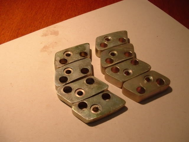

Umm. If I am not mistaken, the E9 and Bavaria (E3) calipers you are comparing are identical, except for the fact that the E9 caliper also includes two spacers that permit the caliper to accommodate the E9's wider vented rotor. Without seeing it, the Bavaria caliper you have may actually be the same as an E9 version, whether from an E9 donor or a modified E3 version intended to fit over the E9 vented rotors. I am certain someone has posted the two versions for comparison, that said, below are the spacers that fit between the two caliper halves.

Parts may be interchangeable; however, the fasteners and "o-rings" used to attach both caliper halves deserve extra consideration. Some fasteners are of a torque-to-yield design and not intended for multiple use. And O-rings probably do not last forever. So, the best practice would be to replace the two fasteners that secure the two calipers together. Since calipers are routinely rebuilt on an industrial level, new (proper length) fasteners and o-rings doubtlessly exist, but may not be readily available as part of typical caliper rebuild "kits." Please see this thread, especially including Luis' photos, which seem suitable for framing or inclusion in a wedding album. https://e9coupe.com/forum/threads/stock-caliper-rebuild.17389/ (I am confident there are more threads on this topic.)

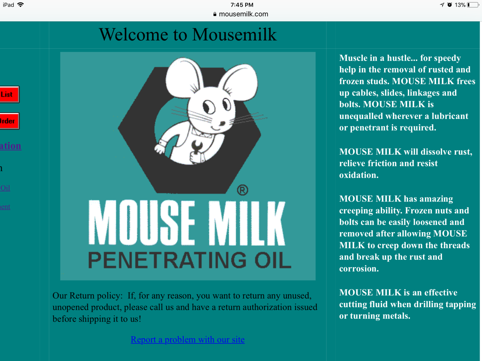

Try the mouse milk. Seriously. With all else failing Your situation is ideal for testing. I haven’t tried it but If it’s as good as I heard....
https://www.mousemilk.com
