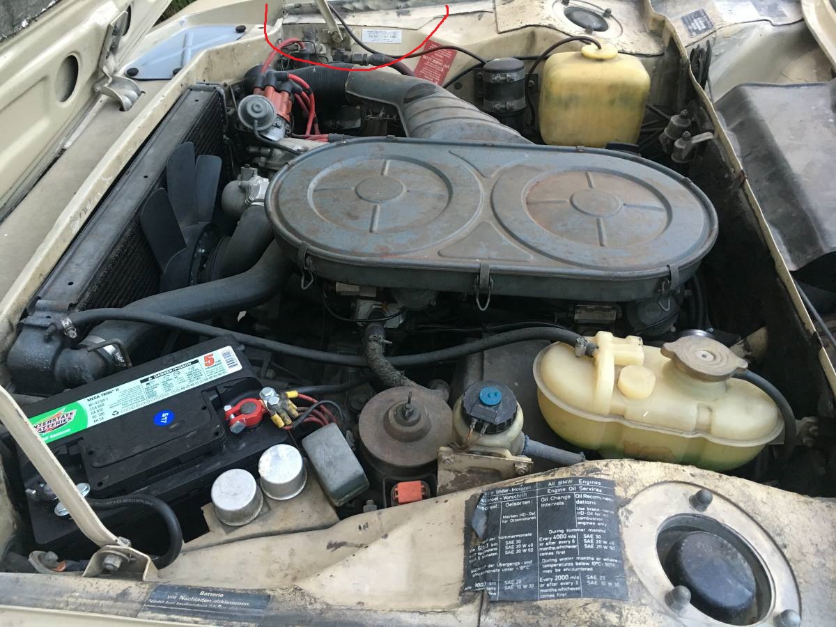

Enthusiastic, maybe. Anyone else noticed how increasingly rare under hood photos in for sale ads are which show areas like the one marked below?
If this particular shot betrays material condition, you're possibly looking at one, maybe two new fenders, with paint that comes close to doubling the 31k asking price. Better move quickly while the hype can save you from getting upside down!
Looks like a typical unrestored 45 year old engine bay to me....

are you saying rust bubbling or separation along the top join seams of the inner and outer front fenders is typical for coupes that sell for 30 thousand dollars? Almost every ad with pictures somehow or other (conveniently?) crops those seams from underhood photos. I am NOT saying this car needs that work, I AM saying that little area I highlighted is suspect enough (to my enthusiastically-jaundiced eye) to ask about it. Clearly you don't want to address that view/concern/problem area. I'm ok enough with that. Hope you are too (I'd really hate to get anyone sitting on a bunch of rust buckets all bent with my rampant negativism.) :p
That area looks dirty but completely fine to me. I see no rust whatsoever.

Even if it had rust who cares. You act like 30k is a lot. If it was restored it would be 100k. You can’t buy a rust free coupe for 30k. They all have rust somewhere unless they’ve been restored or sat in a climate controlled box their entire lifetime. Im grateful I started with nothing when I got into cars it’s pathetic the type of comments and disrespect I see towards these and other classic cars from grown adult men. It’s unreal what the difference in definition of rust is to a 40 year old with a checkbook and a classic BMW or Porsche on the west coast vs a broke 20 year old with a e30 or aircooled VW in the north east. Respect the cars for what they are and what is left. They’re not cheap cars anymore for a reason. The majority of them dying to rust is one of them.

the majority of the conversation about this coupe was NOT disrepectful ... i look at accurately describing a vehicles condition not to tear down what somebody is selling, but to protect the potential buyer from what they don't know. i am in the process of buying a 2nd coupe to restore that has some rust issues ... because of its original (unique) color - ceylon. but i know what i'm getting to start with as it has some rust issues, and i know there is more lurking that will be discovered. new people to this forum do not always know what some of us know ... and they might get burned. you are correct, 30k isn't a lot for a mostly rust-free coupe, it would be a bargain ... if it was riddled with rust, different story. what is important in the conversation about value is - understanding the total / overall condition - the restoration process goes up exponentially when everything needs to be sourced and replaced rather than a reasonable amount of cleaning / refurbishing.

I think in regards to any coupe north of $20k needs a PPI.
This one looks good and may be even better with more high resolution pictures.
I think right now with this market, the average #4 car with minimal rust is now $30k. This could easily be a #3, $45k car with engine detailing and maybe a new headliner
