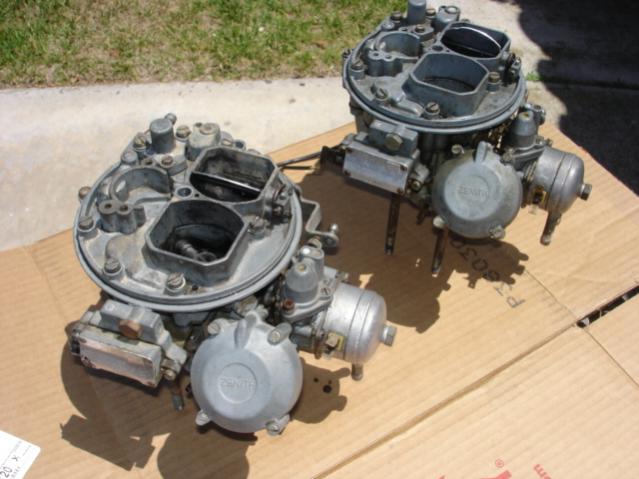

Original Zenith 35/40 INAT dual stage carbs. Used but clean. See pictures attached.
The pair: $200 + shipping (I'm in San Diego, California).

What is the rectangular device on the side of the carbs? Mine does not have that item, just wondering, thanks.

Thermo electric starting valve? The part with the aluminum cover with four screws; unless I misunderstood.
The carbs have the newer choke/ diaphram caps.
I don't see the shutoff valves or holes blanked so possibly euro/ early with an upgrade on the caps.
The carbs were used on several models/ makes and the jets are all pretty close except for automatic cars.
Has anyone ever rejetted for modern fuels? It's not been a problem for me looking at the plugs. But with modern mixes with gasahol/ additives cars like Porsches can see an increase in HP by jetting up two sizes. ( More fuel/ better burn with modern fuels.)

I think that 61porsche might be right... Or are these the shut off valves? They have the 20 ohms symbol stamped on them. I will check tonight and provide more details.

The idle shut off valves would be shown in the second photo. Round electric cylinder solenoid that screws into the base, below the fuel inlet fitting and towards the center, and angled. Don't see them. But a couple others have reported the same carb. early 2800s?
The 20 OHMS ( Different spec cars had a different resistor- in the bluebooks) marking is for a resistor under the cover which lifts a valve/ port opening and supplements the choke circuit in very cold conditions. It's likely that this part causes rough idles. If backfiring occurs ( too much advance/ loose chain, etc.), it goes here too and the small valve becomes dislodged. Easy fix though once you know that's what happened. The gasket on the banjo bolt can leak here also.
The carbs are good. But it's these little things that people talk about warped bodies/ plates that can cause similar conditions and misdiagnosis.

I have a spare set for my `73 for that very reason but none of them have that 20ohm box for the chokes. Perhaps on very early or very late cars?

Answered my own question with RealOEM: introduced during `74 non-U.S. VIN production.
THERMO STARTING-VALVE
Fg -> 4300416 / 3.0 Cs
Fg -> 4320528 / 3.0 Csa

So, I checked my BMW factory repair manual and it shows that the thermal starter valves were only available on US models 1969-74. So yours have to be non-US ones.
Other bits from the manual, this carb on the 2800CS/CSA used the 20 ohms thermal valve and on the 3.0CS/CSA it used a 13 +2 ohms thermal valve.

Well, the parts book says those are `74 and on non-US parts which makes sense if it's for colder climates. The Blue Books weren't written for the U.S. market but for all markets. I have never noticed where they specify US vs. non-US but I could be wrong, I don't have them in front of me.
