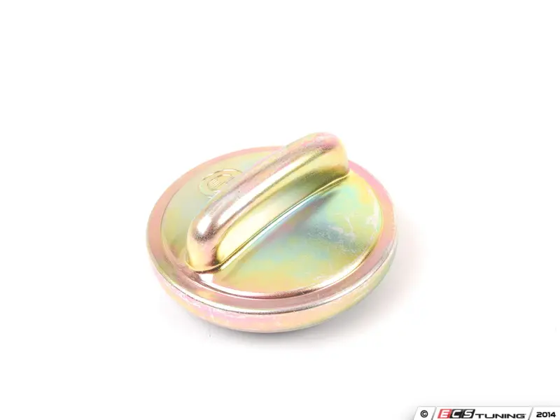

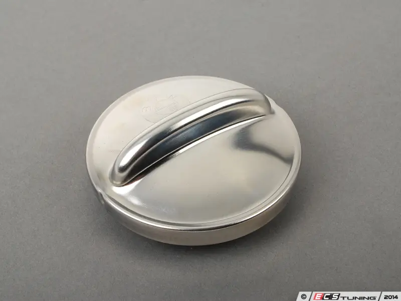

i have a question ... i was going to buy a new cap and the ones i have seen on real oem are for also 635. my memory is that there was a different cap for a 2800cs and a 3.0cs ... one was vented and one was not. anybody remember which is which. i did a quick search on the forum but couldn't find the information in looking on w+n, they sell one - part # 16111118379
adawil2002
5,186
3,049
Brunswick, Maine
WN 16111118379. That looks like my fuel cap, yes will fit a E24 & E28 as well. Not sure about the vented vs not vented. May depend on the evaporation tank in the trunk under the parcel shelf, or a atmospheric vent on the filler neck like in my 2002 Tii.

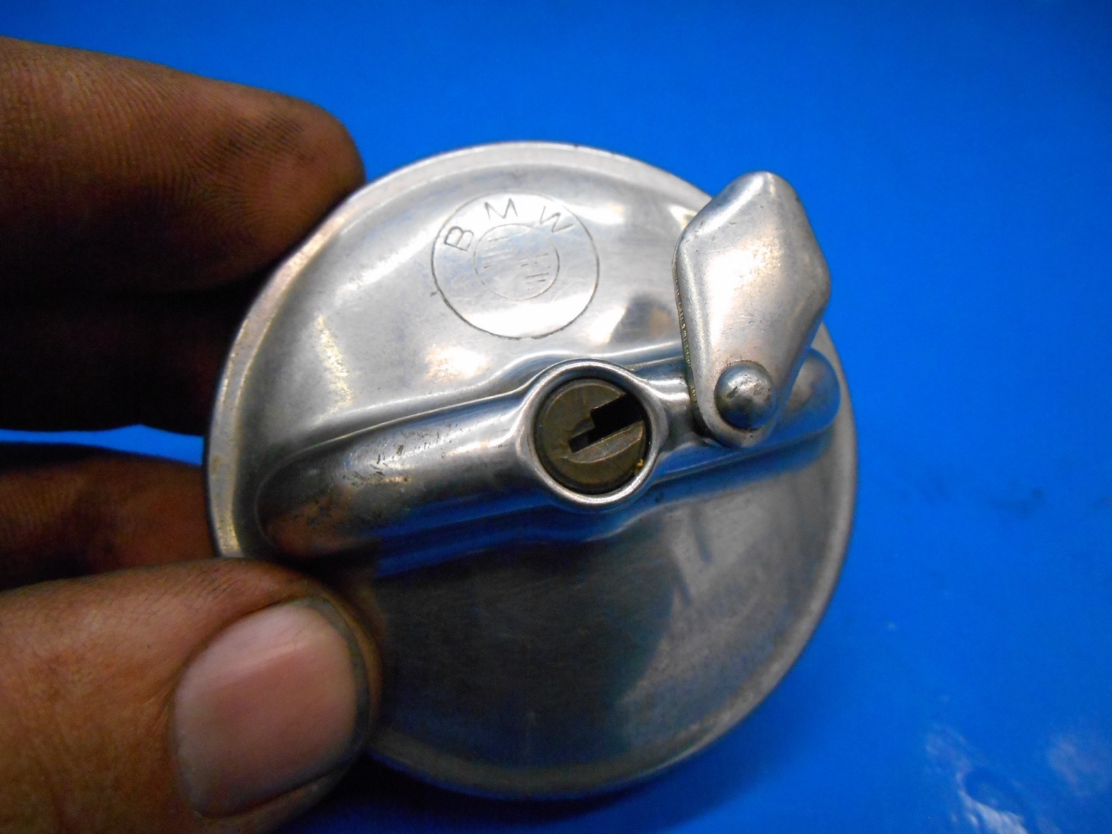

W/N has the standard type but take a look at this one. Needless to say, if it appeals to you I’ll do the needful.
https://www.ebay-kleinanzeigen.de/s...8-e23-z1-02er-2002-tii-e12/1054337158-223-710

The one on W+N is the same as on my 72cs. And is exactly the same as the oil filler cap on my 1981
ford escort XR3 turbo alloy engine cover but without the bmw emblem. But il be swapping them over for when the escort is on display at the practical classic and restoration show at the National exhibition centre in March, just to mess with the heads of the ford purists. LOL

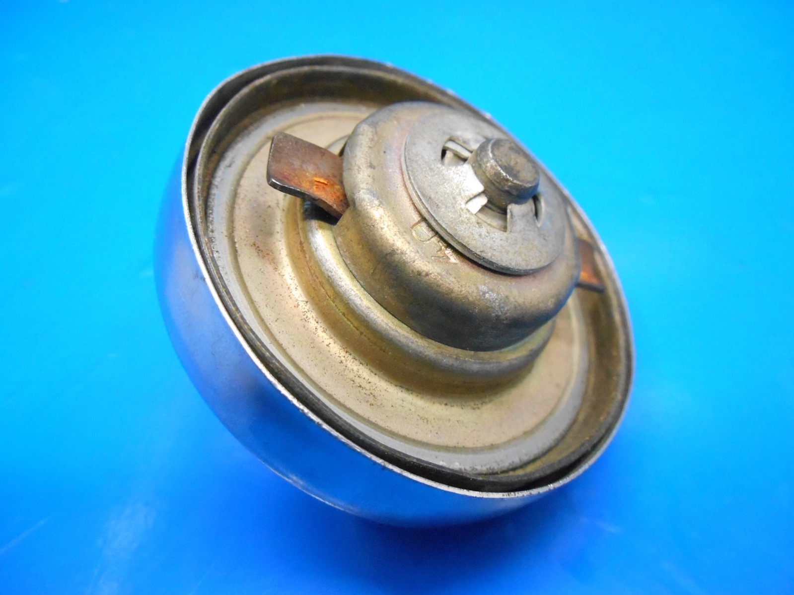

There was only one standard gas cap for all models in the parts book, all are unvented as stated earlier.
Perhaps there is a tiny exception with regard to lockable caps designed and manufactured for vehicles not originally intended for sale in the US. On those caps, there was probably little consideration given to incidental venting, especially considering that the rest of the system was vented. Since the locking mechanism necessarily involves parts that move, thus requiring free play, they were probably never perfectly sealed. :eek: They most probably did a fair job containing liquid, but vapor maybe not so good. On two personal examples, squirting oil in the key opening can result in some weepage at the other end (interior) of the cap.

i do have a beautiful original cap without key, original
let me know if that would help you, i use the keyed cap in my coupe
