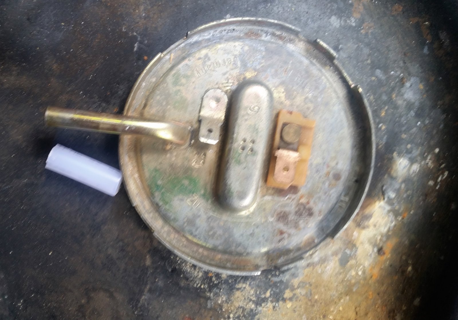

Changed the fuel sending unit gasket, the plastic cracked white cap, replaced the gasket on the fuel tank cap and the old braided fuel hoses. Smell is gone. greg
halboyles
677
691
KC
Very common fuel leak on many bimmers. Can be fixed with a simple plastic sleeve. If anyone needs this sleeve, just PM me and I'll send you one free of charge. I've been doing this on 02FAQ for years. This pic shows the sleeve on an '02 but it is the same for the e3s and e9s.
