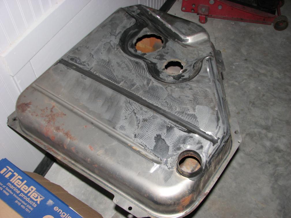

Before attempting to start my latest acquisition I decided to go through the fuel system. As you can see I removed the fuel tank and have it with the folks to boil it out.
I was surprised to see the trunk area silver?:confused: I guess Fjord Blue is not the original color?

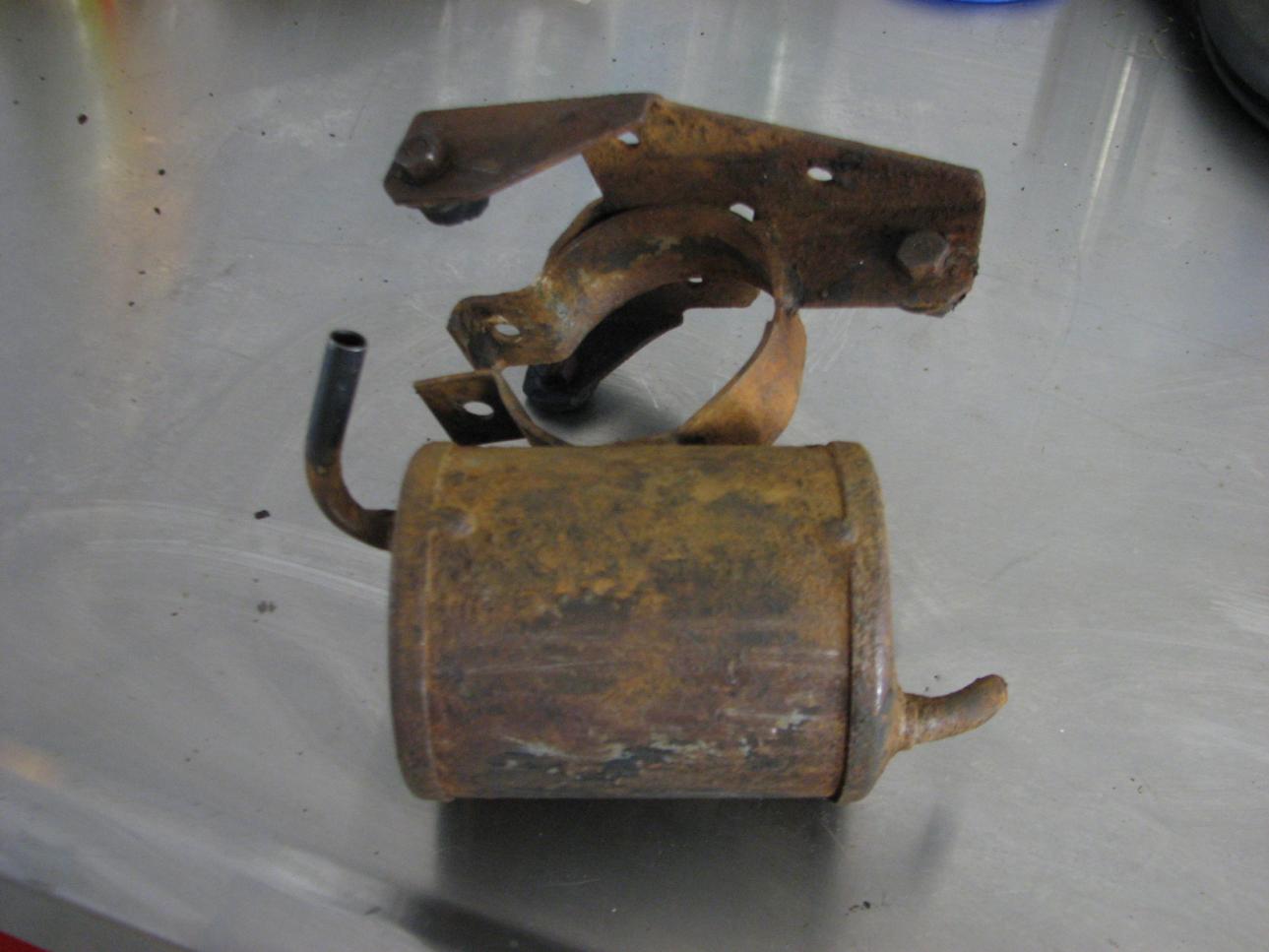

I pulled out the fuel pump and the fuel accumulator. The pump was not working so I dismantled it and cleaned the internals. Low and behold it works fine now.
The accumulator looks rough but is cleaning up. I may have it powder coated?
David:
Are you suggesting that silver is your car's original color, and not Fjord, because there is a stripe of silver beneath the gas tank lip? I'm no expert on CS coupe bodies, and it's a little tough to see the detail in the photo you posted, but I'm skeptical.
1) If the trunk area was repainted silver-->fjord, I would expect to see overspray on the tank - if the painter was too lazy to pull out the tank, they would probably also be too lazy to mask it.
2) It is pretty hard to completely obliterate a car's original color. If you haven't found traces of silver underhood, behind the dash (look through the hood lever&fuse access door), etc - if those places are all fjord - then the factory probably painted it fjord.
3) Send an email to Andreas Harz at BMW and he'll tell you your car's original color.
Last point: What's that thing that looks like a brake fluid canister at the center of the first picture you posted?

David:
Do you have an email address for Mr. Harz?
That is a 3" socket there to keep the gas lines from falling down and siphoning gas on to the garage floor. My girlfriend is already giving me a hard time about the old stale gasoline smell in the garage.
Further investigation shows blue overspray on the brake lines and inner door panels. I am slowly convincing myself that the car was originally silver.

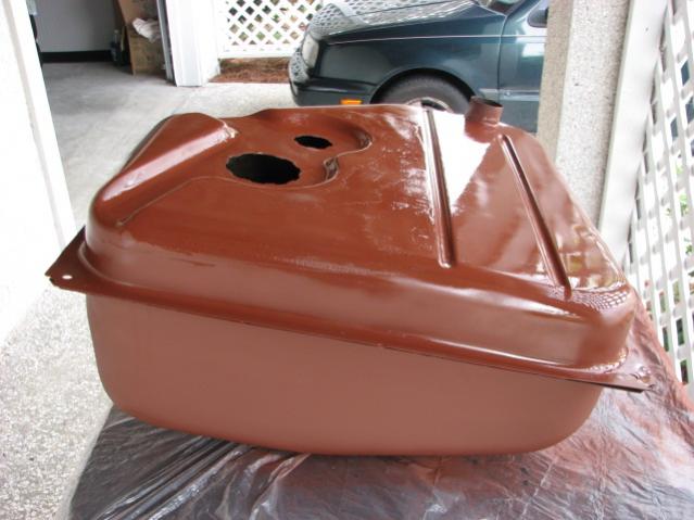

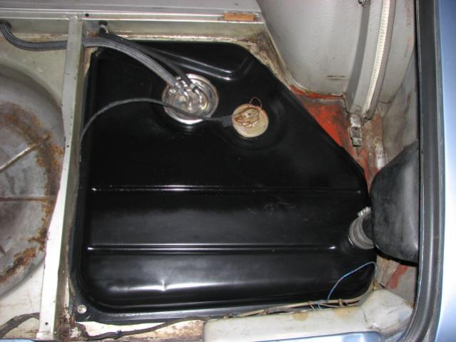

Well the fuel tank has been boiled, primed, and painted. All fuel lines have been replaced and a new fuel filter installed.
The caliper saga continues. Autozone said they could not get rears...right. My fronts came in and one was actually a rear? Now they can not get right front rebuilt calipers? Their rebuilts are very nice and have new pistons. I can rebuild my own but won't have new pistons not to mention how inexpensive it is to buy rebuilt. I will try pamps people next.

For the first time in many years (20 according to the previous owner) my car runs on its' own. Having replaced all the fuel lines, rebuilt the pump, and a gas tank redo it took a while for the fuel system to bleed itself but once that was done it ran fairly nice. Smooth engine.
The cold start valve works but has no signal to it so I hot wired it. I am now reading up on D jetronic. :-D
