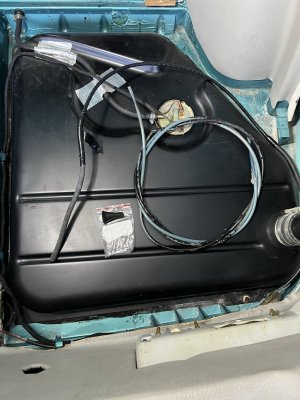

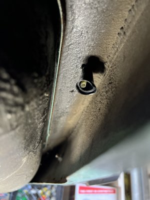

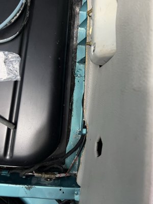

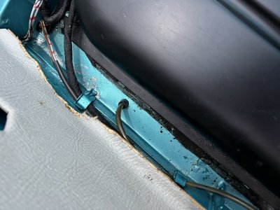

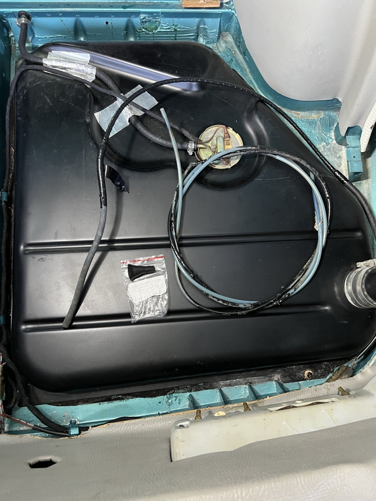

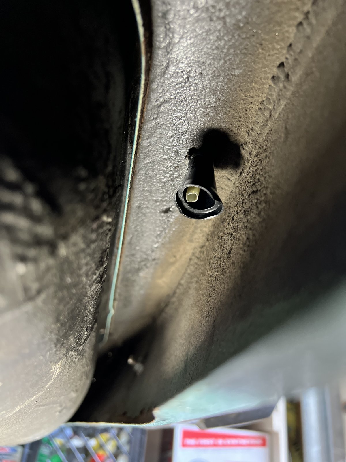

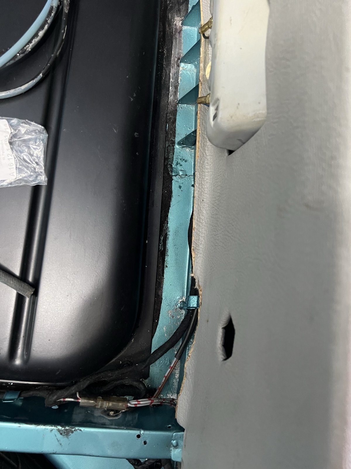

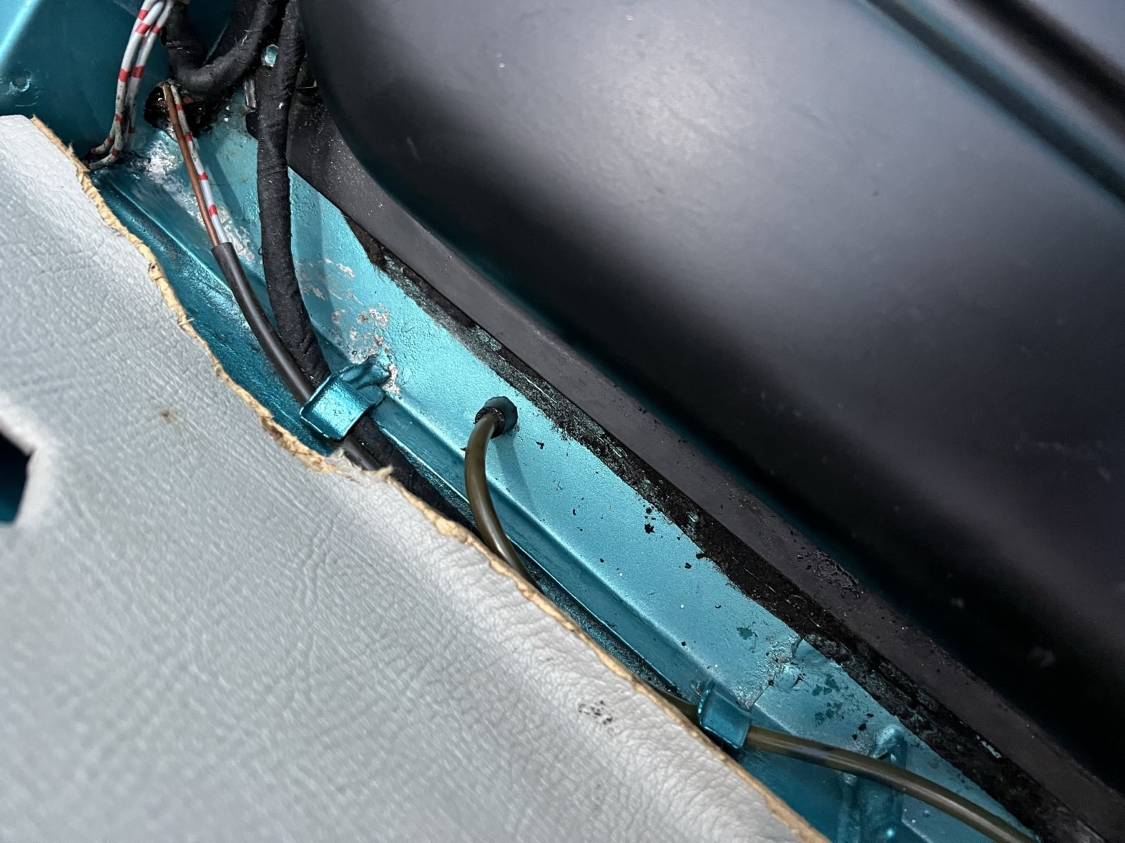

My trunk when opened had a gas smell. It was strong due to very loose fittings on the fuel pump hoses. The pump was mounted in the trunk. The previous owner used USA sized hoses which didn't fit tight to any of the metric hoses coming from the fuel tank sender. The shop fixed that by mounting a new pump in the engine compartment. But I could still get a faint smell of gas. The evaporator tank was removed and the plastic hose from the filler neck vent was routed through to the engine compartment. I still could smell gas. I found the hose on the filler neck vent was USA 1/4". I replaced it with the correct 6mm fuel hose and ran the plastic hose to the funnel-shaped nozzle pictured above after drilling a 3/8" hole in the bottom of the trunk. All of that plastic hose was pulled out that was running up to the engine bay. Here are pics of the work. Now the trunk doesn't have the gas smell. I have the triple DCOE carbs so the gas tank vent has to go out of the trunk like the German CSi.
