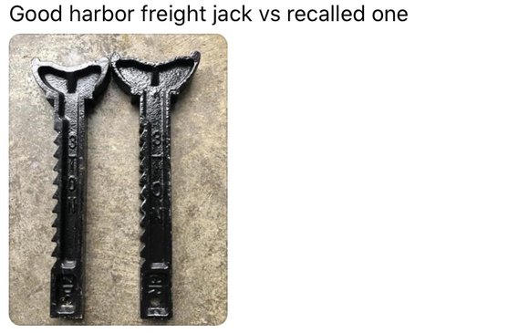

Saw this posted over on FAQ, thought folks here better take note Best to check if you have a set of these particular jack stands. Obviously, quit using them immediately.

I have a couple of these 6 Ton jacks. RIGHT NOW they are holding up my coupe up in the air....Gotta check them. Thanks for the heads up!
EDIT:
Mine aren't affected... Whew.

Good info to know. I have 4- 6 ton jacks stands from HF. Like Louis mine are NOT on the recall.

I looked at those jack stands my friend brought over and they are the recalled part number but for the life of me I couldn't get either one to slide down without pulling the release handle very high. Maybe they only had trouble with a few but I don't see the problem.

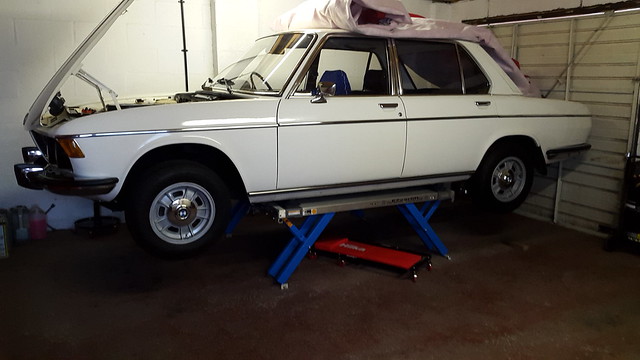

I also hate Jack stands. If I'm working underneath the car as opposed to just taking a wheel off I use my EZ Carlift (USA made). Locates on the jacking points securely and is very safe. I am guilty of just using a trolley Jack sometimes but never when lying underneath.
