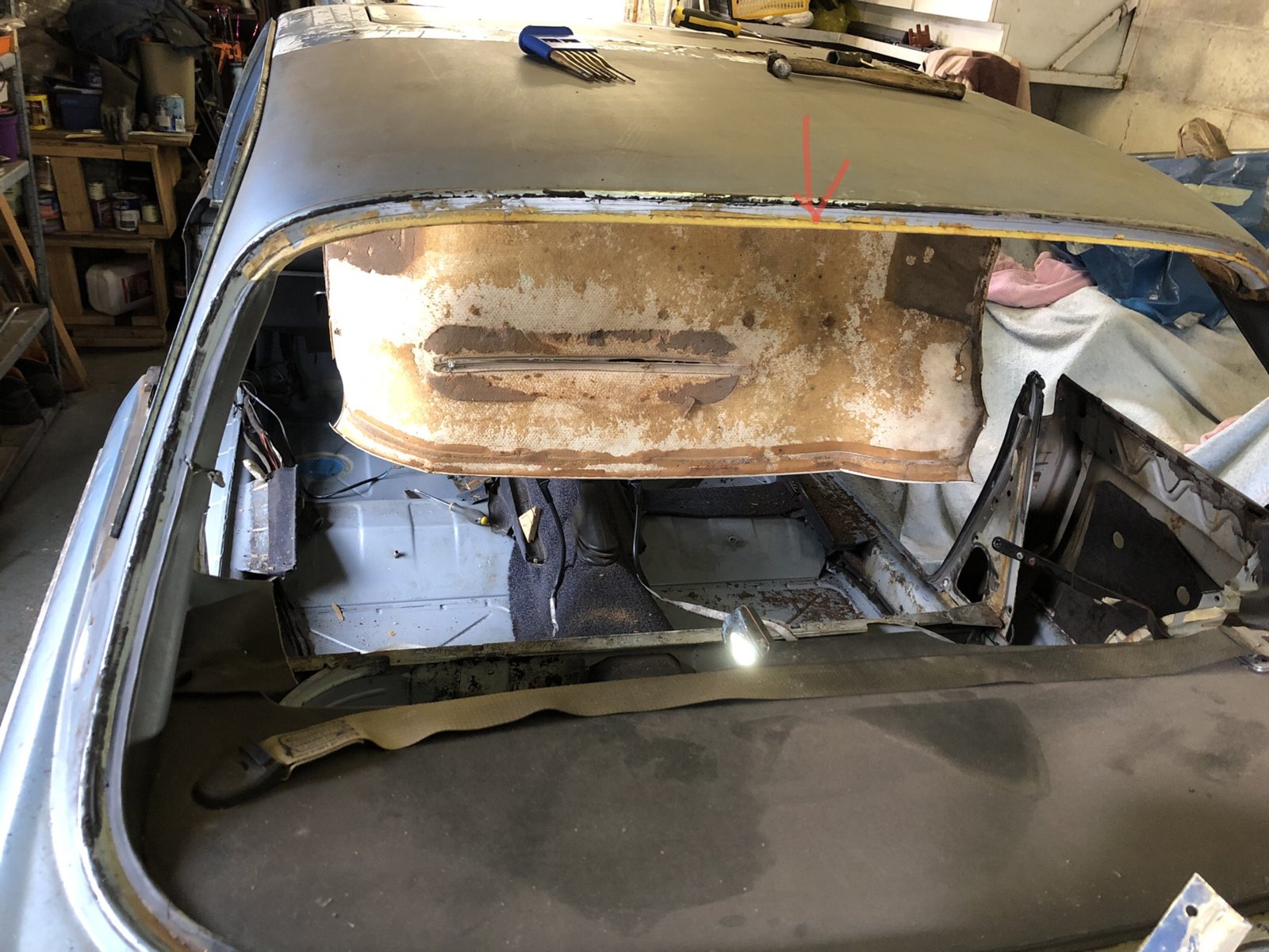

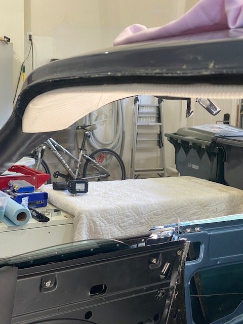

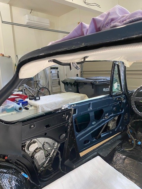

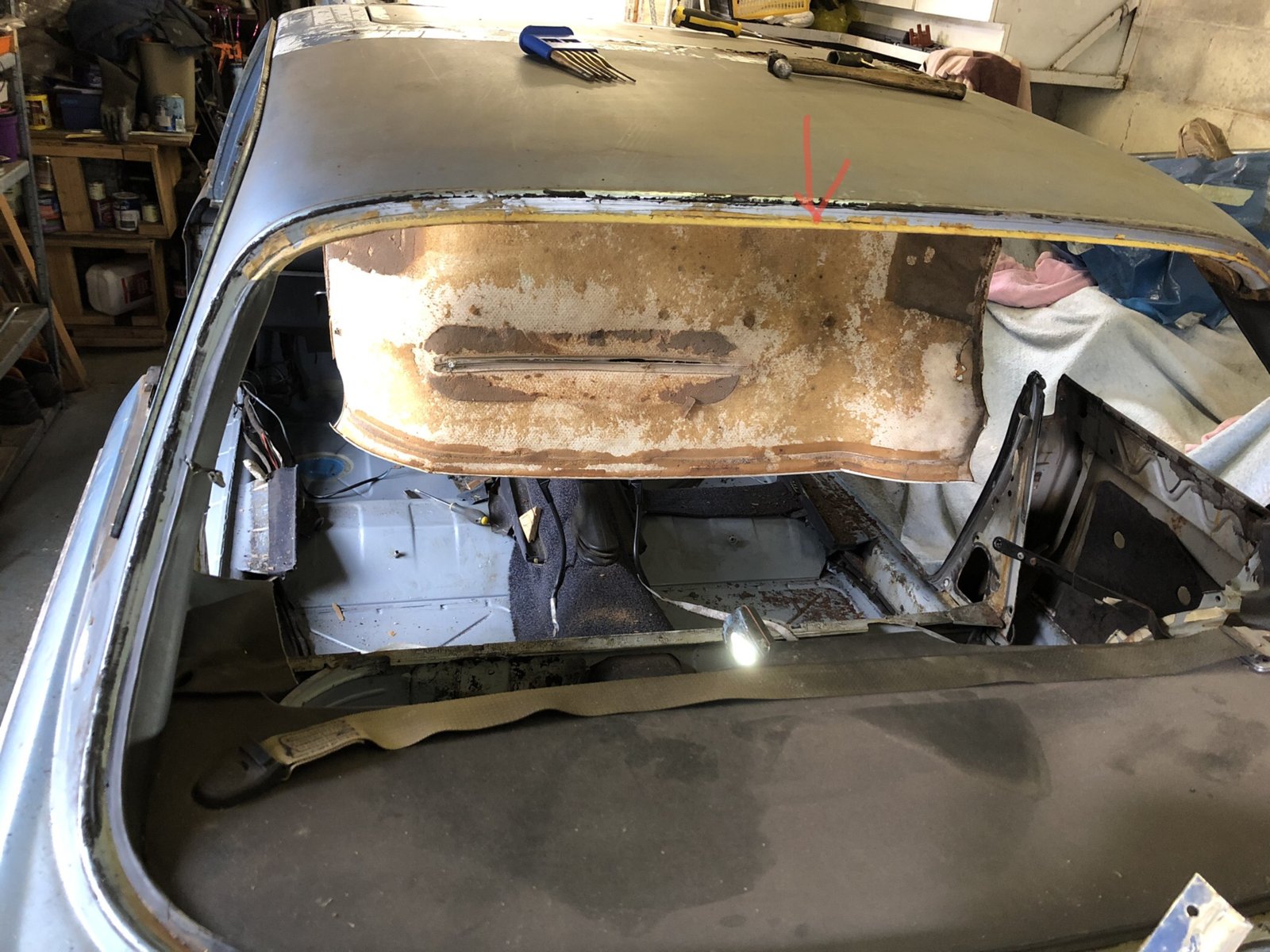

Hi All:
Does the headliner material bend over & get installed under the rear glass rubber or does it terminate over the rear header as in the pictures.
Thanks for your replies

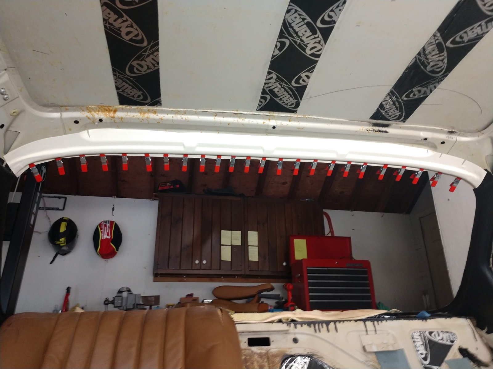

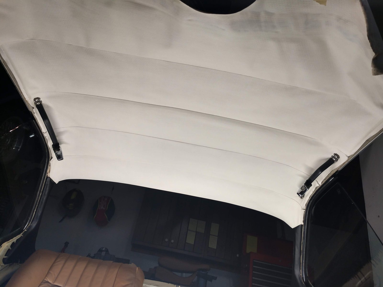

Hi there my sunroof headliner finished folded up over the rear windscreen flange by about 1/2” approximately.
You can still see the glue line on mine.
If you don’t have a sunroof it could be different though !

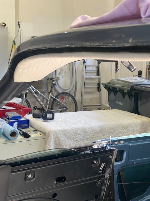

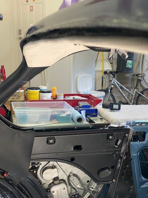

1. There is a transition piece that gets glued in to the window frame.
2. The headliner is glued to a formed piece of cardboard that clips into the steel roof. I don't have a better picture of this piece out of the car.
