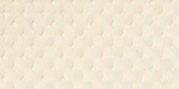

My brother has a 2000CS, most likely the original headliner, I will get a photo for you
I don't think anyone has the right stuff

HERE

pleasant hill , ca
THIS IS THE SMS FABRIC
