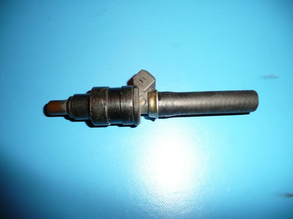

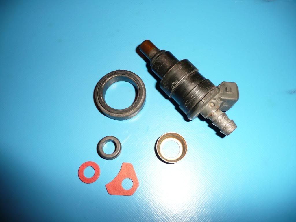

It all depends on whether the old Bosch injectors have the barb nipples or the straight round nipples. With the straight nipples (same nipple design at fuel rail), you can certainly use the fuel injector clamps without leakage problems. With the barb nipples, do not use clamps of any type as they will undoubtedly leak. Use the factory brass bowl only, fit bowl at the base and slide in rubber hose, done. Do not fit hose in dry as it will almost impossible going into place, lubricate the inside hose with a little gasoline and it will slide into injector with little or no effort. Been there!

Injector with new FI hose installed.
Rubber seals, brass cup, and mounting ceramic gaskets.

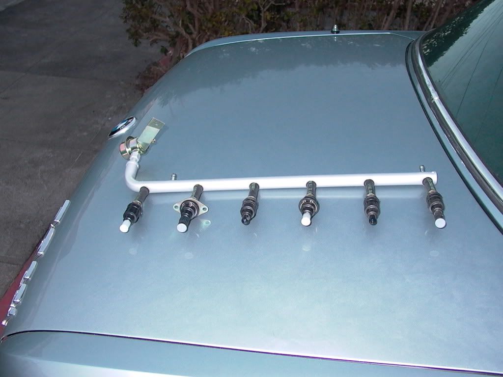

All 6 injectors with new hoses fitted into L-jet fuel rail.
