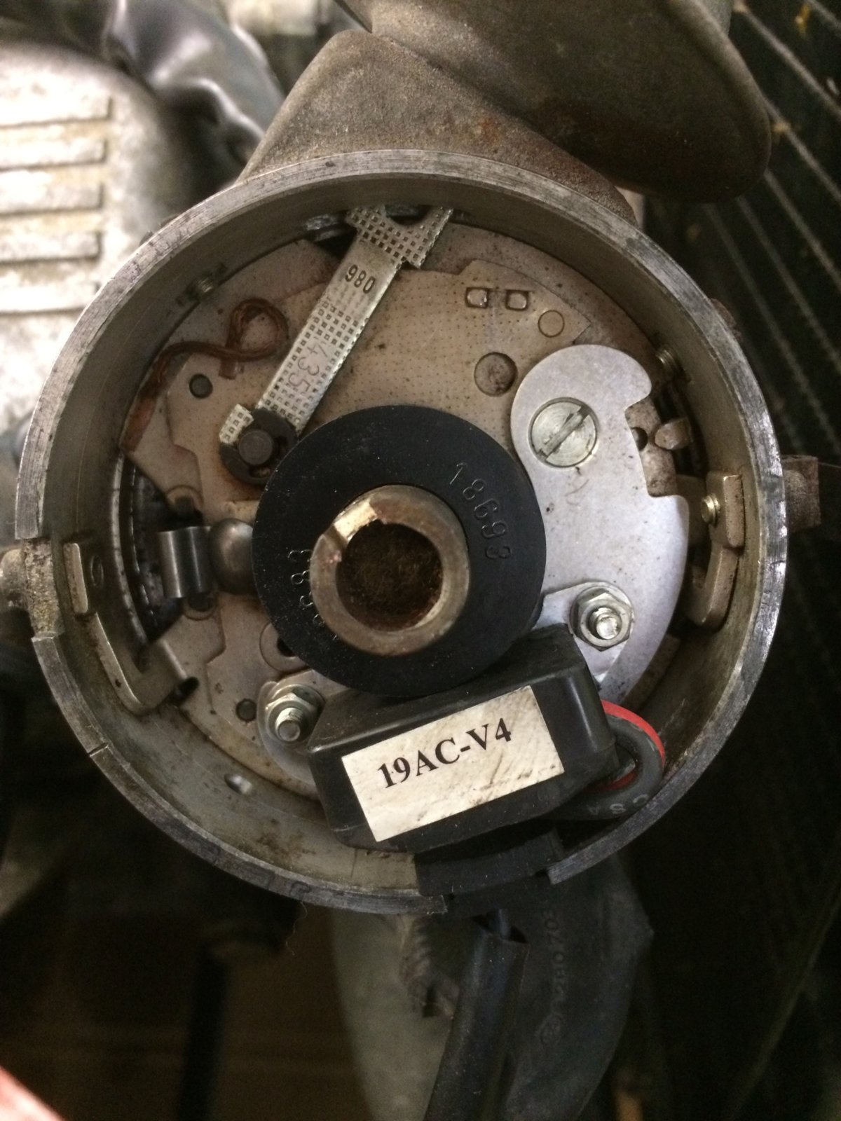

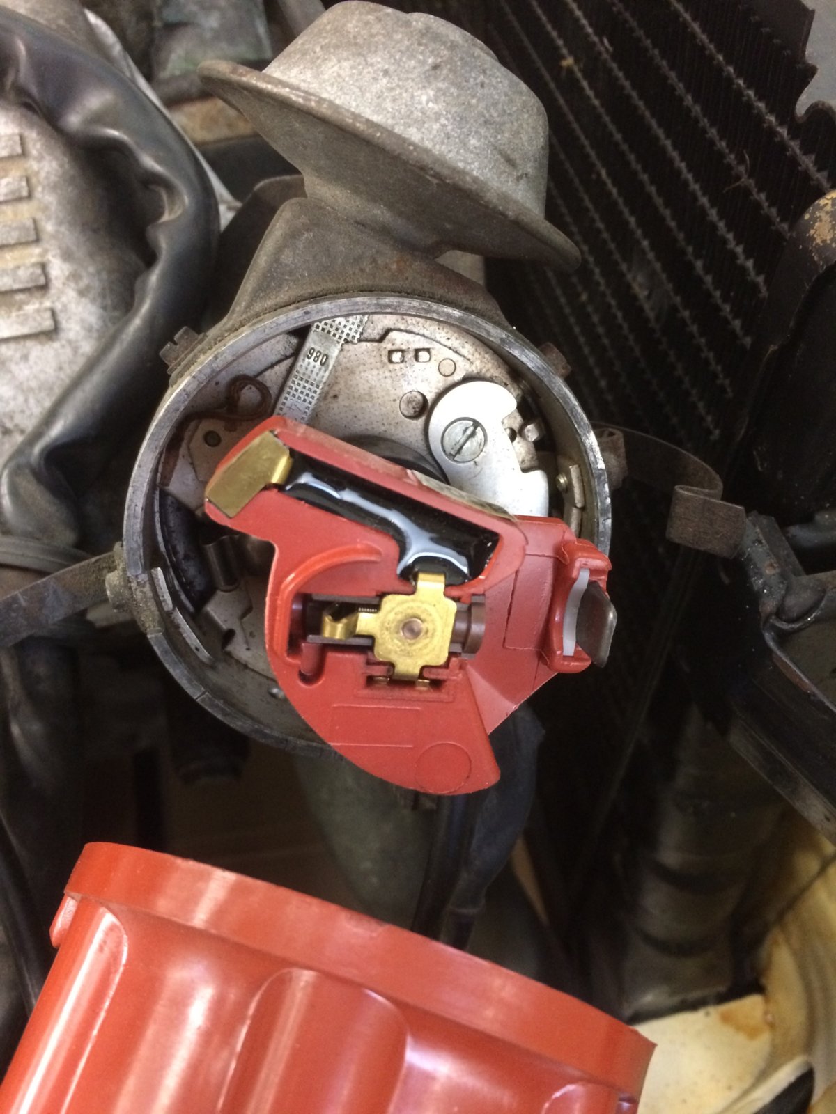

On ignition systems, could someone tell me what I currently have? (the last photo shows, I think, the condenser and ballast resistor; the ballast resistor is wired up still but the condenser is unplugged)

I've done a bunch of "hidden upgrades" on my car. As to the ones you specifically ask about, I really like the 123 distributor. (I do not recognize the one you have, by the way.) I have ceramic coated ported BMW exhaust manifolds. Stan had these done by Mario; I got his when he went headers. The coating does reduce temps, as noted.
