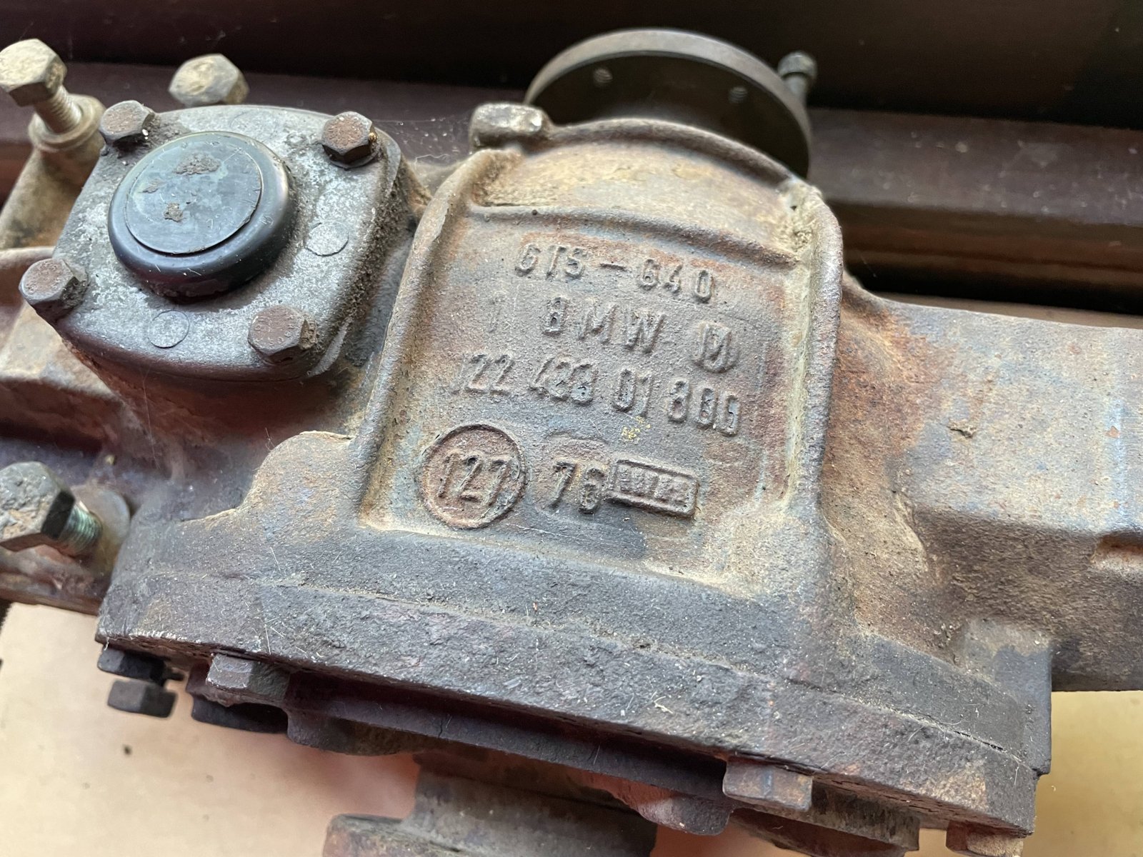

Any Diff Gurus out there? Wondering if anyone can shed light on what this is...and what BMW it came off? It's been buried in my garage for years and I can't recall where it came from. I've done some poking around on the web to no avail...

It’s gen 2 side loader.
note the M10X60 bolts threaded into the output flange.
that means 10 bolt.

thanks for the quick response... so would you know specifically which BMW's this fits - or is there is a definitive source that matches diffs to the cars they came with/fit?

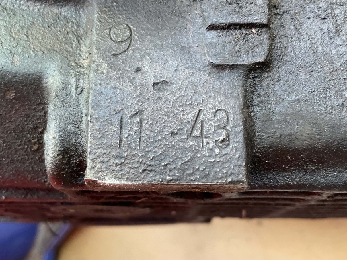

There are numbers stamped into the right side at the bottom you need to take a picture of those numbers.
