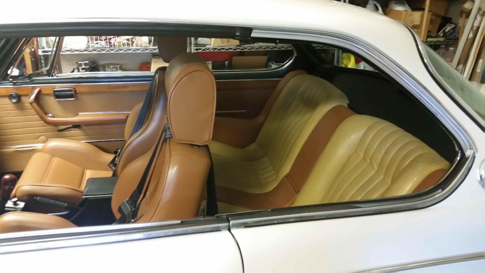

In search of a correct tan (goldbraun / tobacco?) rear seat.
Horse hair can be "iffy" but as long as the vinyl is correct color and herringbone texture, I can rebuild it. Would be interested in getting JUST the covers / arm rest instead, only for easier shipping perhaps? I'm crafty and I can make it work.
Located in Western PA. Can arrange UPS shipping as long as it's packaged to avoid vinyl damage.
Please let me know if any of you have one to unload. ***Needs to match the DOOR panels....unlike my current one shown in photo***
(the front seats are leather and I'll simply re-dye them to match...but this rear vinyl seat has already been dyed and I think trying to re dye it would fail.)

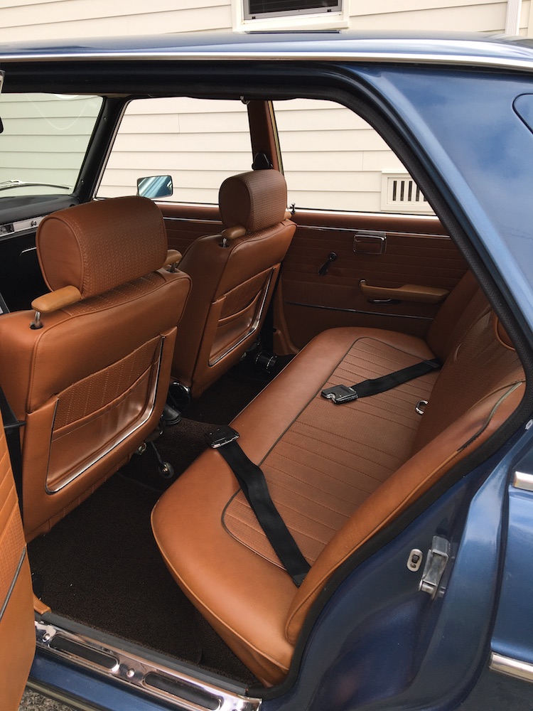

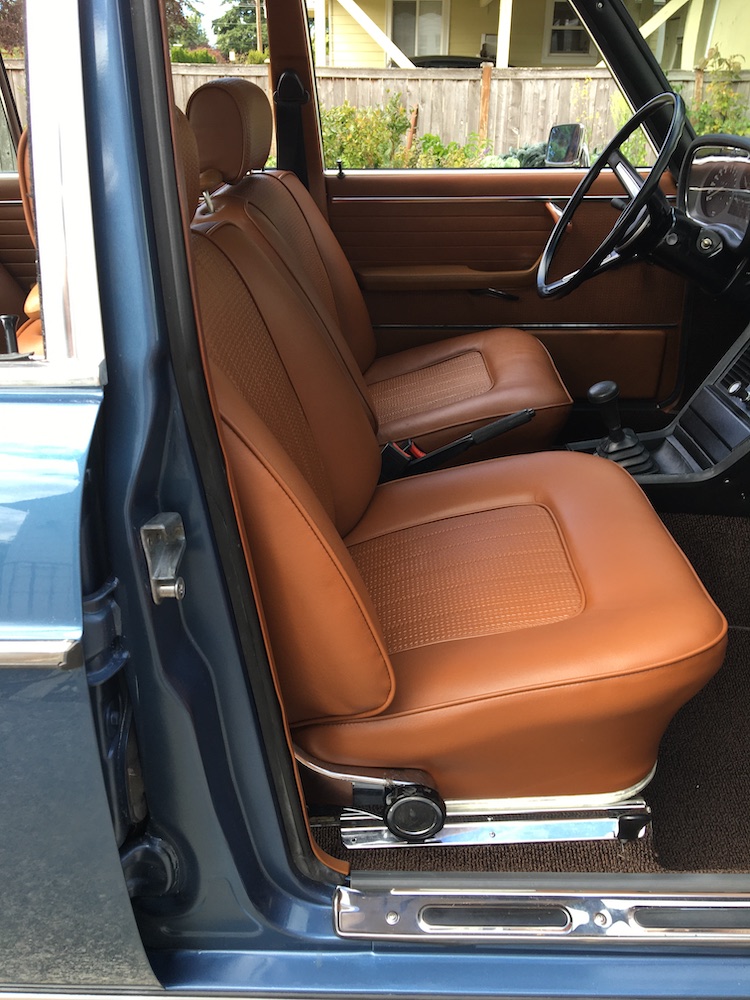

How about dyeing the door cards to match the front and rear seats? o_O
If that doesn't sound good (I do love the goldbraun / tobacco color), World Upholstery does sell just a rear seat kit in the proper color.
My rear seat and door cards were in great shape, but my fronts were a mess. I used their kits for the front seats. They matched perfectly to the rest of the original interior...
GORGEOUS!!!!

But what I actually came here to say is that I know someone win a full rear bench with headrests if you want a core. Not tobacco but after looking at the interior of @Dick Steinkamp how could you not want a new kit? :D
Man just looking at the e3 seats highlights how much easier it could be to DIY an e3. :(

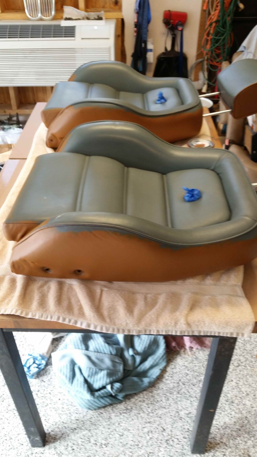

I thought the reason for using acetone on leather was to remove as much of the dye as possible so as to allow new dye to adhere to the leather. Vinyl is not porous, so I question whether this is necessary for vinyl.
When I changed the entire color of my interior, to include doors, armrests and seats, I used acetone and a leather cleaner on the seats and armrests, but I just went right over the vinyl on the doors. Seat color change, in progress:
2017 PVGP, with front seats and armrests done (including the armrests on the doors), door panel and rears seats yet to be done:
