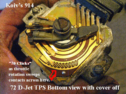

Assuming ignition seems tiptop, there are several things to check on the djet, not the least of which is the throttle position switch and the pressure sending unit. Wear on the TPS's circuit board can easily account for a cut out. See below. Not stating this is your problem, but you asked for suggestions. Another remote possibility is that your ignition switch or the connections at the fuse box are questionable and permit the so-called momentary cut-off.
"Symptoms associated with a defective throttle switch include a rich(smoky)idle and hesitation. An intermittent condition at cruise-which feels like you shut off the engine and immediately turned the key back on, can also be caused by the throttle switch." http://www.e9coupe.com/forum/showthread.php?t=2879&page=2
