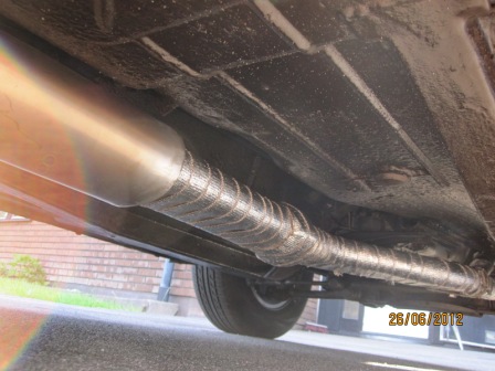

Exhaust wrap between manifold and first muffler did a lot to decrease heat at passenger floor and gearbox area.
