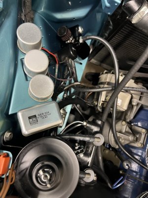

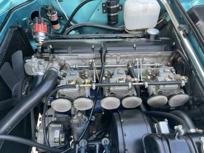

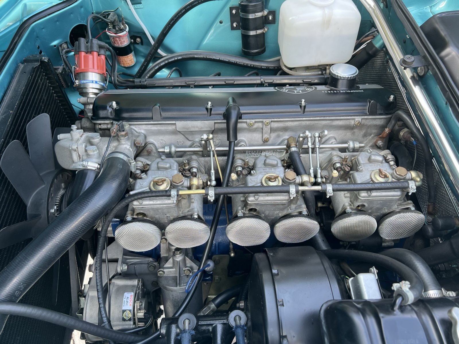

Several of the members have 3XDCOE 40 carbs. My car is a 1973 USA CS with the entire stage 2 Korman engine. The engine is an E24 3.3 L and the head is from 1986. That's what Korman built in 2005. If you were to buy just the carbs and intake manifold from Korman, they will tell you all the parts you need to have the engine run well. If you want more HP and throttle response, then a cam and lightened flywheel are where you start.

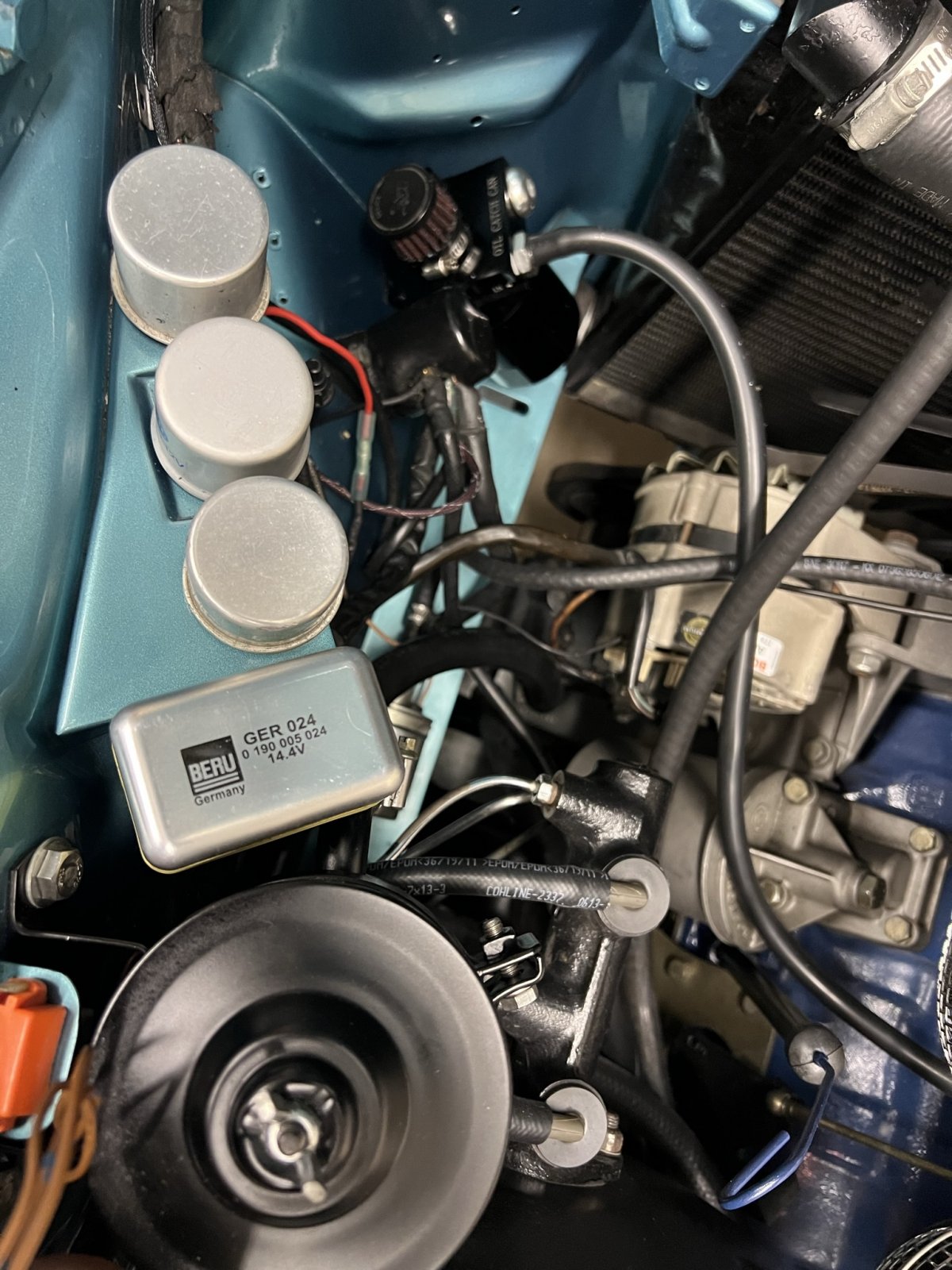

Hi Drew,
I am curious about your crankcase vent. Looks like a hose going to a catch can. What catch can did you use and where did you mount it? Also, which trumpets and filters are you using?

Lance--The catch can is mounted where the battery was now that it is in the trunk. I found it on EBay. The 1" long trumpets are the only ones that clear the brake booster. Those and the screens are available from Pierce Manifold.
When I really wanted throttle response, I drove my daughter's Tesla Model S that I had for 6 months. Recently I test-drove the BMW I4 M50 in sport mode.
It was "Ludacrist" !!----Drew
Here's a pic of the Catch Can.
