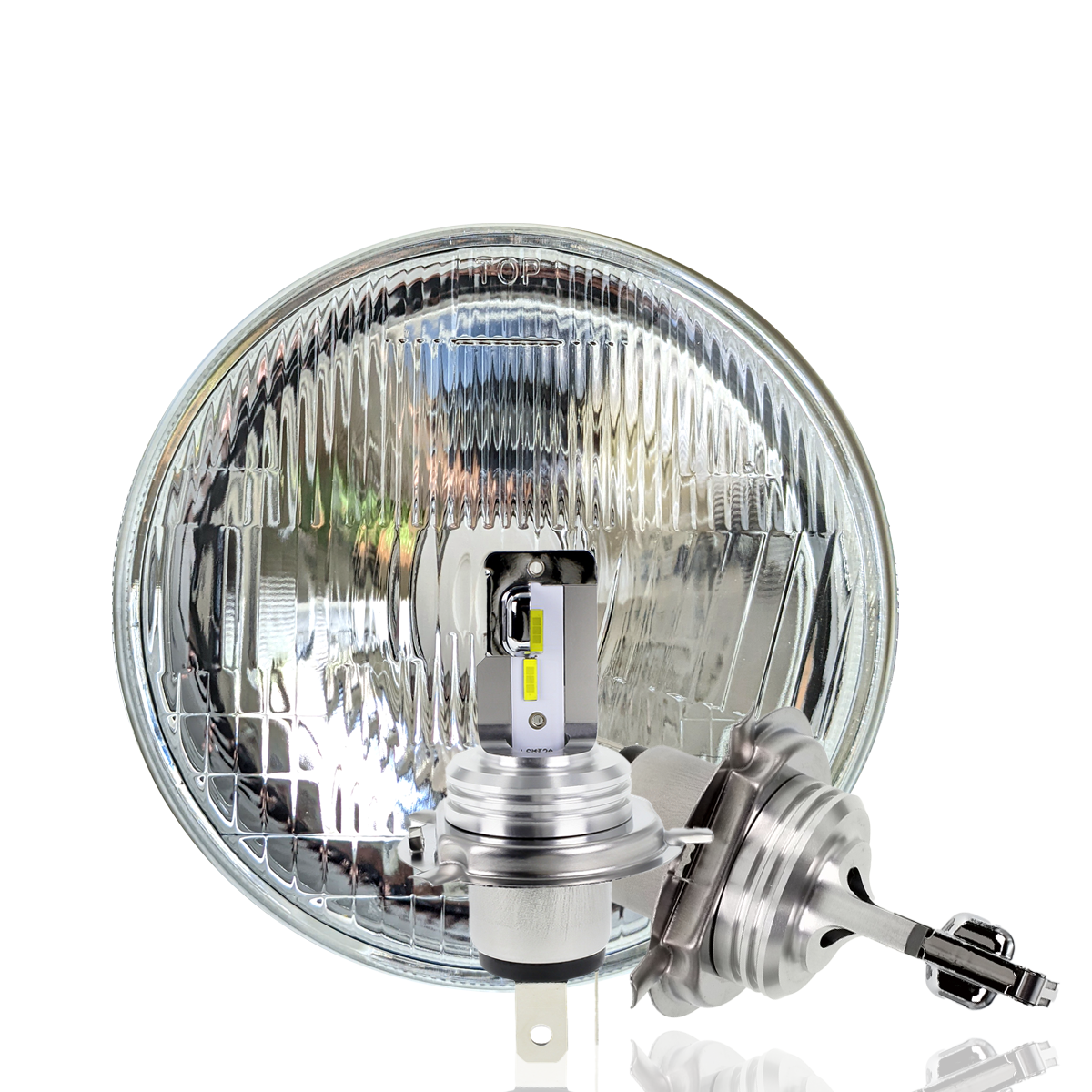

what i see is the color difference. incandescent is a lot more yellow than cold white LED (6500 k). i am not convinced that LED in a standard fitting for halogen bulbs is going to work well. halogen bulbs put out light in all directions and LED bulbs put out lights in a linear pattern from the source. which is going to hit the reflector and optics of the lens in a different way.
Gransin
1,529
1,273
Vasa, Finland
Optimize the halogen setup instead (wires, relays, better bulbs etc).
LED in a halogen reflector will never work as intended. Are you interested in the kit just for how it looks (6500k), or because you hope to see better at night?

I think these are good options with positive reviews. They are projectors and the surrounding non-functional fluting is just to provide an OEM look. Close but not quite. FYI - lenses are not flat.
Install with some cutoff shots:
Not super helpful but highlights the look/feel

I have been running H4-9003: GTR LIGHTING ULTRA 2 LED's in my E30 M3 with Hella H4 housings for sometime now. I have had no issues other than I had to install a Lighting Interface Module (also GTR) to keep the check panel from displaying the lights out. The lighting is far superior than traditional halogens and the lighting pattern appears the same. They are pricey, but worth the upgrade IMHO if you do any night driving.
https://lightwerkz.net/collections/gtr-lighting-ultra-2/products/h4-9003-gtr-lighting-ultra-2
