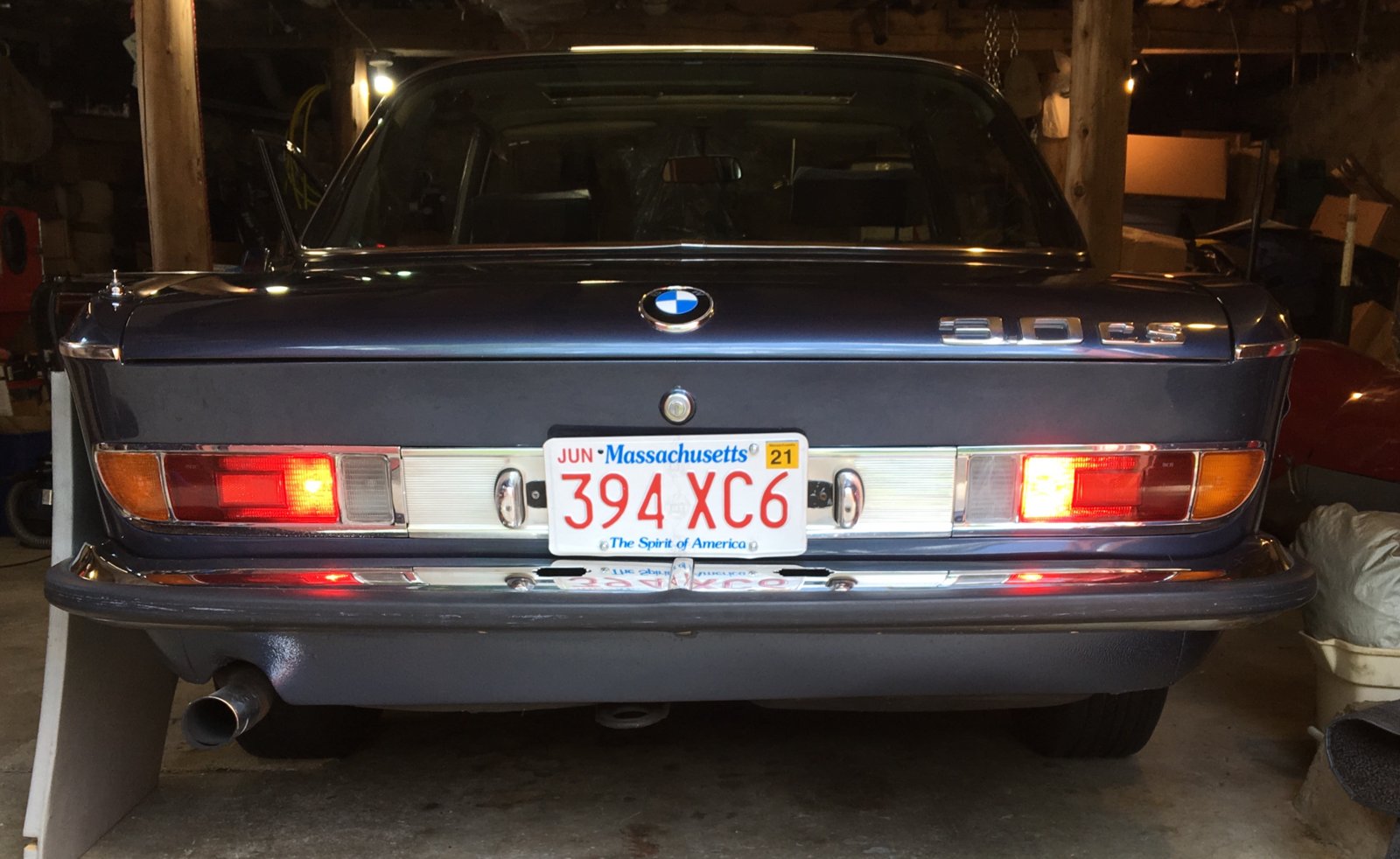

I bought the bulbs via that link and tested them last night. I put the LED in the driver side.
Disappointing - LED was much dimmer. Chris you dope!
Then I remembered the exhaust tip is below the driver side light, and undoubtedly that lens is spited up in the inside and the reflectors are dirtier and more corroded.
I pulled the pass side light and sure enough the reflector was bright and shiny in comparison. I moved the LED to the PASSENGER side and put the pass incandescent bulb into the DRIVER side.
Ah... cleaning the lenses and shining the reflectors will likely make a bigger difference than the LEDs
