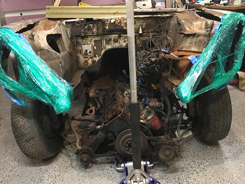

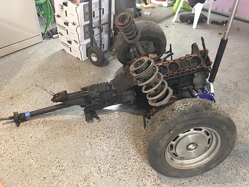

Are you trying to keep it rolling? If not, you can remove the usable parts up front then cut the radiator support. Then roll the drivetrain out the front without a cherry picker. That is what I did with my parts car. Keep in mind the wrecker will need to drag it onto the flatbed unless you put the subframe back in.
I did this with my parts car but there was little that I didn’t keep or sell.

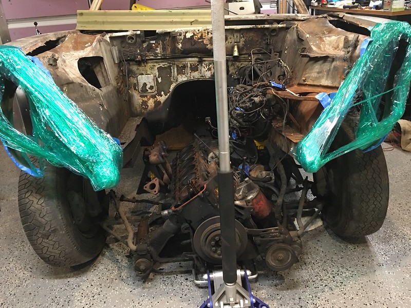

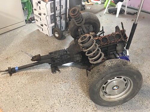

Great photos, thank you Markos. Yes, I think about cutting that entire front away, I am so close now. But yeah, I also think about how to dispose of the remains when I am through. I do want to keep the wheels, some old Riken mesh, that happen to match what's on my Coupe. This makes me wonder about all the creative and ingenious ways others have extricated an engine/gearbox outside, under cover. I do have some ideas.
