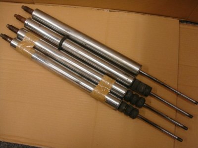

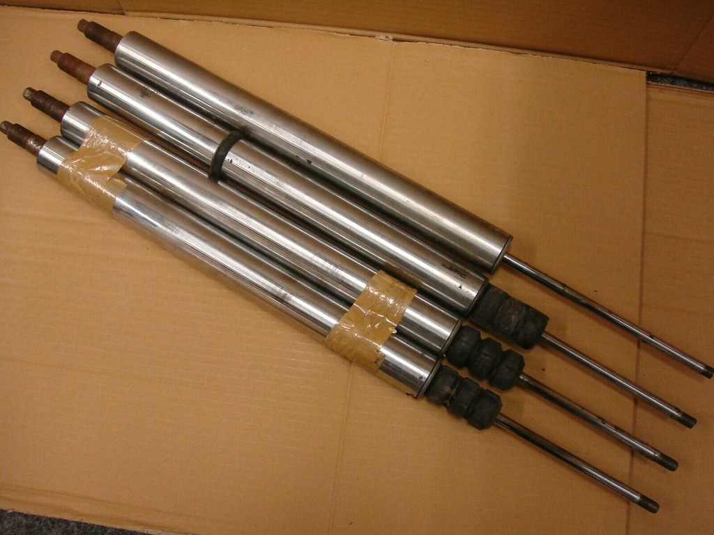

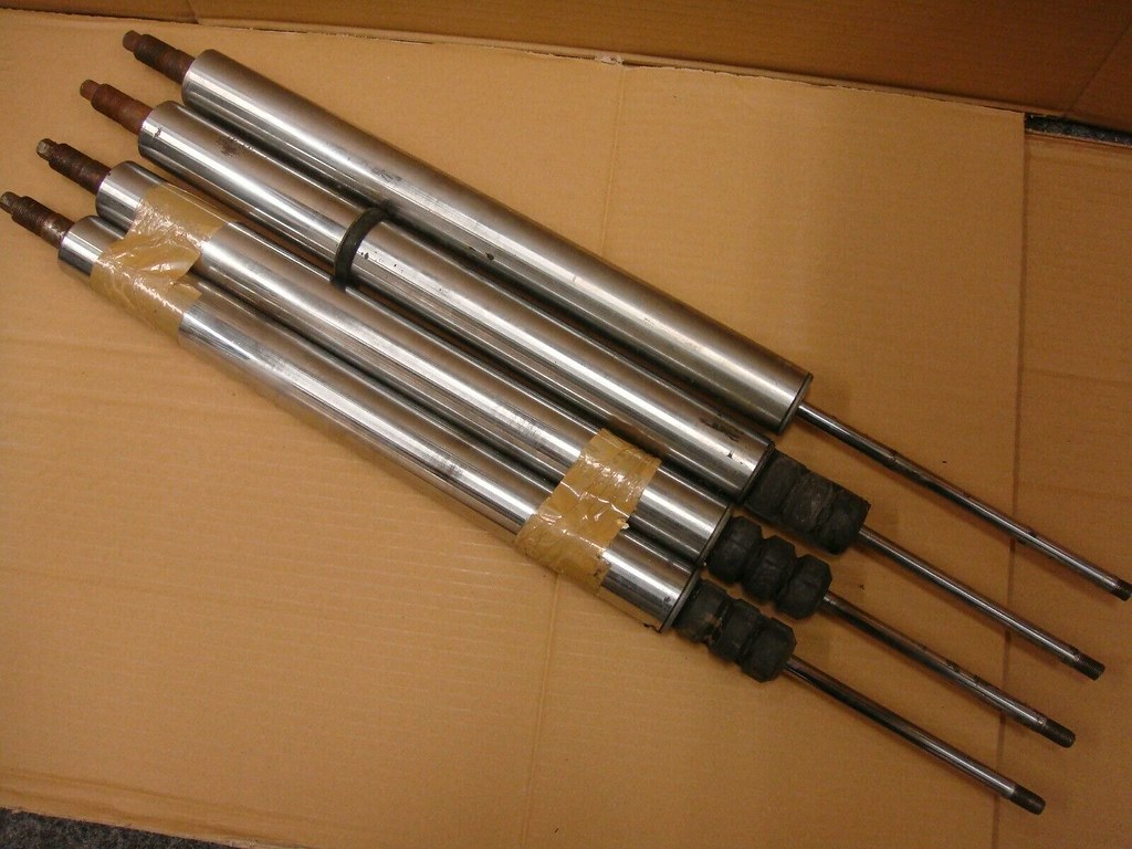

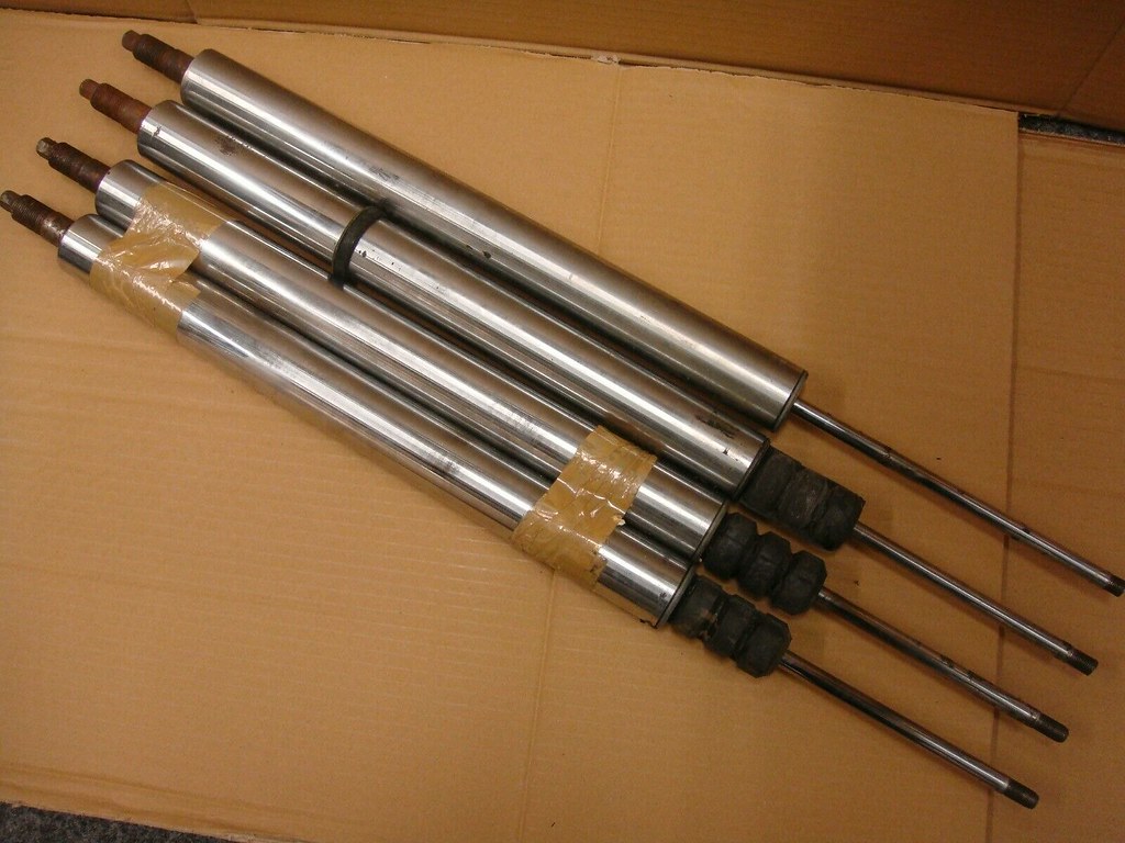

I have four struts, but two have their threaded ends cut a bit short. I think you should keep on the hunt for new first. I’m confidenf that are available, and frankly a bit annoyed that I bought used ones.
Another option is that talk to some MK1 escort shops in the UK. The escort RS used 300mm by 40mm monotubes. Too short for your application but they may have the contact that you need to order.
Here’s mine. My presumption is that I will ultimately just buy new (after you do all the leg work to find a new source of course!) :D

Markos, thanks for you help! It's of great value. I'm pulling strings and I have contacted a "High up in the chain" manager at ZF who hopefully will put me in contact with someone with influence at Bilstein. Germans help themselves at corporate level. I hope to get answers soon. I'll keep you posted. Another possibility would be to buy those cut ones you have. Would you interested in selling them? I would get them welded (an extension) and then rethread them...not to complicated if you find a good craftsman. Then send them to be restored to Bilstein, but this would take quite some time.

If you get a hold of bilstein and they can rebuild the body and replace the shaft, I’m happy to sell two of mine. I just think they are available new.
