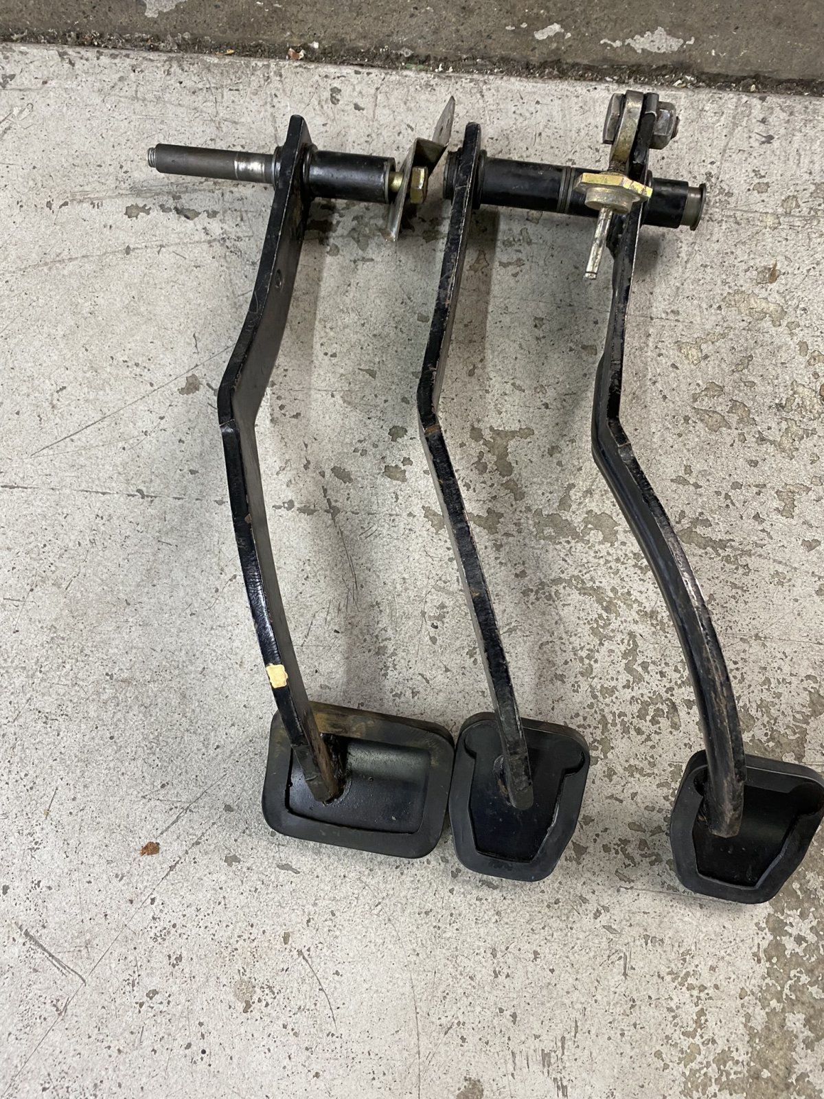

I have a bunch of parts for a manual pedal assembly. I will send photos of what I have later today.
I know I have a complete set up for a 2000CS which should be the same as one for a Bavaria.
If there is any chance that a member could help with a parts number or a photo of the parts it would help.

Here are photos of what I have.

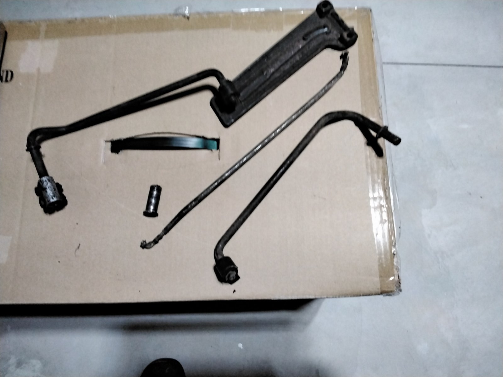

"youll only need the clutch pedal and the longer pivot bolt, not the brake."
OK..... Wait a minute.
"Longer Pivot Bolt".... Same pedal box on both manuals and autos. Same bolt on manuals and autos.
Is it the bushing you are describing?

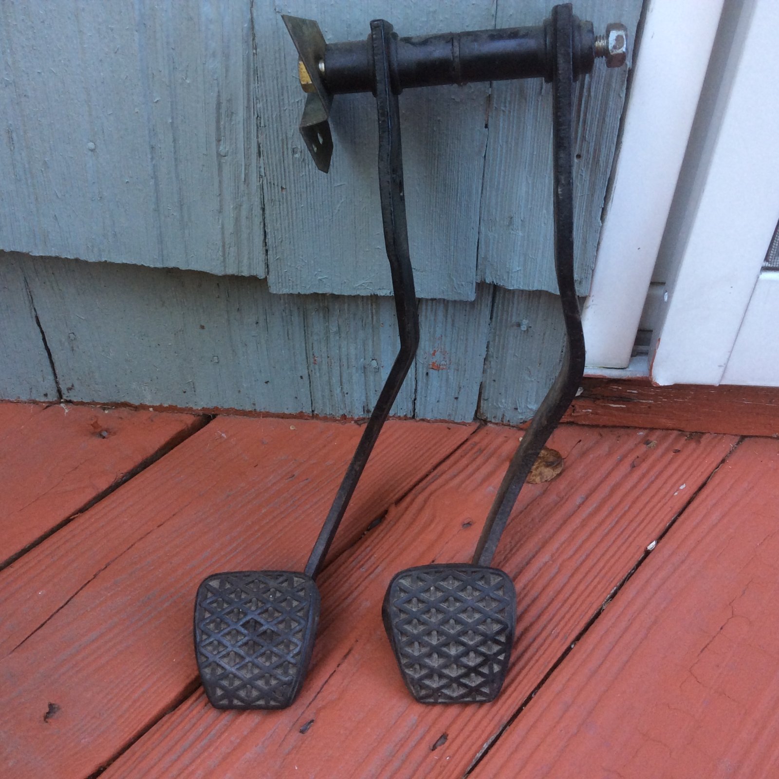

Hi. Hope this photo has the part you need.

Auto vs manual brake pedal pic
