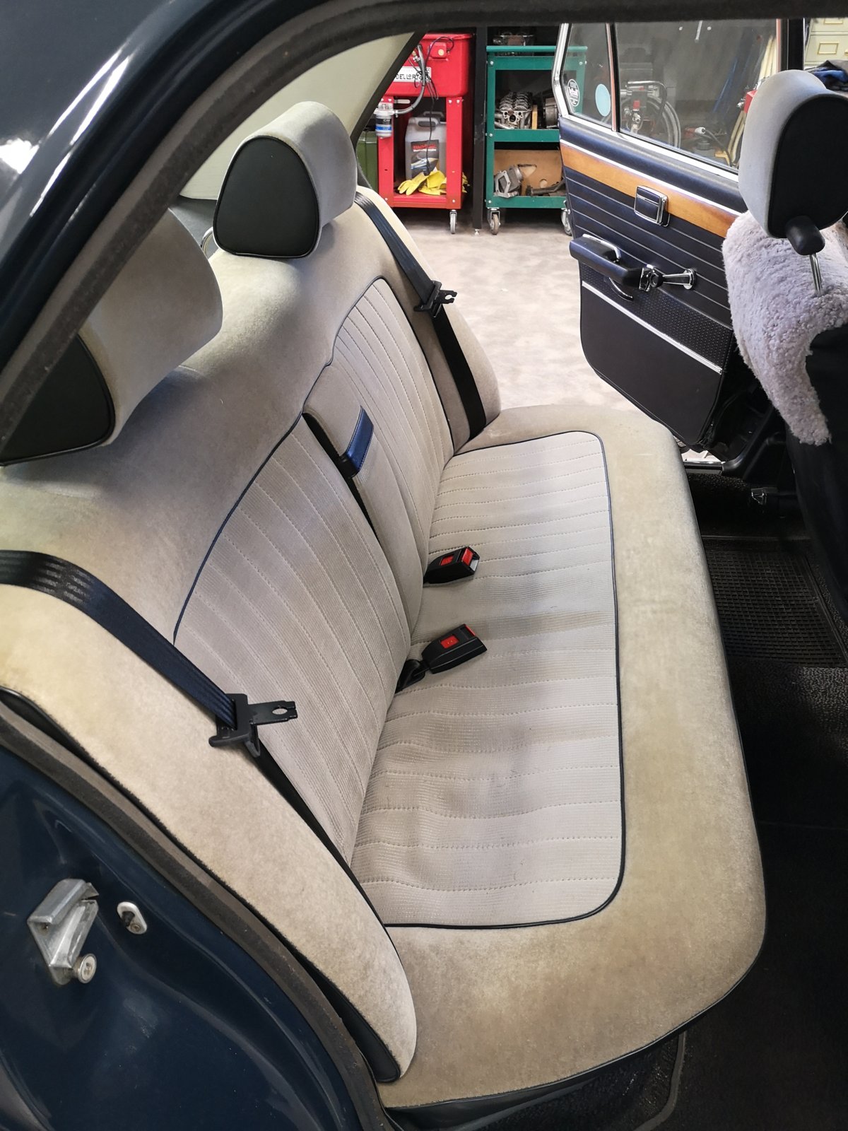

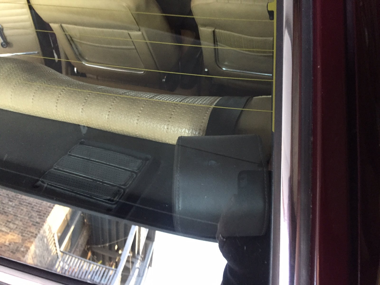

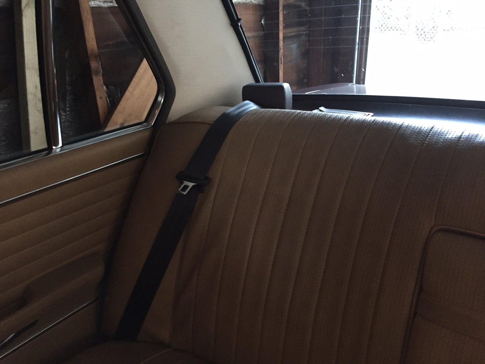

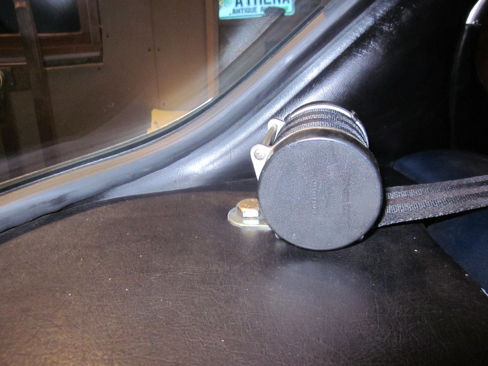

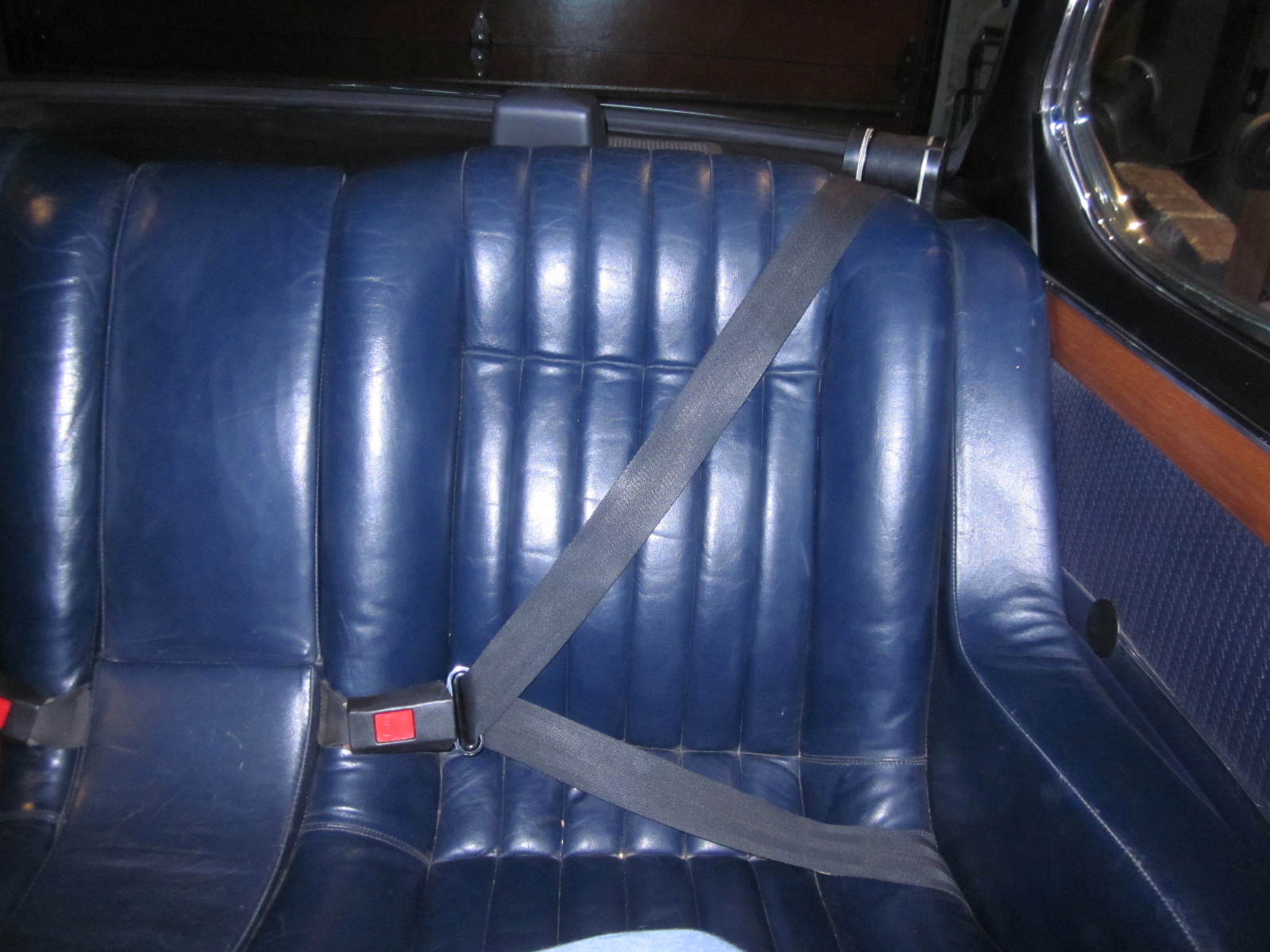

I added them to my '73 E3/Bavaria (US model) so I could put my kids in the back. I ordered the parts from QuickFit in the UK who are very helpful. My car did not have any factory mounting points for 3 point belts, just the lap belts in the rear. In the E3 there is not enough room between the rear parcel shelf and the wheel well to mount the retractor in the trunk, so you must mount the retractor on top of the parcel shelf, but it looks OK and can be covered in whatever color vinyl you want. I believe their process was to put a hole for a bolt in the parcel shelf, tack-weld on a metal plate underneath the shelf to spread out the force of the belt in case of an accident, and then bolt the retractor on top. The receptacle/latch uses the factory mount as does the outside hip part. Very happy with the outcome. Pawel at QuickFit can help with mounting suggestions if you have issues.

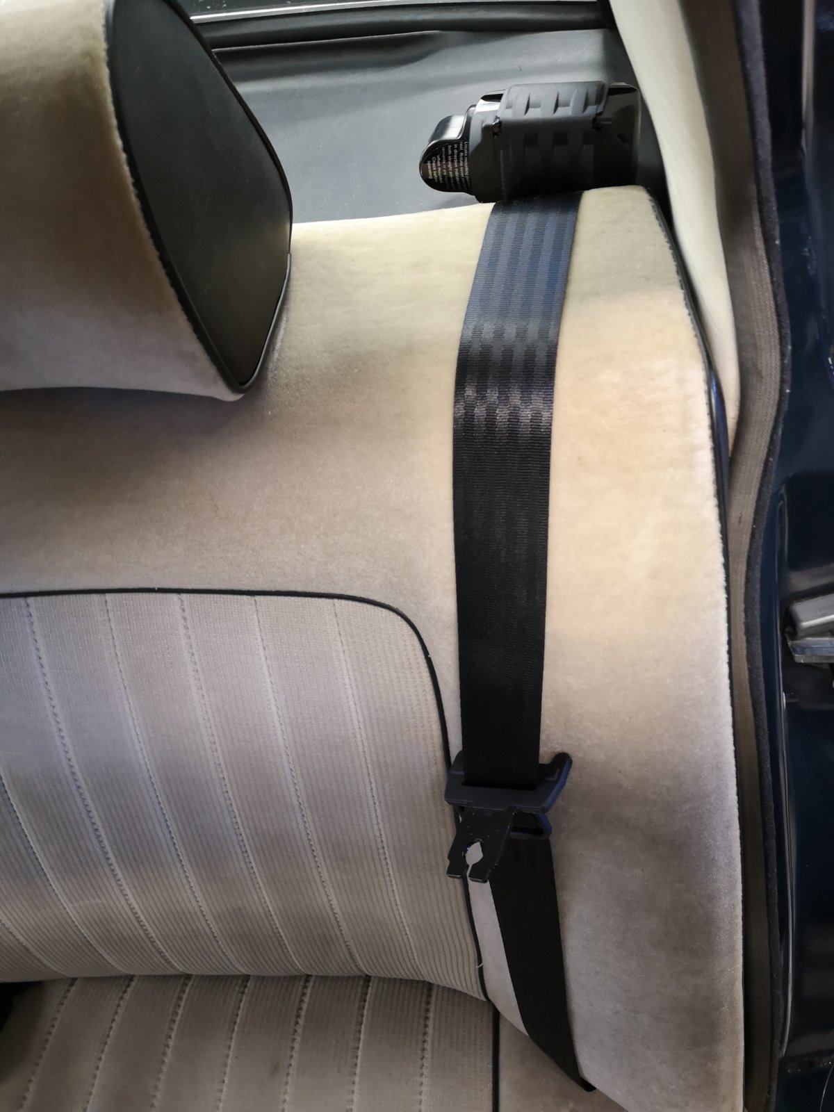

I recently installed 3 point belts in my e3 as well, there were no threads in the pre-existing holes on the parcel shelf, but that was solved by putting a huge! pretty thick washer underneath.
I bought Securon 254 belts, they're okay but I'm sure there are nicer alternatives out there, I was in a hurry to get the child seats installed in the back.

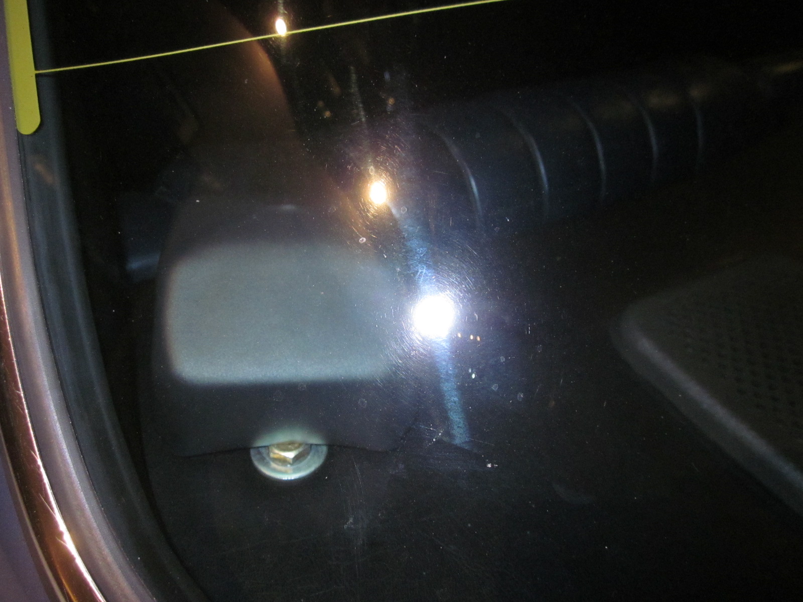

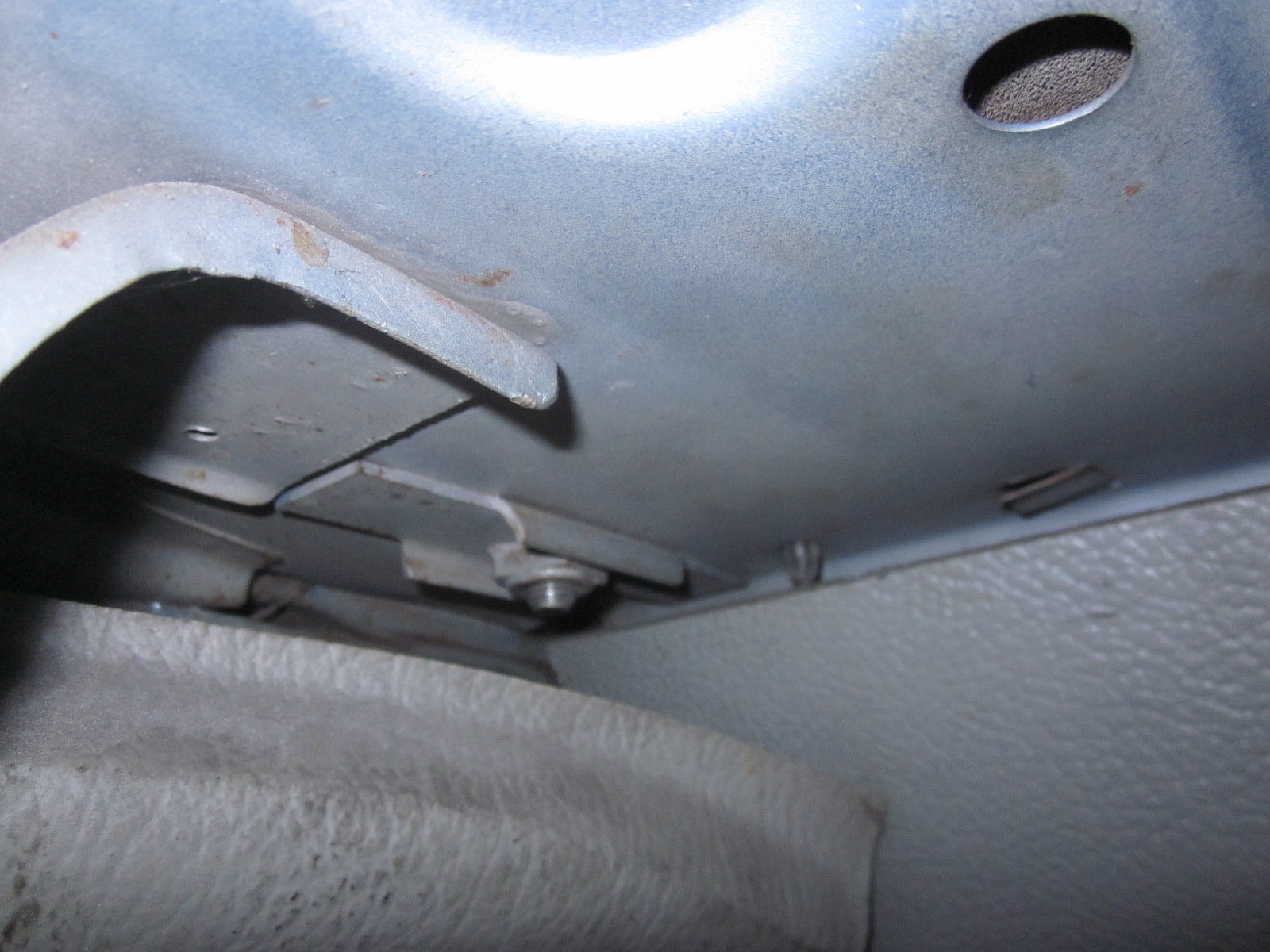

My 1973 3.0 CSi had rear 3-point seatbelts when I bought it in 2011. They were connected to a threaded mount visible in the trunk under the sides of the parcel shelf sheet metal. Does your car have these?
I would be happy to send you my complete rear 3-point set for a nominal price plus shipping.
