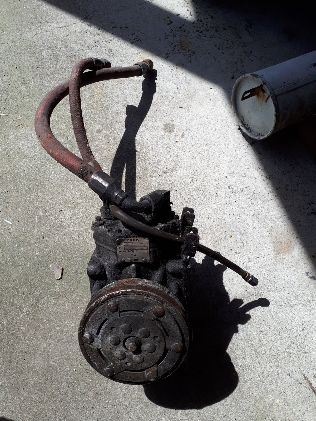

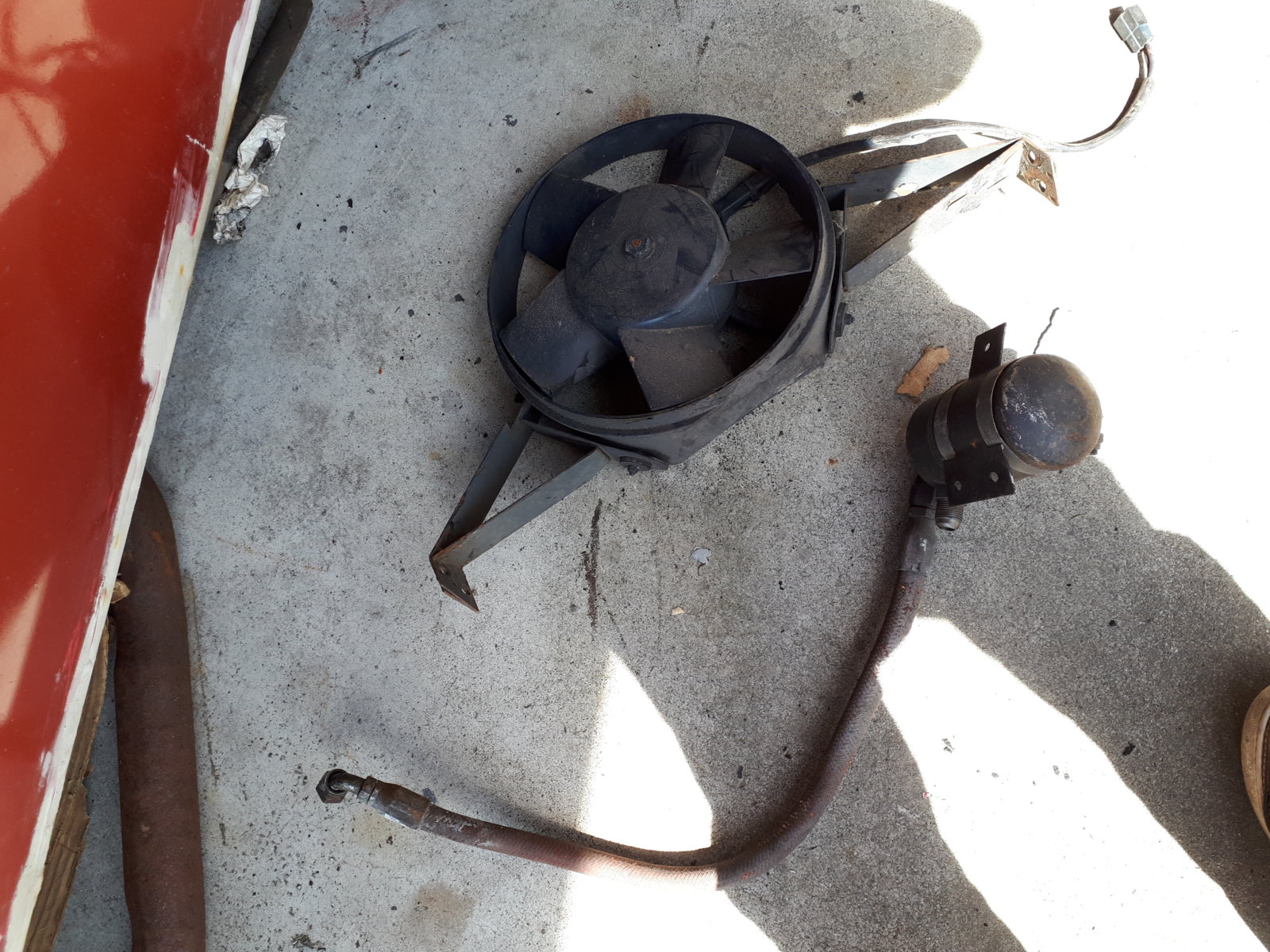

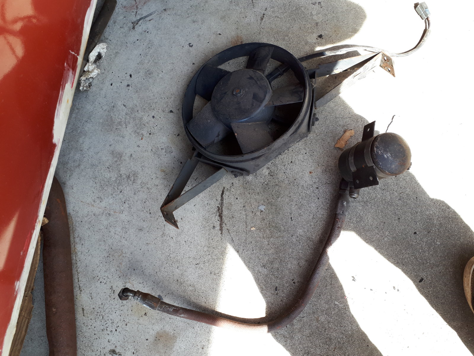

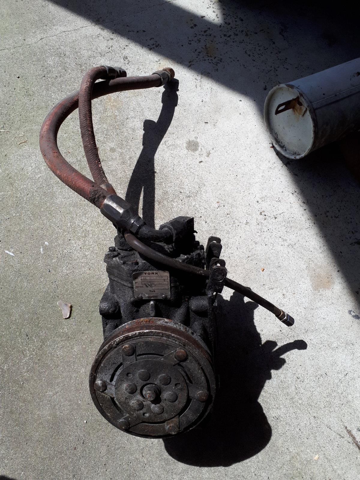

Does anyone have a source for the hard lines for the AC system? I need the lines that run from the Evap to the under hood hoses on a 71 2800cs.
Ohmess
I wanna DRIVE!
4,871
2,688
Aiken, SC

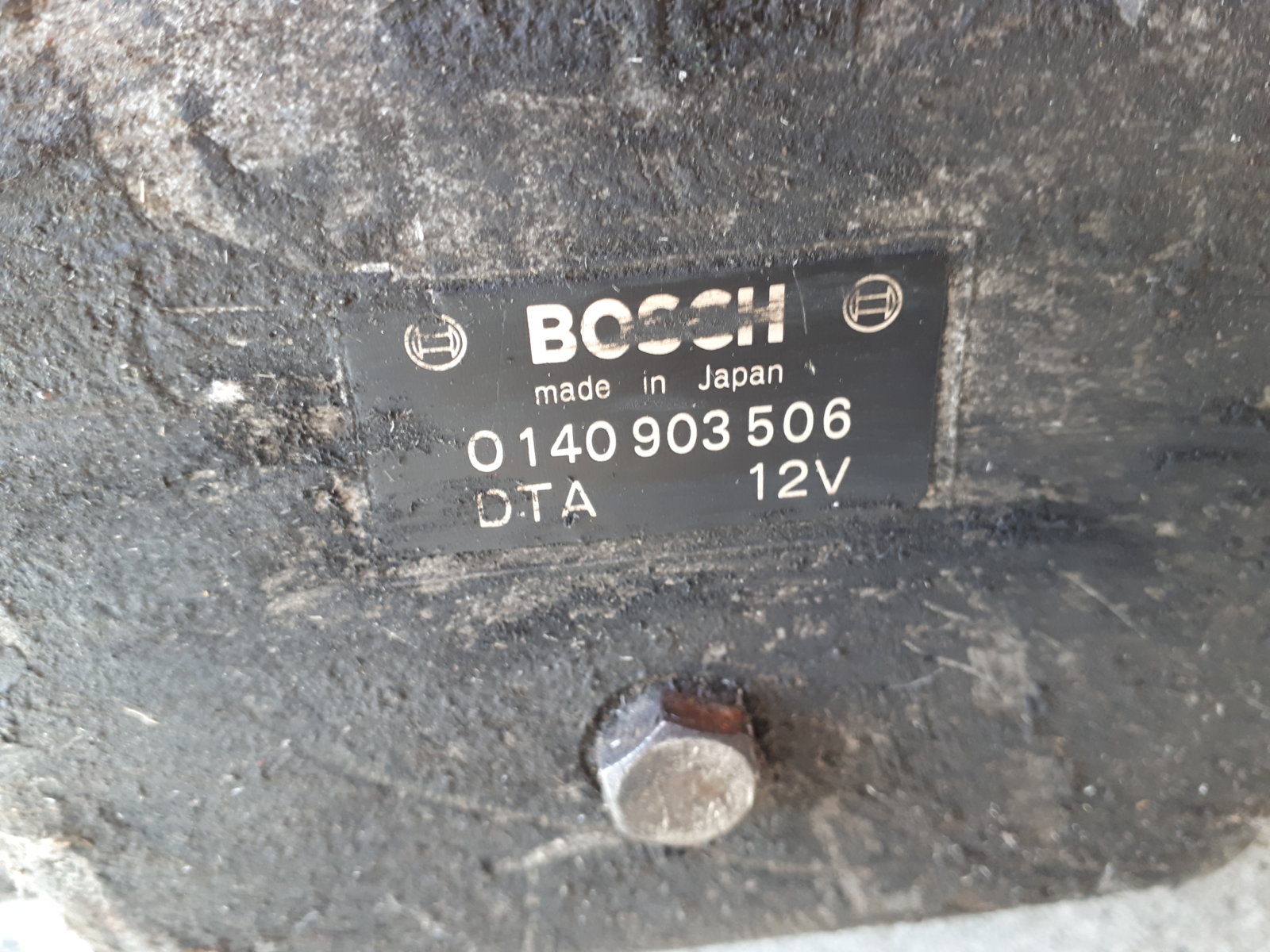

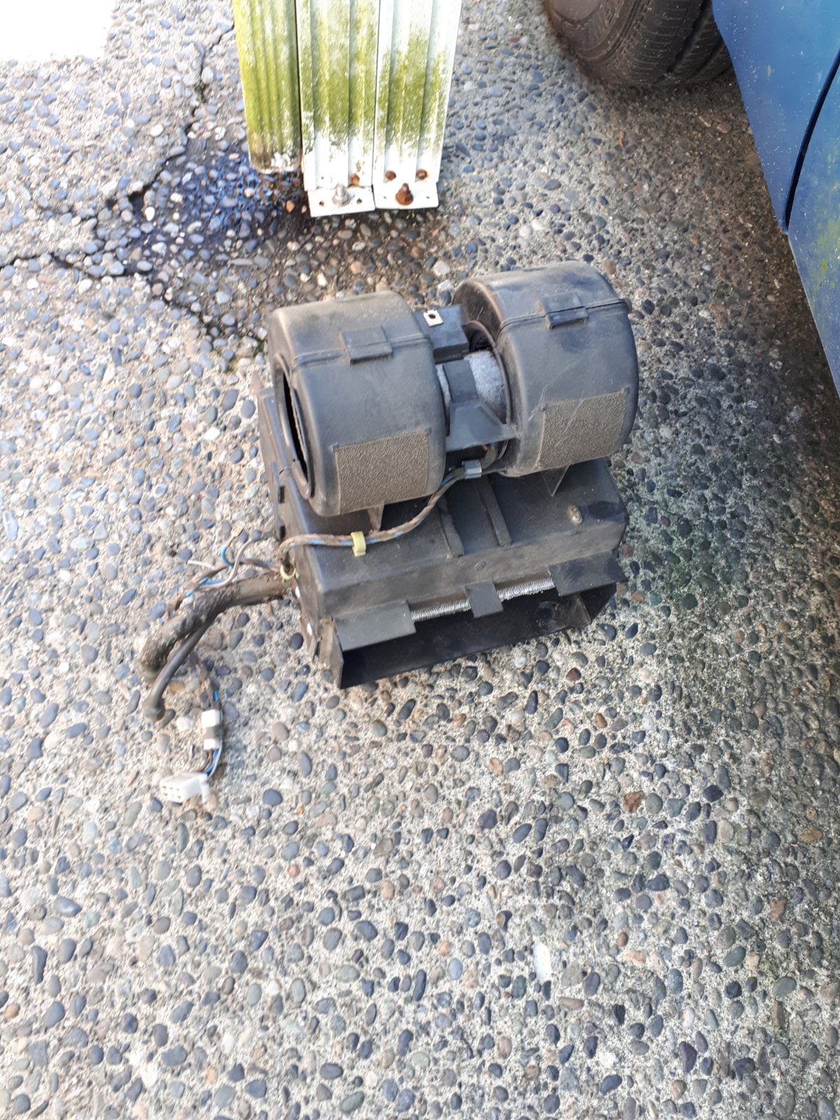

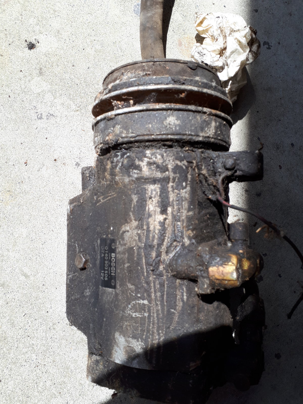

What do you want for the compressor? Is the bracket included? Feel free to PM me.
I hate to mess up someone's sale, but unless you are going super original, you don't want to use the original compressors. They were big, heavy, and inefficient. If you do decide to go that route, you will also need the vibration dampener (shown in the picture with the fan).
I'm open to options, just trying to piece this car back together. What do you recommend as a retrofit?
