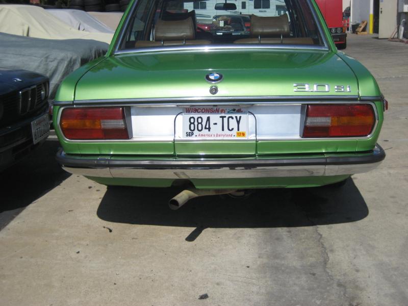

The exhaust pipe placement is a mystery as all Bavarias had it to the extreme right as seen here:
Or as in the late years 3.0 Si's, to the left of the license plate:
All of this doesn't mean it's not a good car, I just would want to know as much as I can about its past and all these clues tell you part of the story.
