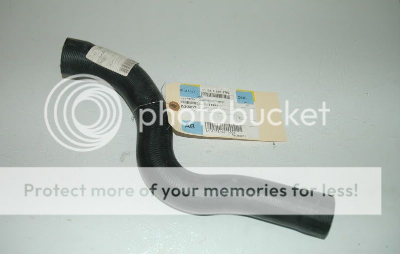

If you have a stock radiator and a Motronic distributor because of a conversion- only one hose will fit.....
You need the hose from a 633 csi build date from 9/81 to 9/82
Only 1 year hose fits and only that car got that hose.
01 Hose 1 09/1981 09/1982 11531268750
