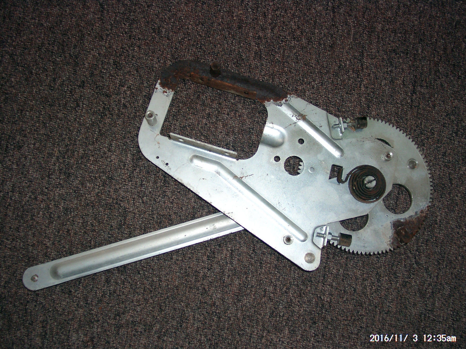

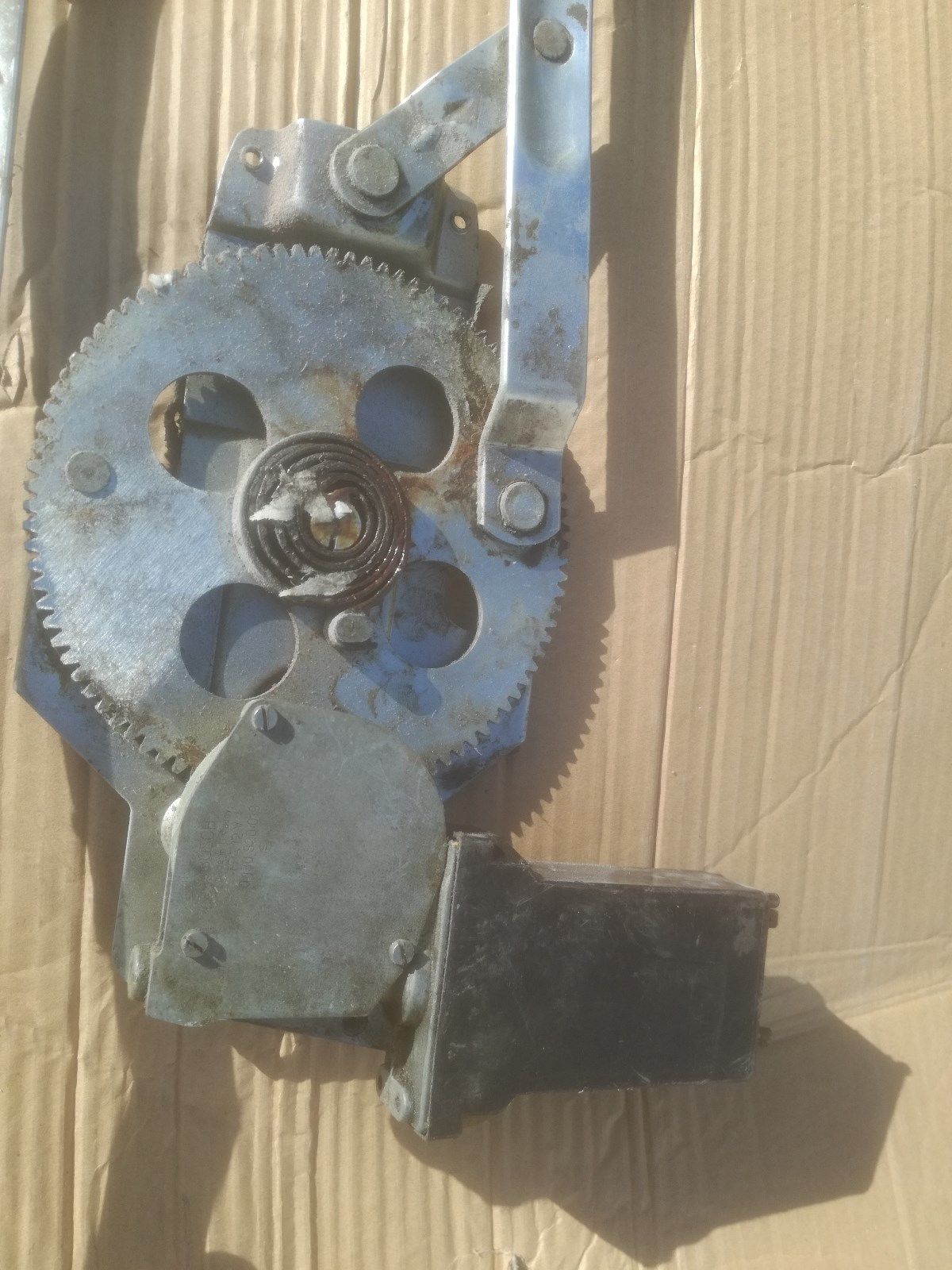

If you thought about converting manuals to power but using manual mechanism as base + adding: motor, gear, switch and cable - then it's not possible or will require tons of custom work that will probably cost more than good genuine power mechanism.
Depending on year of the car there was two versions of power mechanism early sardine style motor & later integrated motor with gearbox:
