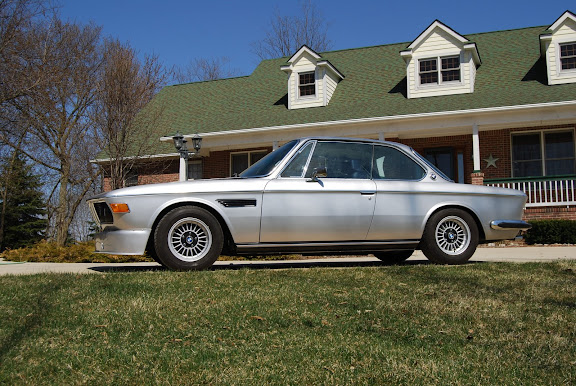

I finally mounted my Alpina wheels after staring at them for a couple of years.
I have been driving the car a lot lately now that the permafrost lifted in Michigan. I guess I will have about 2 months before it freezes again.
