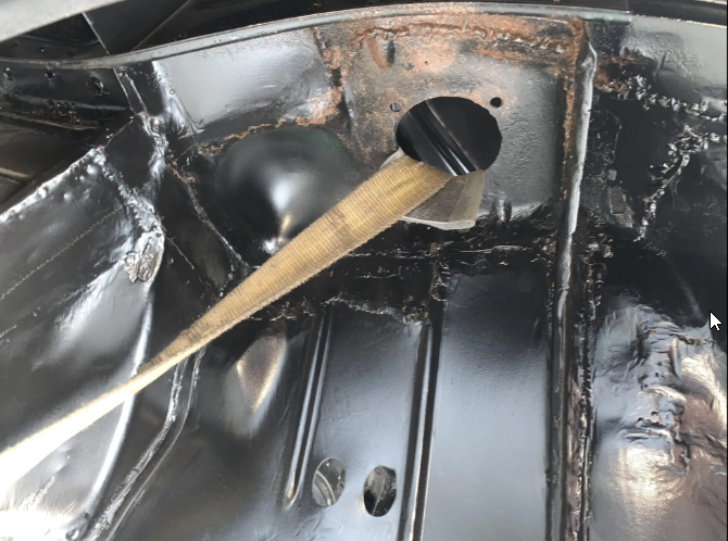

Looks like it was a high school body shop project.
That looks like a bunch of primates were given tools to beat on the car.

glad i am not on the wrong side of that 'project'. one would think they would try to show that they have some of the trim / interior and the condition that is in. that is probably the only thing that might be worth buying. i sure wouldn't want the shell. this car had to be in some kind of a serious collision at some point in its poor life.

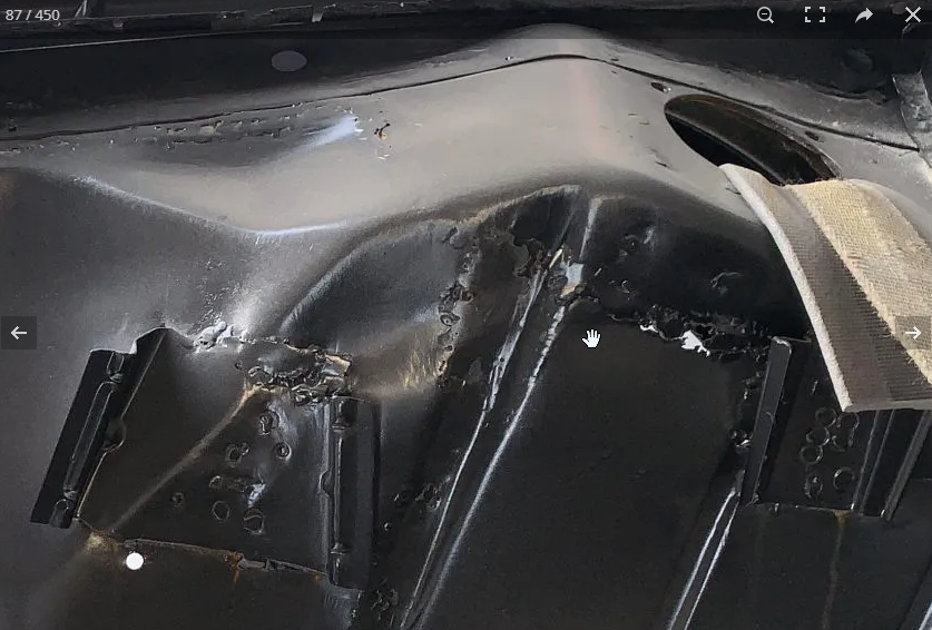

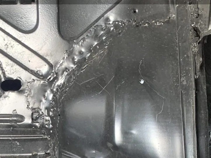

What the hell happened to the floors in the front?
There are no fabricated replacement parts for this section of compound shaped floor. This seller's solution was evidently to weld in some trapezoid shaped pieces of sheet metal and hammer stretch them into submission. If you could get the whole car onto an English wheel, one could smooth out that metal and you'd be surprised at how it might come out. But that is easier done before welding them into the car.

That thing will never be a roadworthy car. What a mess.
You would be suprised about what some true professionals did on one of my project cars.
A car the metal of which was mostly rotten, up and down, front and back.
It's just a matter of how much do you want to spend on it: on a car like this you must put on the table nothing less than 125-150k for a job well done.
Bring a new unibody....
Looks to me like the car took a good sized hit that was hard enough to buckle the floor

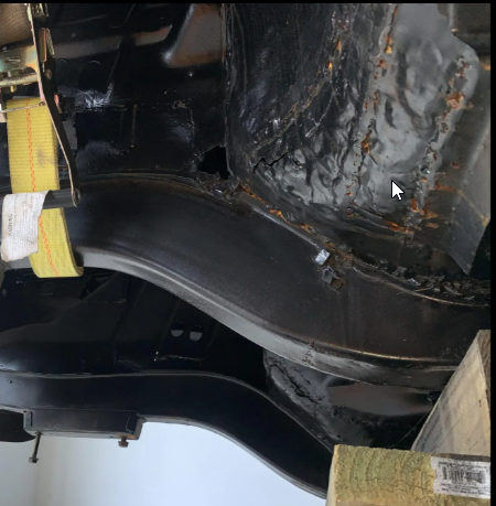

For it to look good, it needs to new rear quarters (decent used ones are included in the sale), and a new rear valance. And a lot of the 'work' done has to be cut out & redone.
My biggest concern would be that with this type of work, one can only guess what is inside /below the weld seams; how much rust is hiding still, or how quick it will start to grow back. Rust is already popping out from under the black paint...

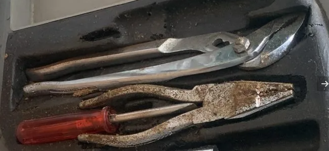

and he did get 3 of the more rare tools:
original red screwdriver with metal clip!
