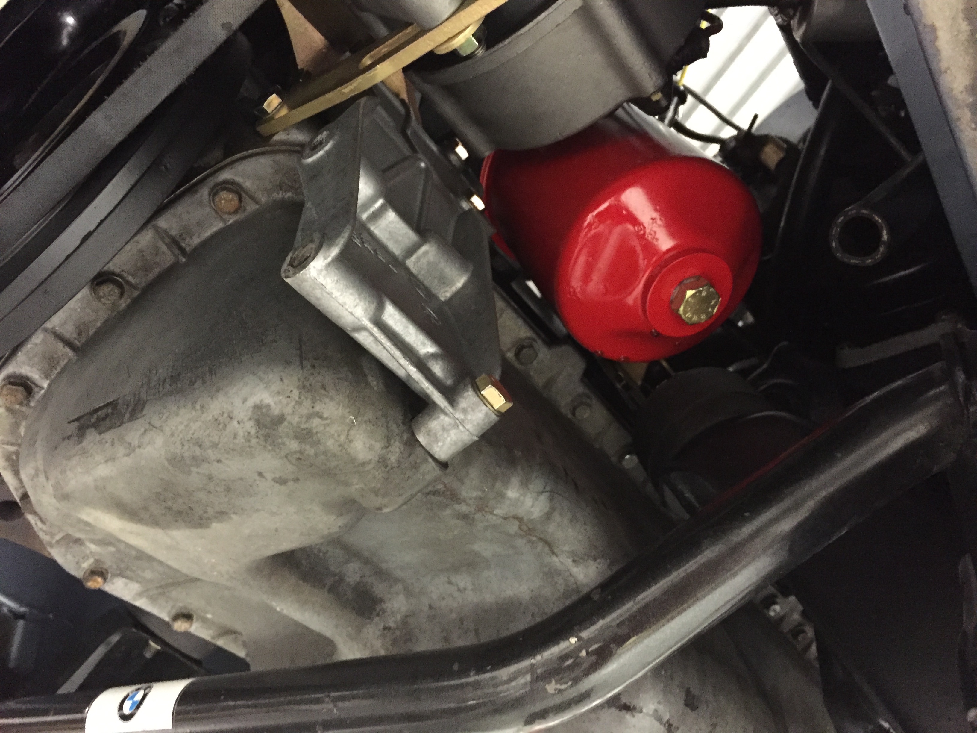

Well, I have a top bolt canister but I use a zip-lok bag under the can once the bolt is loose. Pulling upwards I push the PS lines out of the way as best I can. If your Alt still has external regulator unplug it from the back for a bit more room. The top bolt cans are fatter than the bottom bolt original canister.

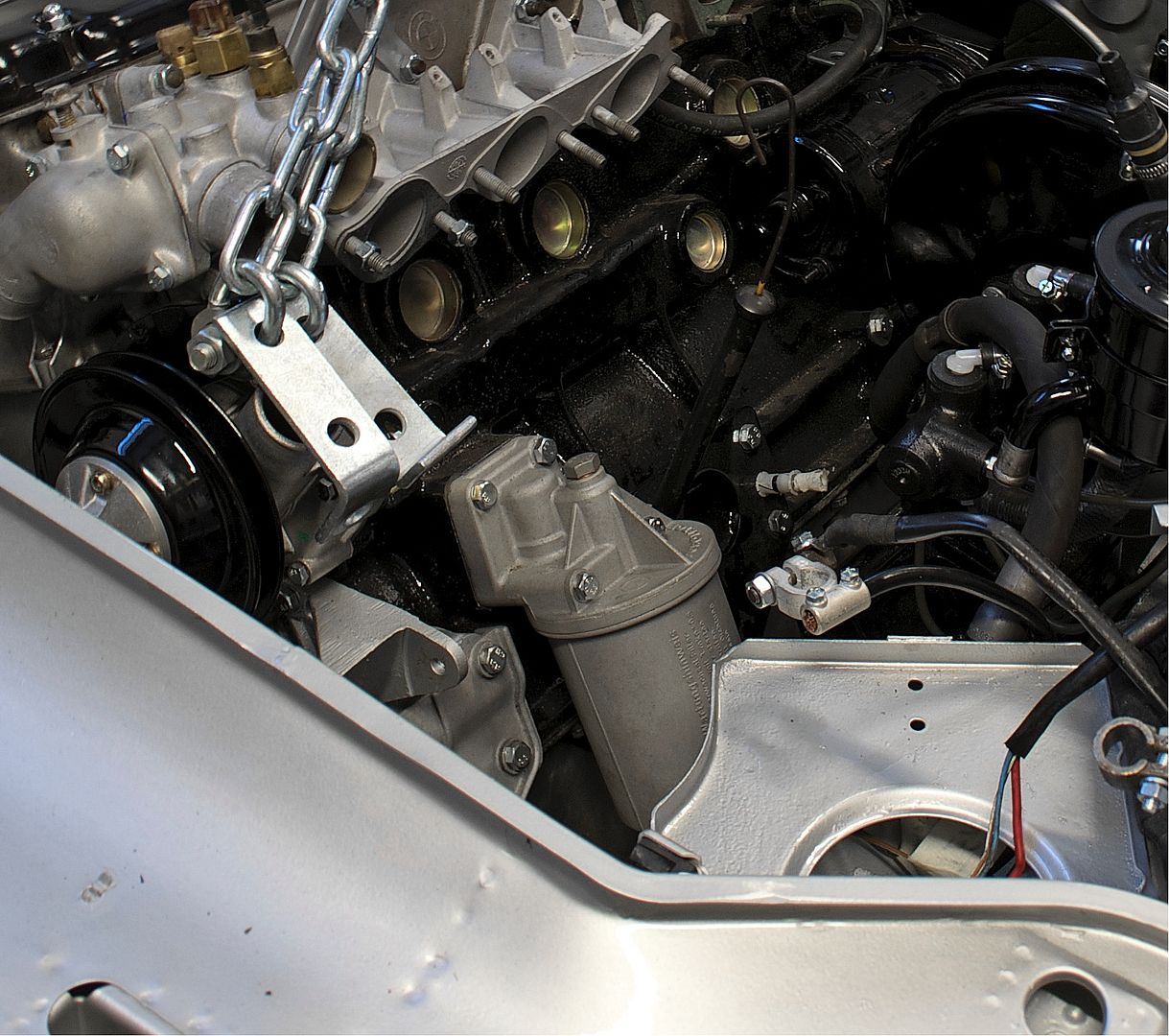

Since I'm a visual learner can someone post pics that highlight the difference between the orinal oil filter setup and the newer style?
This is the original style bottom bolt canister.
My 72 still has the original bottom bolt canister. I always remove the whole 4 bolt assembly from the engine block and lift it out from the top (only minimal drips from the block to a drain pan below) and then empty and clean the canister in a separate drain pan.
My trick was to install the spin on adapter. Easier to change and better filters (royal purple or Mobil 1) available anywhere.
