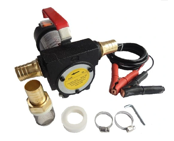

I have purchased a pump like below, 5liters of kerosene and plan to but another 5 liters of diesel (not done yet),
It is told to be 24V/12V compatible. In the comments section in the shop someone wrote it was to weak at 12V.
In the user manual I have read it is only for light oil and diesel fuel. It is forbidden to pump water and vaporous fuels (including gasoline/petrol).
the diameter is relatively big.
There is a filter but it is poor quality and not dense enough.

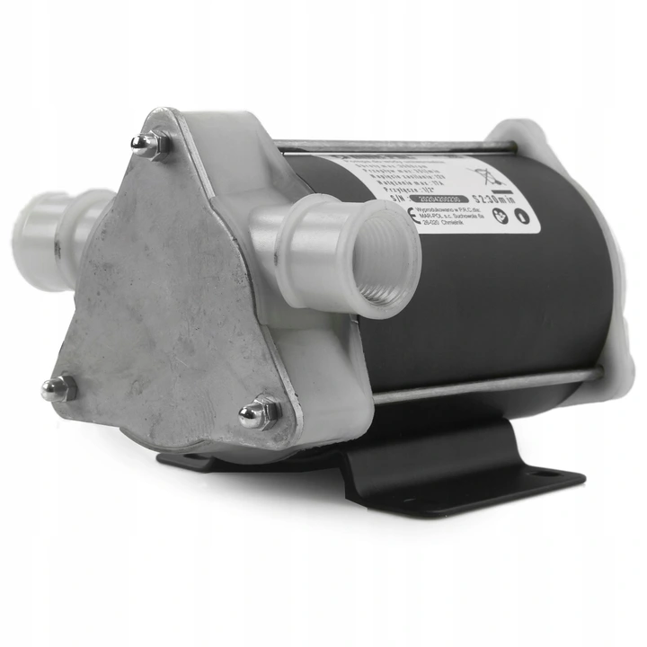

This pump is capable to go with water and gas:
Maybe because it has plastic impeller, not a metal, like the pump I bought.
Still wondering if not to return the pump as I had no time to use it so far. The one above looks to be more universal for the future.

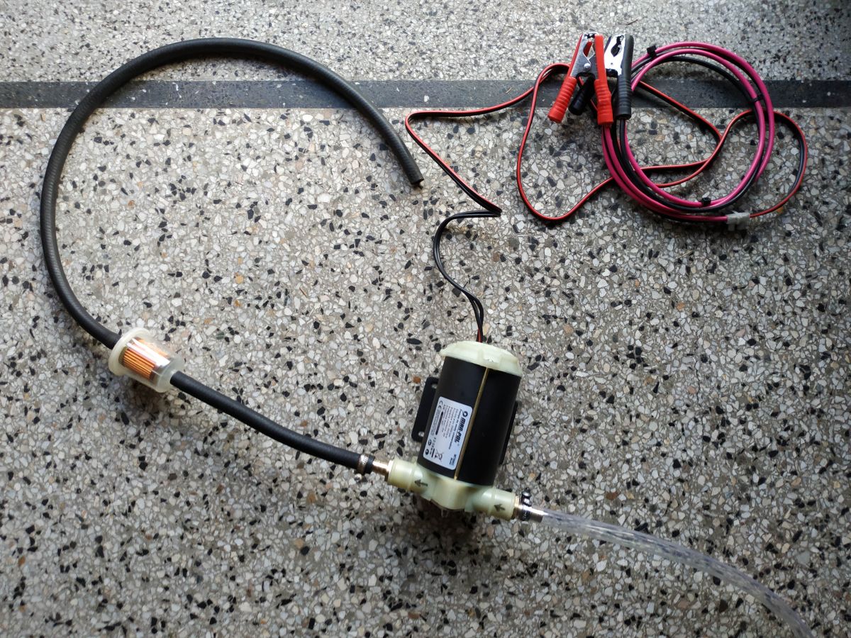

Here's the setup:
I'm very satisfied with the pump. It has plastic parts inside. The first I bought has metal internal parts which are prone to corrosion and sparkling (worst case but I prefer to avoid any possible risk).

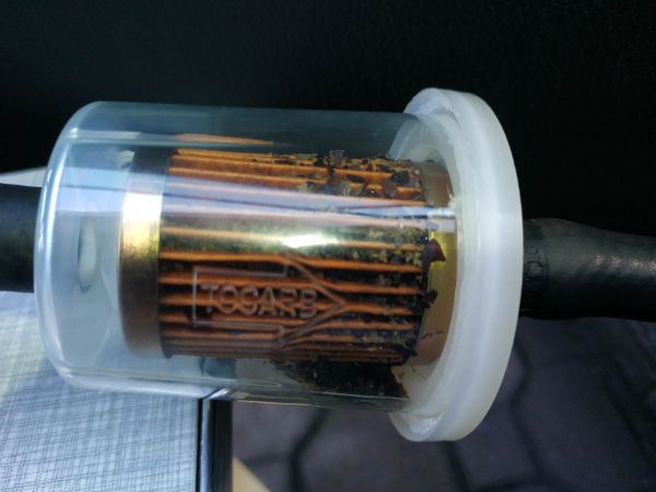

First run - mostly big particles:

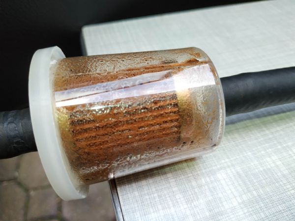

Some runs after (new filter) - medium mud:

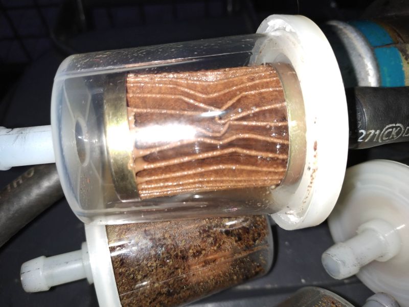

After few runs - dense mud barely visible but clogging the filter (visible deformation cause by presssure applied on the filter blocked by mud):
In the end filter was not blocking the flow.

It would be good to be able to turn on/off the pump locally (not by disconnecting the clamps on the battery).
Pump Speed/suction adjustment might be helpful in some cases.
LiON battery pack or motorcycle battery would make the setup more versatile. I used car's battery.
Pump is really fast. over 10 liters are pumped below 1 minute, so can be use to fill the tank from the container.
