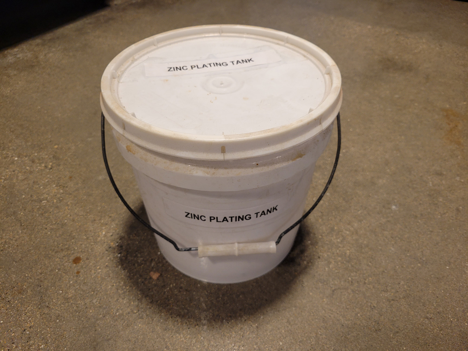

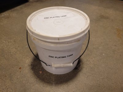

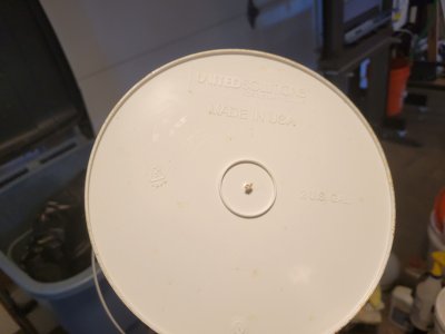

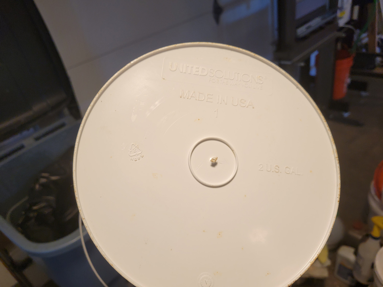

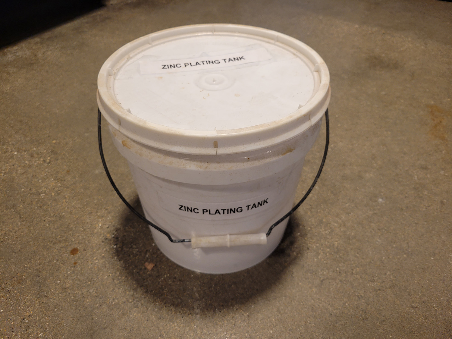

I have been plating my own parts with good results. Most of my system is based on Caswell, but there are a few tweaks. I have a 1.5 gallon system which lives in 2 gallon buckets. But I've had (3) buckets leak. These are nasty chemicals that can cause harm to my garage and/or those who hang out in it (me). All three leaks came from the exact same place - the 'belly button" at the bottom of the buckets. I have buckets from three different sources, and two of the three brands have leaked. I think it is only a matter of time before they all leak. I plan on setting each 2 gallon bucket within a second, larger bucket as a spill prevention technique. But I'd love to find better buckets - ones that would not leak at the belly button. I don't think it is the chemicals reacting with the plastic. Rather, I think the little nub pushes up on the plastic and eventually it cracks.
Does anyone have any recommendations for "a better bucket"?

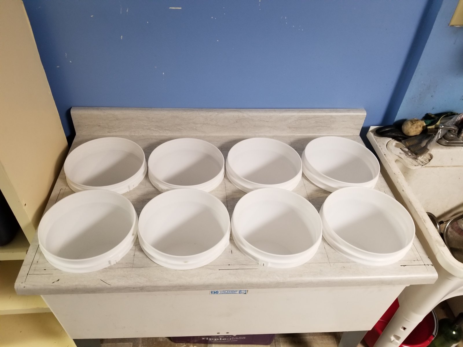

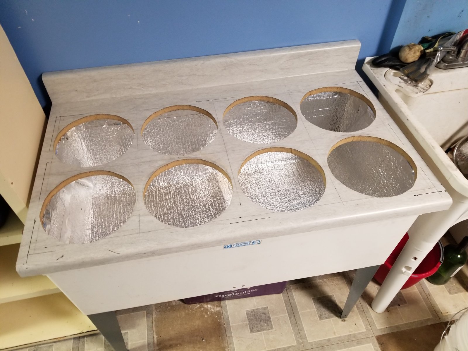

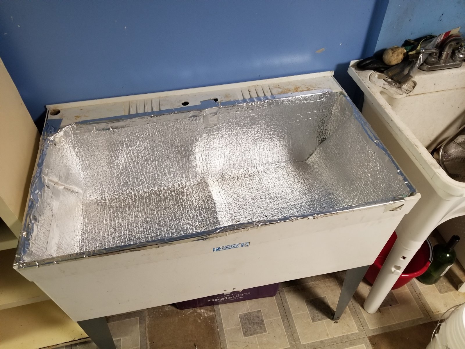

When we first started out making the side draft linkage systems (https://www.2002sonly.com/weber-dcoe-carburetor-family), I used the Caswell system and made a plating station with the 1.5 gallon buckets and a large fiberglass sink with the drain holes plugged. We insulated the sink to keep the chemicals at a constant temperature and, on the top, fitted a countertop with holes cut out to hold the buckets. This worked well until the volume of linkage systems we were making became so large that we had to start using a commercial plating company. Here are a few pics of the setup.
Very nice setup. I have contemplated putting a "station" together like this (the YouTube guy I mentioned previously had a similar setup). The only drawback is that it will take up a fixed amount of space in my tiny shop, whereas the loose buckets can conceivably be stacked and stowed in more corners of the space. But I may reconsider. That looks like a slick solution!

You might not need 8 buckets but we decided to use a separate distilled water rinse bucket for each step of the process.

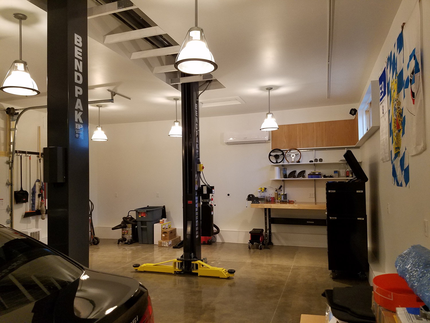

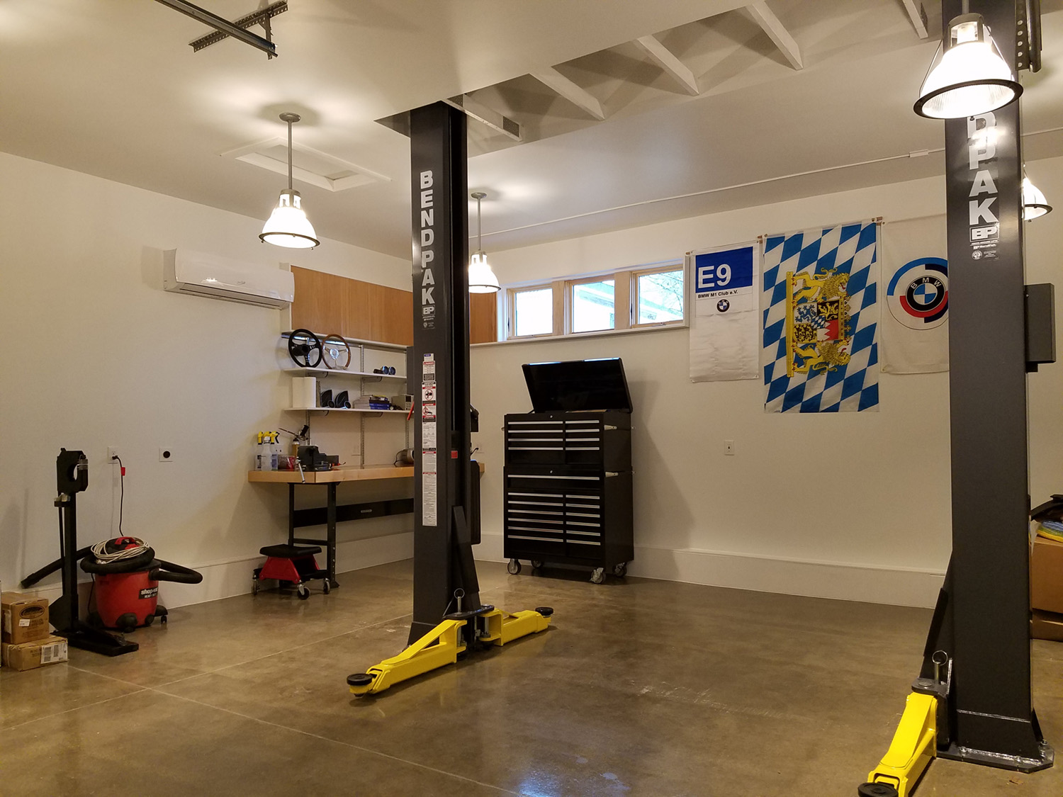

Hah, hah - fair enough (wise guys). ;) I certainly enjoy my garage shop space dearly. But don't be fooled by early, wide angled, mostly empty photos. I encourage you to take what equates to "almost" 2 parking spaces, bring in a car and take it apart, storing its parts along along with (many) spares. Add a work bench, tool box, compressor, various rolling tools, metal fabrication tools, engine hoist, engine stand, some "garage items" that your wife insists don't fit where she parks her car..., and then consider inserting a relatively fixed object that measures at least 24"x48" plus some circulation/working space. I wish I had the extra real estate!
That said, I might finagle a utility sink setup on wheels similar to Hal's. If I can place 8 buckets and have 4 add'l rotating chromate buckets, the safety and convenience of not crouching on the floor may outweigh the lost floor space.

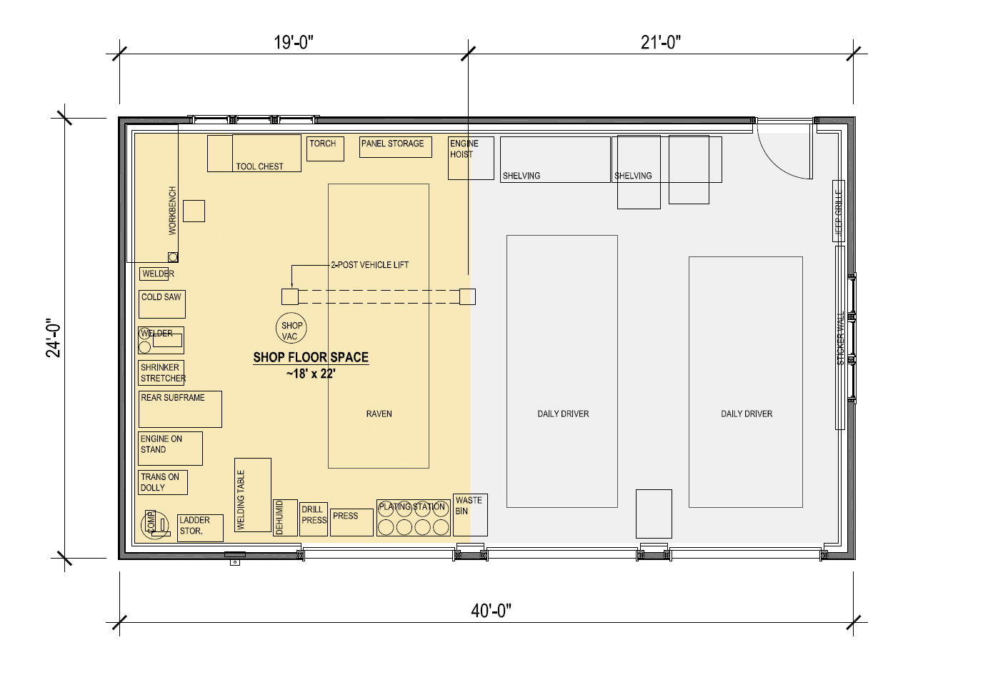

Do you mind sharing the size of your workspace? I'm on the cusp of building a 1+ garage bay on the end of my house and am trying to finalize the size and cost. Ideal wishes are bumping up against budget and setback constraints.

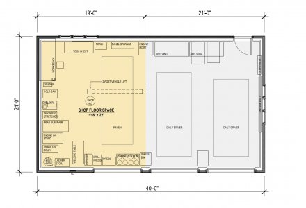

Not at all. I've attached a plan of Raven's Nest. As you'll see, almost half of our 24' x 40' structure is my workspace. The floorspace of the work area is approximately 18' x 22'. The equipment and storage is illustrated as well (including the proposed plating station). I think anyone ( @Markos ) would agree that there's not a lot of floor space to "work" in. More than some but less than others for sure.
Not sure about your area, but construction costs are as high as ever right now. It is a tough time to build - hard to see the value. But that doesn't seem to be slowing down our clients. Much of the cost is in the excavation and concrete. Of course, building larger will cost more, but the mobilization costs and the ticket price to get underway is a majority. Which is to say, build a little bigger if you can. You'll be thankful later.
