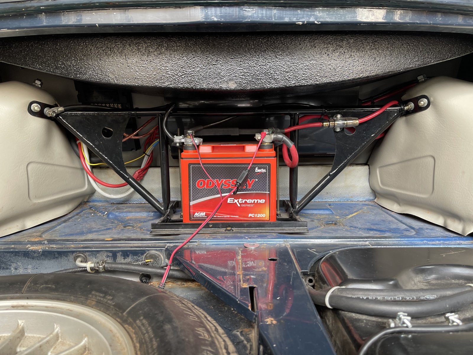

Perhaps do a trunk mount. I use an Odyssey battery, which has worked fine for six years. Note: don't let the battery run down or it dies deader than dead. . . ask me how I know (I leave the trickle charger connections on to remind me). The battery is 20cm by 17cm by 17.25 cm which is small. The battery has 540 cold cranking amps and does a good job starting the car.
