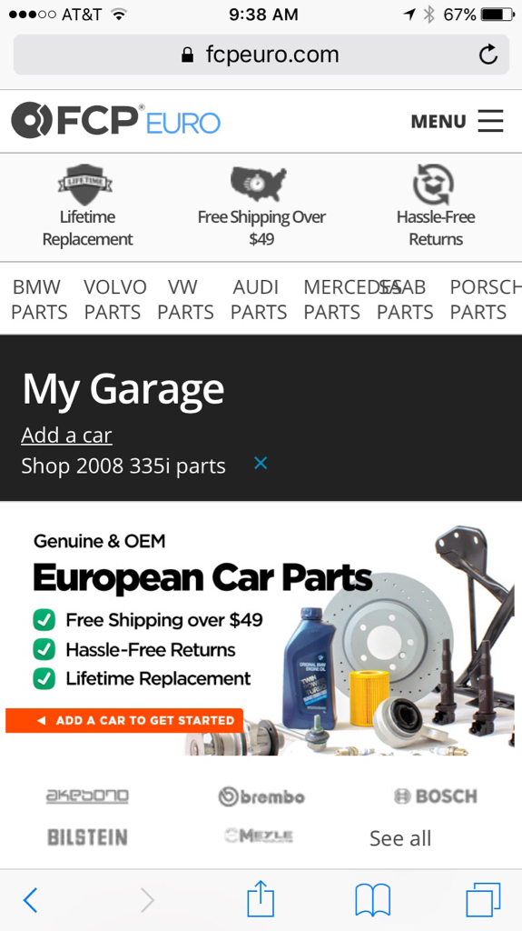

  11. BarryG
    BarryG solo e9 Site Donor
    Messages:
    742
    Likes Received:
    28
    Trophy Points:
    28
    Location:
    Nor*Cal - Rocklin, around the corner from Dan
    Ecpeuro
    Have you tried them
    [​IMG]
  12. m5bb
    m5bb Well-Known Member Site Donor
    View My Garage
    Messages:
    1,118
    Likes Received:
    37
    Trophy Points:
    48
    Location:
    Peachtree Corners, GA
    Yes, I've bought parts from them but nothing I had to return for warranty. I should ask them how they handle that since BMW's policy now is like I said in my OP. I also get better prices from BMW than I do from FCP?
