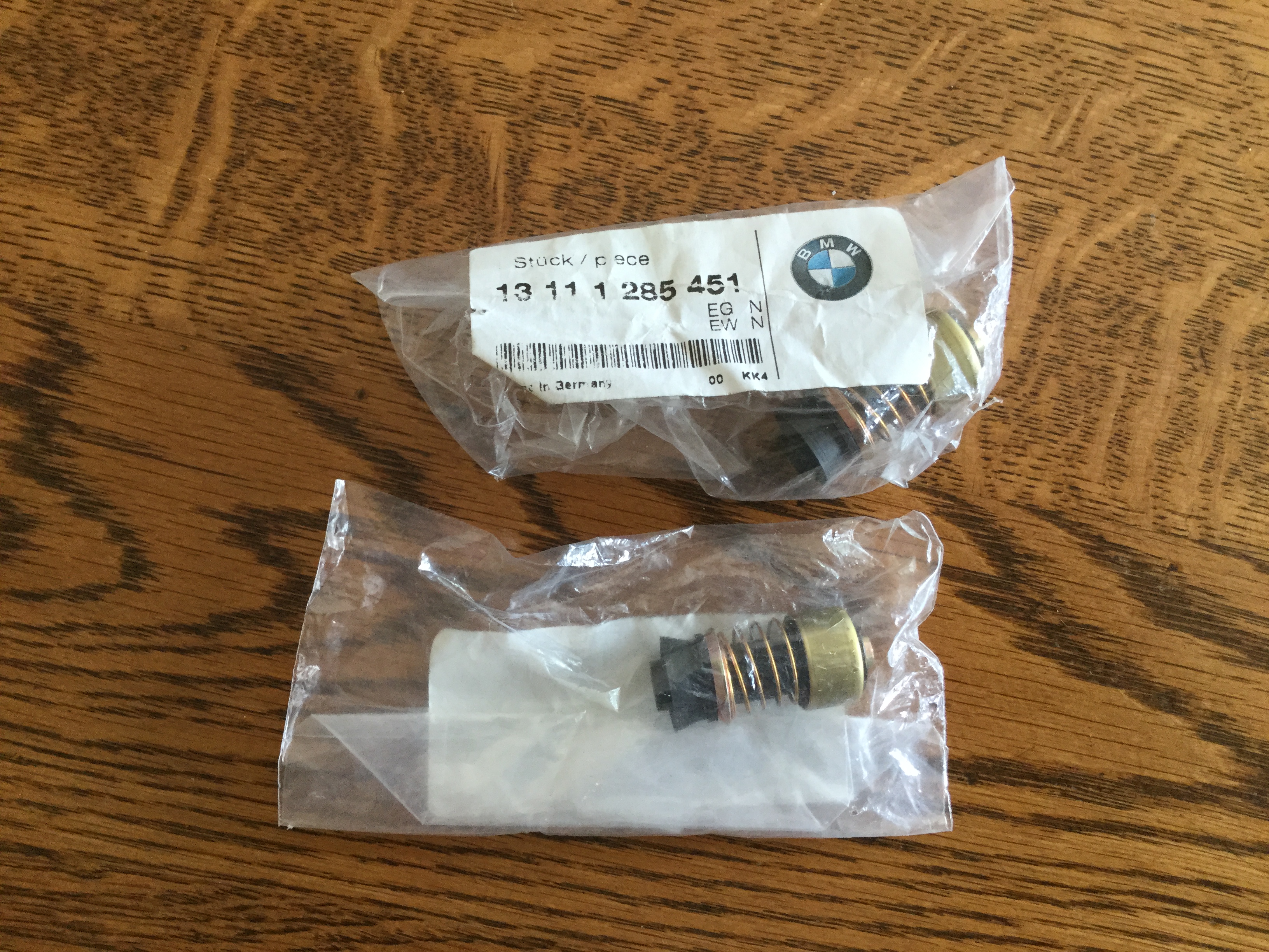

The Zenith rebuild kits don't come with the accelerator pump, our 2800 wasn't responding quickly. Carl Nelson had a pair that I plan to install. He said BMW didn't have any in the US, you should order a pair.

Thanks Chris. Jeff at Paltech said he gets his rebuild kits from Germany; I'll check to see if they include the pumps.

The pumps also have a mercedes part number which show up in more sources. Grab them if you can find them, they arent easy to find and invaluable for proper operation. Becareful installing, it's easy to tear the rubber skirts.

My Zeniths still had the leather accelerator pump cup. Even the service manual that was out a few years after my car was made states that the leather ones should be replaced, so it looks like my carbs have never been touched. The kit I got had replacement cups, but not the full pump assembly.

Just wanted to follow up; Zeniths at Paltech now, should have them back in a few weeks. Will post pics when they arrive. By the way, Jeff includes new pumps from Germany, and they are available from Germany for $37...
