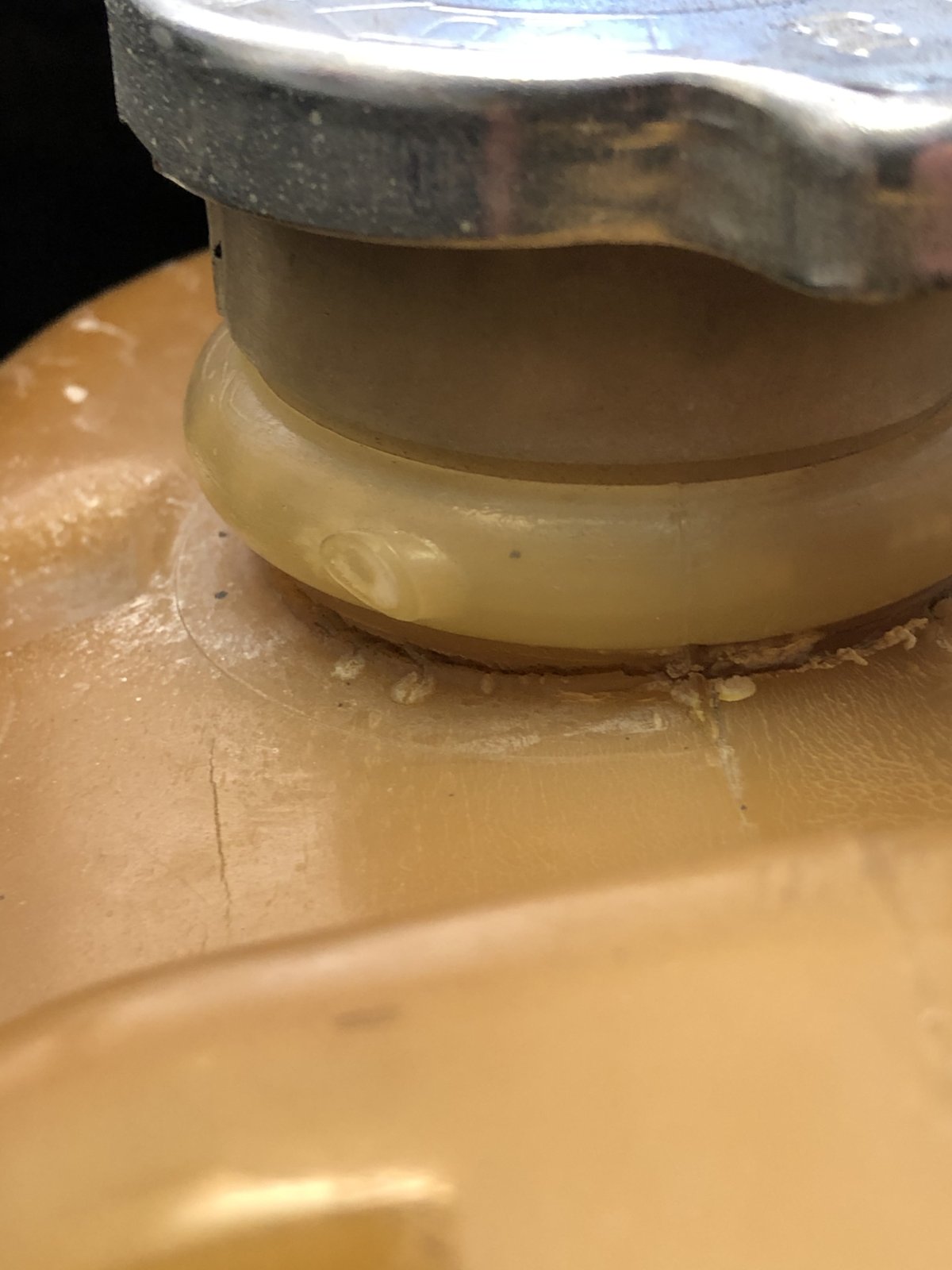

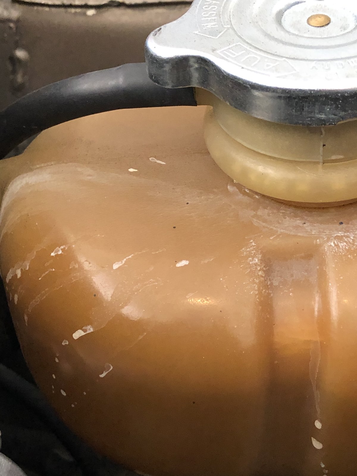

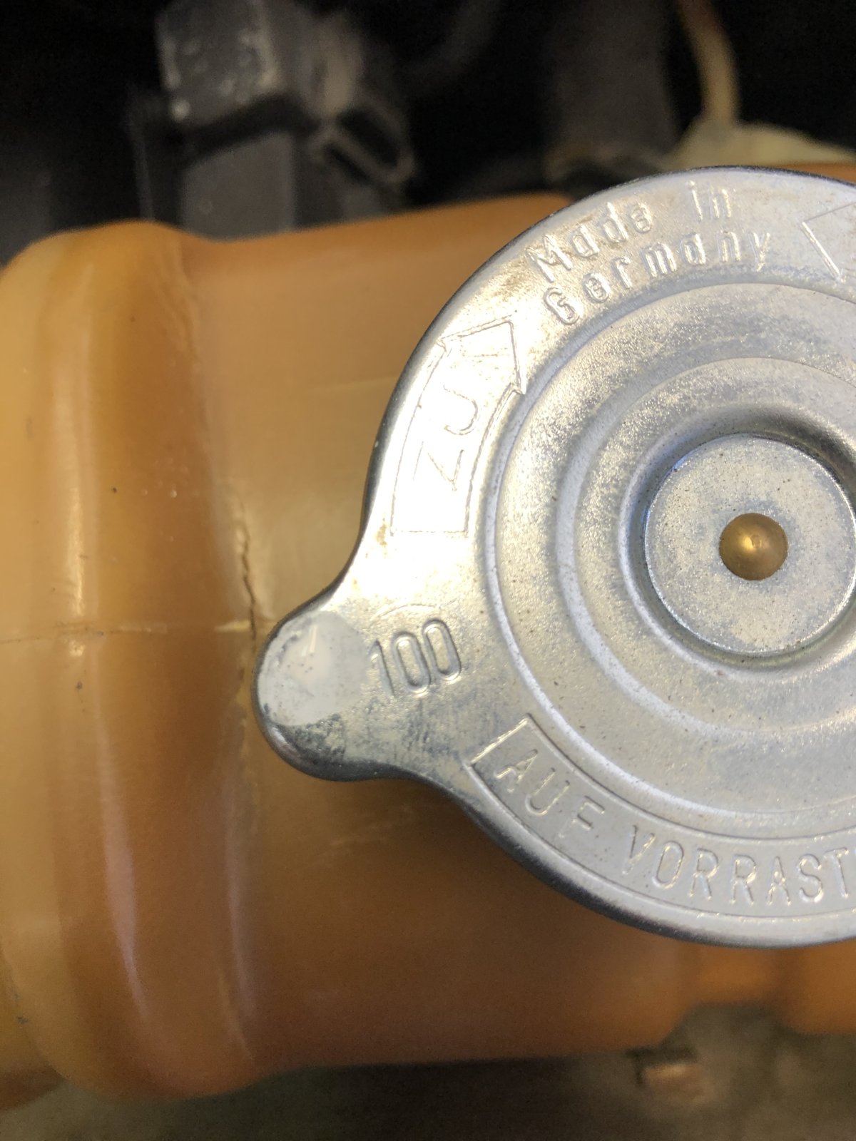

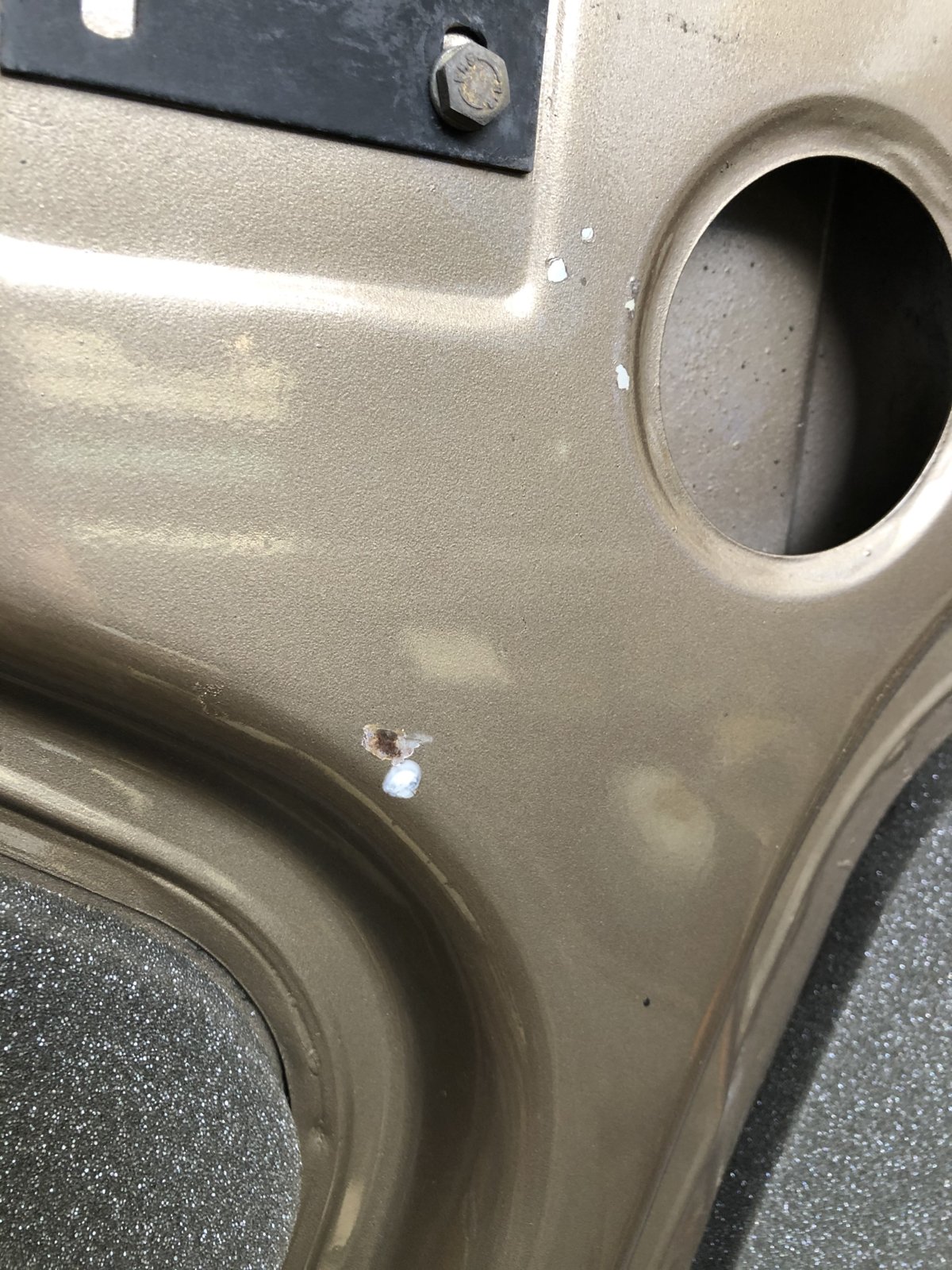

Unintended consequences: Adjusted the hood latches to dial in the panel fit, now the hood contacts the plastic overflow cap and it’s cracking around the base of the neck. (Spot of white poster paint for confirmation).

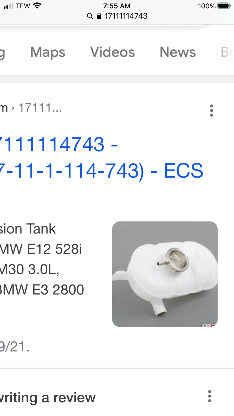

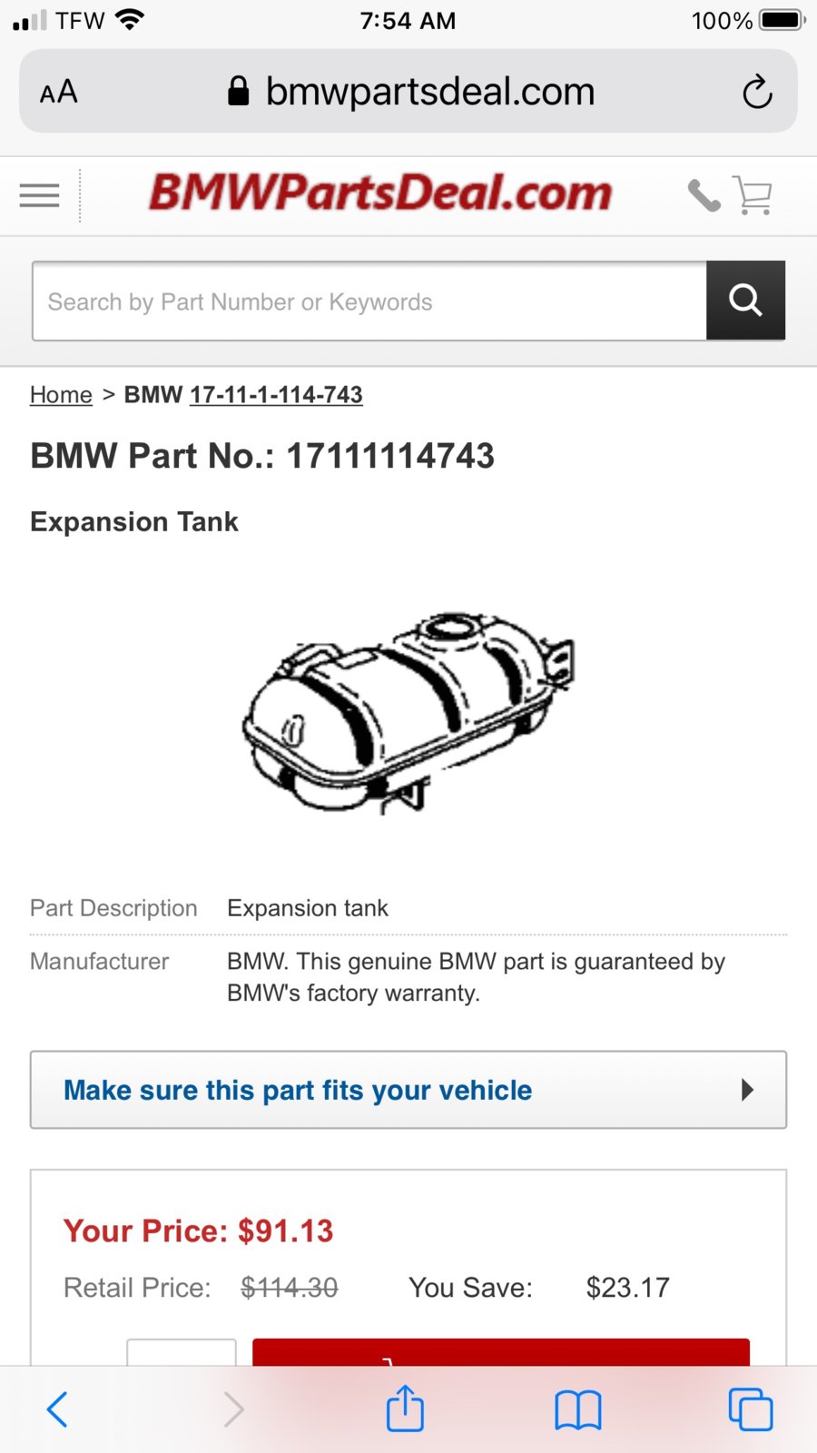

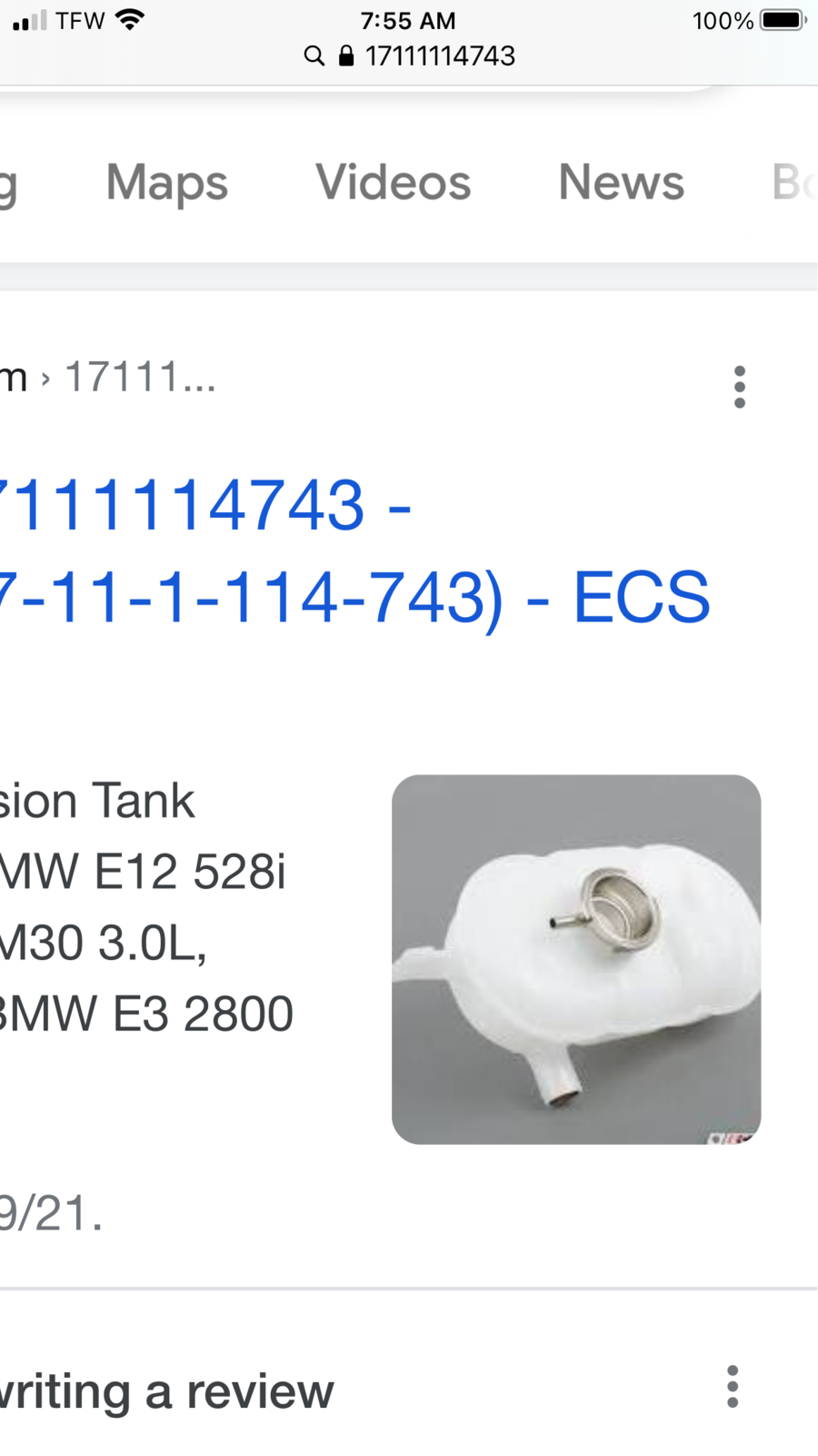

I just bought 2 of the originals now available. The original (‘74 plastic) is at dealer.
17-11-1-114-743
91.00

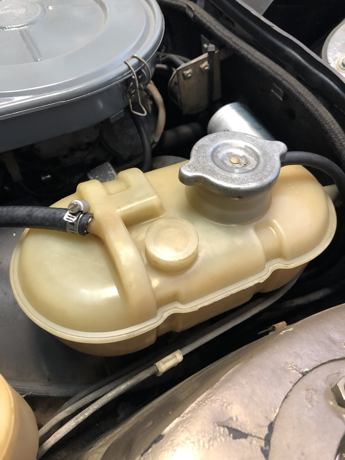

Problem solved, thanks @Mot27cars slightly different style and cap, significantly shorter overall. Took the opportunity to swap in the “correct” style hose to the top of the radiator. Only difference I can see is that it no longer says “fuel line”.
